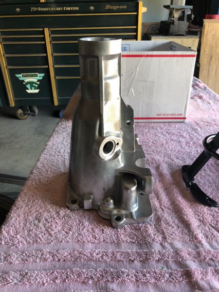

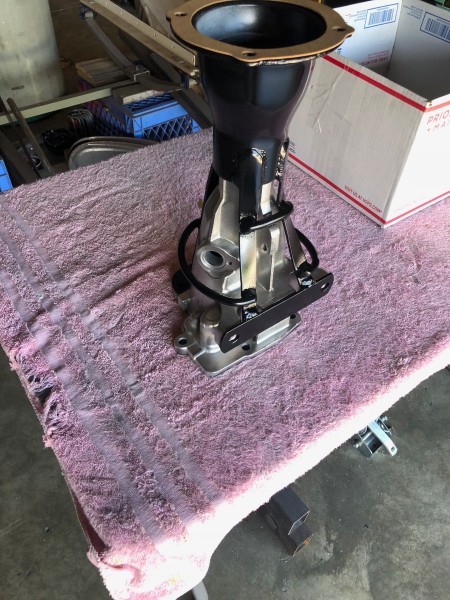

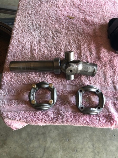

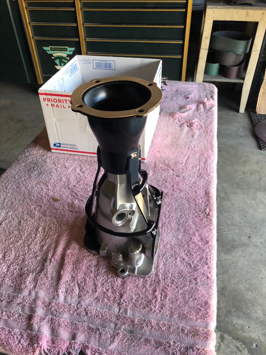

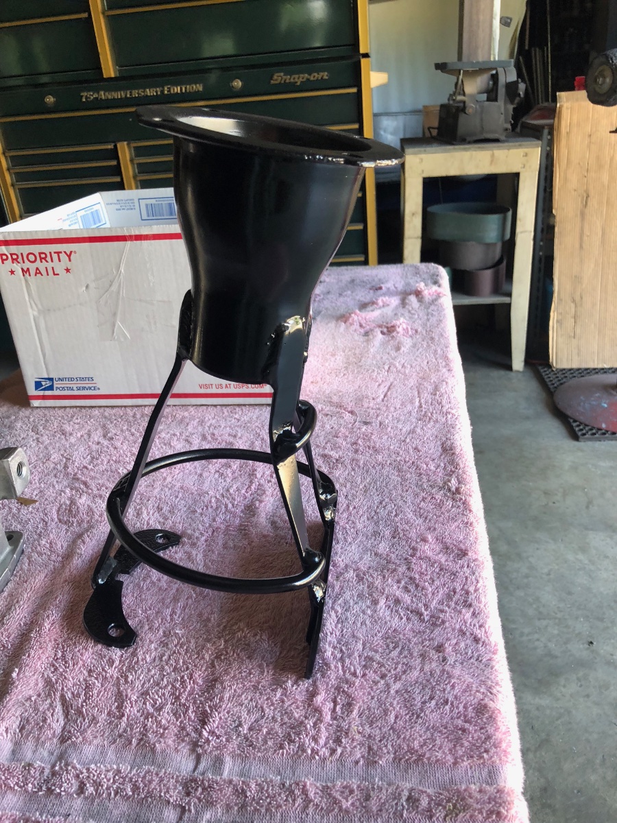

Les Schubert
Posts: 1364
First Name: Les
Last Name: Schubert
Location: Calgary
Re: Best, Easiest standard transmission conversion for 27 T
Post by Les Schubert » Tue Sep 10, 2019 8:49 pm
Nice looking adapter Hank!!
Les Schubert
Posts: 1364
First Name: Les
Last Name: Schubert
Location: Calgary
Post by Les Schubert » Wed Sep 11, 2019 6:49 pm
Maybe this
