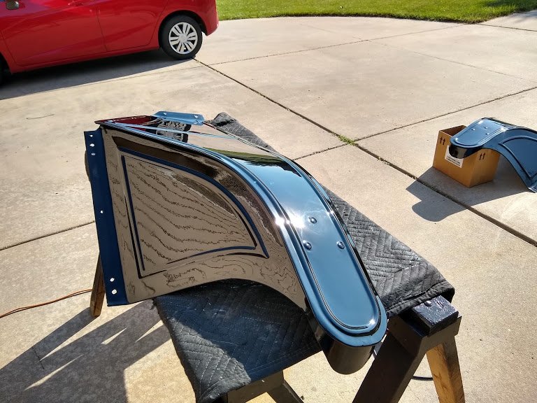

The first time you sand a painted part, you feel like you’ve wrecked it. Even if it wasn’t perfect, it looks worse now. Yet using a polisher will soon bring out the shine. The rubbing compound is used to remove the remaining sanding marks and should bring the part to a dull, mirrored finish. The polishing will turn it into a great shine. It will also show you areas where you missed, so don’t be disappointed if you need to start over in areas with the rubbing compound or even sanding again locally.
Regarding how long it takes, for me it would take about an hour to sand and polish a fender top. I did not mess with the undersides of the fenders. The hardest parts to sand and polish are the hood pieces, with the louvers, rivets and handles. Even trying to be careful, you may still blow through the paint in spots on the rivets. I did. However, I just pulled out my black paint marker and carefully touch up those spots. They work really well for this. The body took about 3 hours to sand and polish.

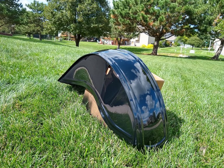

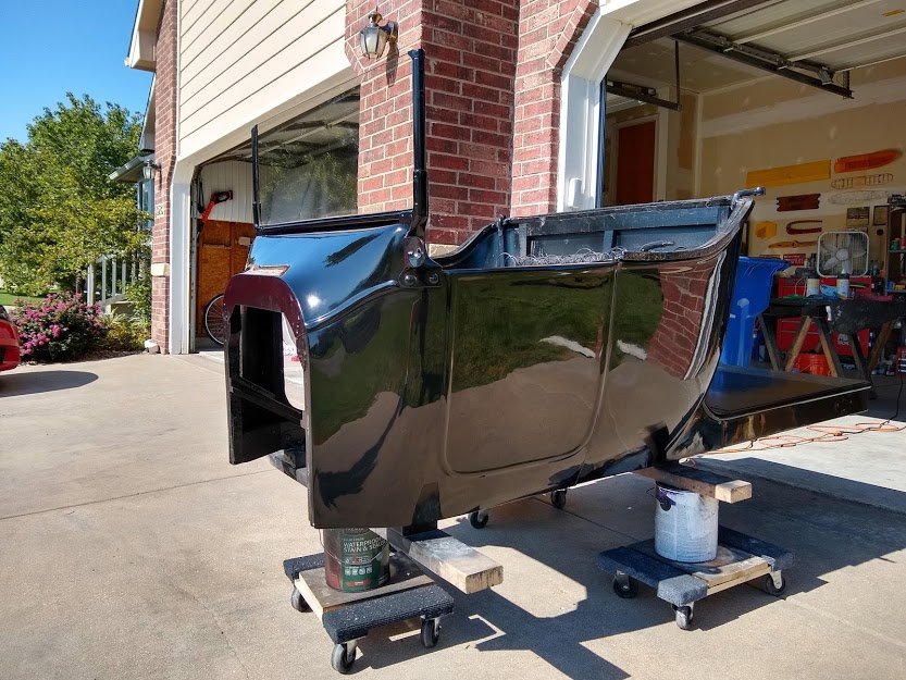

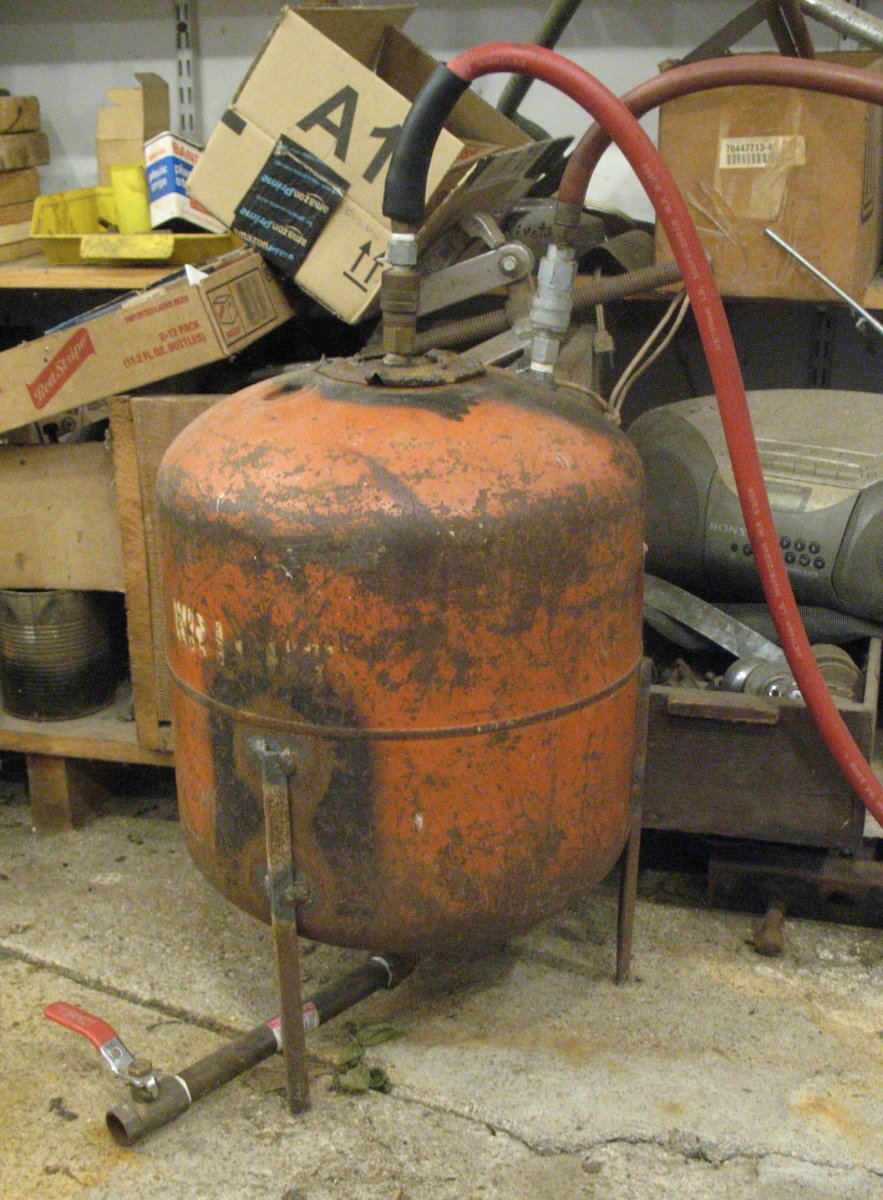

I remove water and oil from my air lines with this tank bought at an auction for $2.
The drain valve and other added parts cost more than the tank.
