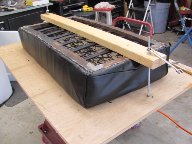

I would use 3/4" plywood for the compressor. It takes a lot of pressure to compress those springs. For the bottom I used two one by fours. I don't know why, but Langs and Snyders both sell Mac's upholstery kits. I would stay away from them. Mike at Classtique does a much better job. I sewed a piece of plastic welt around the skirt of the seat spring upholstery to hold it in place after the channel is compressed. I used wide jaw vise grips for the channel.

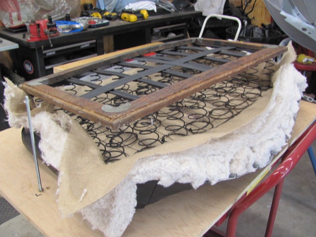

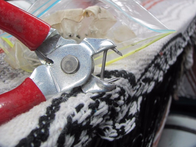

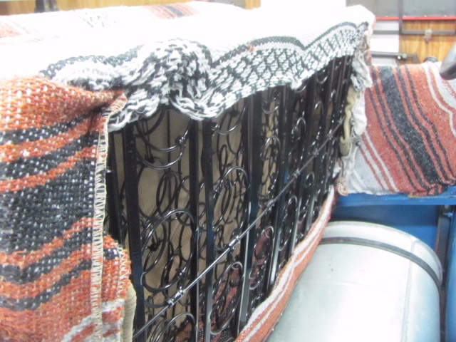

All the covers for the later T's used with me have had the beading in the edge that fits into the channel as Larry mentioned, use a channel lock pliers to fold over and close the channel, stock Ford method.
The channel makes for a very neat appearance and more practical as the spring base sits best in the seat frame with stock method.
Hog rings are modern and weren't used on the Ford, but can be used. In this case I preserved the new spring cushion by using hog rings, as the cover was only a blanket, for simple job. Easy to remove the hog rings and then this new spring base could be done later with correct channel install of the right cover.
The compressor is needed to do this work on seat springs, this one is non-Ford, but operation is the same, layout the cover, place spring over, the compress the spring, and fasten the upholstery covering.

Thanks so much! Those pictures are just what I need. I did speak to Mike at Classtique yesterday about the installation and picking up my seat kit at Hershey. Also spoke with him about how helpful it would be for them to create installation videos shot professionally without an audience so there is a free view to see both the whole scene and close ups as needed.

When I did mine, the plywood compressor I used was about four inches all the way around bigger than the seat spring. I used two 2X4's for the bottom somewhat close to the edges of the spring to distribute the force more evenly.
