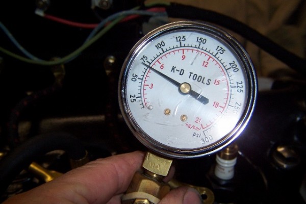

I run a Z-head, but have never taken the numbers, like you are asking for. I can tell
you that my free starts stopped and the old dog scoots up hills like it never did before
though !

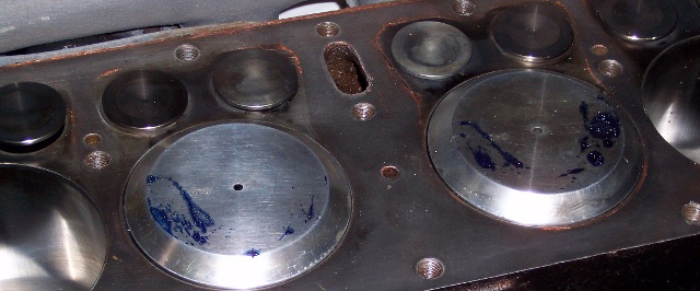

Put a used 'z' head on the '26, changed out from stock iron. When first start, hard knocks!!, shut off right away. But after blueing the combustion chambers, and removing some alum that allowed the pistons to strike, got great performance! Seat of the pants noticeable.
So, for any high compression head, safe way is to mount w/o gasket, and roll the crank around for all the pistons to rise and be sure the head won't rock on the block. Then add gasket and good to go.

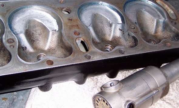

I've been running on a Z head for over 15 years. I had no problem with hitting my aluminum pistons until about the second time I had the head decked (due to warping when it ran low on water due to a gasket leak). I found that if you put the head in place without tightening the head bolts and without a gasket or spark plugs you can spin the crank. Spin it and if it hits you will hear a klunk. Now spin it with your hand on the head, you can feel the strike. You can go to TDC or BDC and use a feeler guage between the head and the block to get a "feel" (pun intended) for how much material to remove.
If I found a strike I would put the bluing on the inside of the head. After spinning the piston striking will show a blue spot on the offending piston and there will be a holiday in the even blue of the head's combustion chamber. I gently reduce the area in the head with a stone, a bur, or an abrasive disk and then repeat the procedure. Keep repeating until it doesn't strike the head anymore, ie. there is no knocking when you spin the crank and you cannot feel the head move. Now when you put in a head gasket you will be ok. I creep up on the problem removing tiny bits at a time. Once you remove the aluminum you are not going to put it back! I doubt you can remove enough to create a leak in the head thereby trashing the head, but each bit you remove will weaken the head. I believe that in a Z head the raised horse-shoe areas are fairly thick and this is where the piston will strike so you should be ok grinding there. At least I have never had a problem doing this adjustment.
You get about the most compression obtainable on your Z head this way. Be aware that if you are extremely close the buildup of carbon can cause a knock. This will require pulling the head off for "de-coking" (cleaning off the built up carbon).
IMHO, TH
IMHO, TH

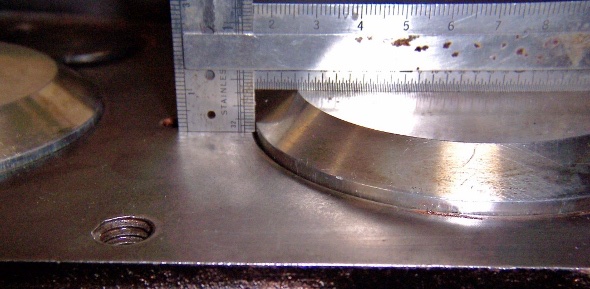

To add what Terry posted, the 'z' head has a thick squish area, and this head is cast alum, so the casting determines the combustion chamber, could be varying depths of the chamber at the squish ledge.
So, you should check before securing the head, by not using a gasket first and check. In my case, the used 'z' head may have been decked, my block was decked and new Egge pistons, stuck up like most do anyway.....but did hit, and I did the grinding away of spots on the squish ledge. No issues from years of running.

other ways to check are; balls of aluminum foil place in several locations on the pistons or modelling clay.

My compression readings on a broken-in engine with aluminum pistons varied from 80 to 75. The dyno showed 25 hp at 1600 rpm
