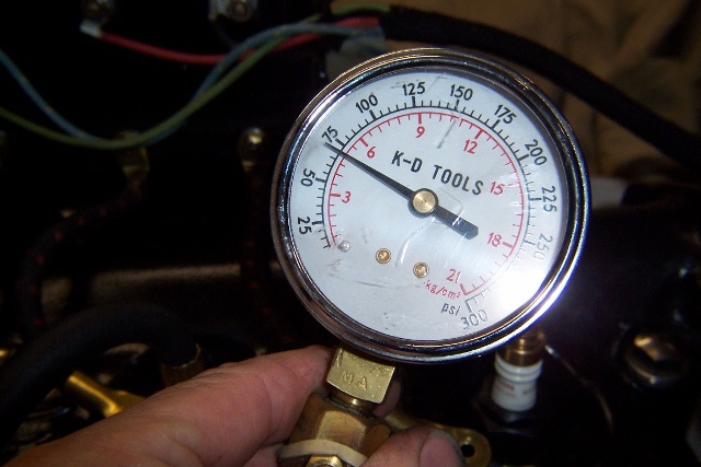

My compression readings on a broken-in engine with aluminum pistons varied from 80 to 75. The dyno showed 25 hp at 1600 rpm

Yes, I had planned on test fitting the head with and without the gasket once we have put the pistons in next week. The suggested 75-80 psi figure was about what I had thought might be achievable and desirable. I know it's not all about raising the compression in the cylinders. The head's combustion chambers and how the flame travels across the piston contribute to better performance, too. I had hoped we'd realize more than a 5 HP gain with this head, however. The head's accompanying instruction sheet claims a 7 HP increase. Does that 2 HP difference rally matter? Probably not when we're talking such low HP figures. 5 HP does represent a 25% increase, but I was hoping for more. We don't expect to end up with a 427 Corvette when all is said and done. We'd just like to feel more confident when taking the car out on the road that we won't be a hinderance to traffic. We were a road hazard before tearing into the engine with an average of 30 psi in the cylinders.
