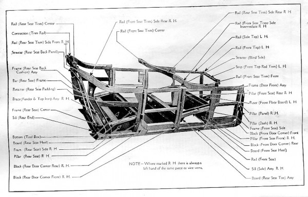

I originally posted this in the 26-27 Roadster Wood topic but have realized that it would probably get more feedback from members if I started a new thread. Dan Treace has responded on that thread already and I thank him for that. Maybe for convenience he will copy it onto this one too?
I am an architect and have been contemplating drawing plans for rewooding our cars. I would not be copying Mel’s plans but would be compiling information from forum members as necessary. I have rewooded a 24 Touring but no other cars. I also own a 25 Roadster that has no upholstery in place but it’s not original wood. I would do it for the challenge and the love of the hobby so they would be free to all those that need them and would be in pdf so no shipping cost. However, I in no way wish to undermine Mel’s estate. Can anyone confirm for 100% certainty that his plans are no longer available? I would also like to hear from others about their concerns about me doing this.
To respond to Dan - the plans would be such that anyone can print them out at any scale they like including full size. The only thing that limits printing these days is the width of the roll of paper. I definitely agree that developing plans would take much work. Most of which would be researching the correct angles, dimensions, curves, etc. I would need the assistance of this forum members to measure their original wood and/or loan me any pieces that they have.
I would start with the 21-25 Touring and move on from there. However, I would develop the plans in such a way that a particular piece could be released before the entire set of plans for that particular car has been completed. The order would be based off of what information I receive from you as well as your opinions on what pieces need to be replaced the most.
Feedback would be greatly appreciated
Thomas

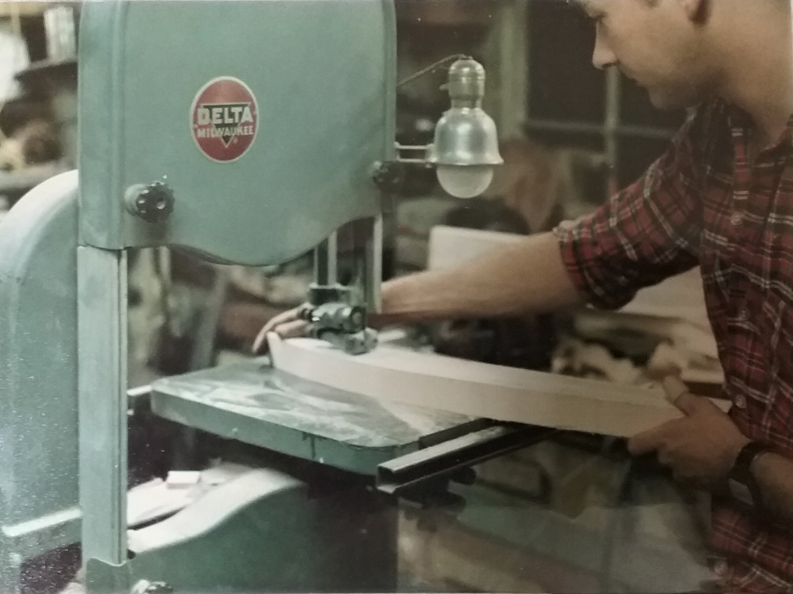

I posted on the other thread about having purchased a set of Roadster plans from Mel Miller years ago for the 1919 Roadster that I finally restored. If I remember they were for 14-22 bodies and in the plans there were notes about the minor variations in these bodies that you could refer to when you were building the body wood structure for a paticular car. I may be not entirely correct about the year dates but they were somewhere in that range for the low style bodies.
I made a few pieces from the plans and after going to a swap meet I heard about Fordwood and purchased the rest of the wood from them. This was more than 30 years ago and things probably have changed since then.

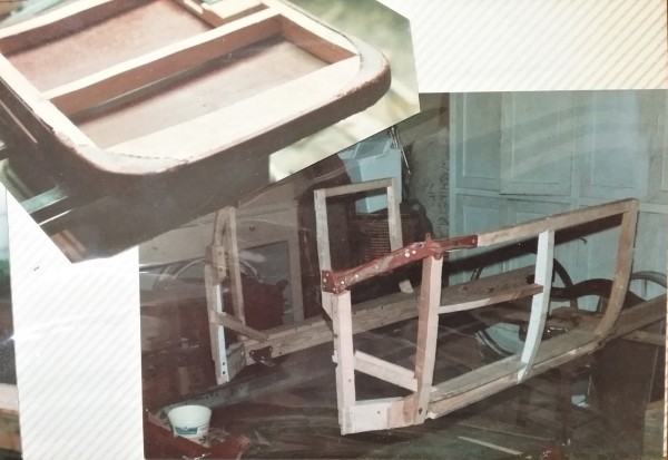

I bought a set of wood plans from Mel Miller when I rebuilt the 1917 Touring in the late 1980’s. It was quite successful though I did end up with pile of sawdust about 12” high. So they were NOT drop in. Later I contacted Mel to see if wanted to sell his business and received a not interested reply. A couple of decades later Leon was selling plans which he told me he copied from actual T bodies. Of course Leon has now passed, so who knows what will happen next.
The major problems I found with the plans is that they were two dimensional while the required wood is three dimensional. Many pieces, especially the vertical, have twists in them and are tough to replicate. After wasting some good expensive wood, I made trial pieces out of cheap 2x4’s. I never did get the shape of the rear doors correct
I kept the plans for years but the blue prints faded and became unreadable. I also kept the trial pieces but the whole went to the dump late last year
So I can offer little, except encouragement.
