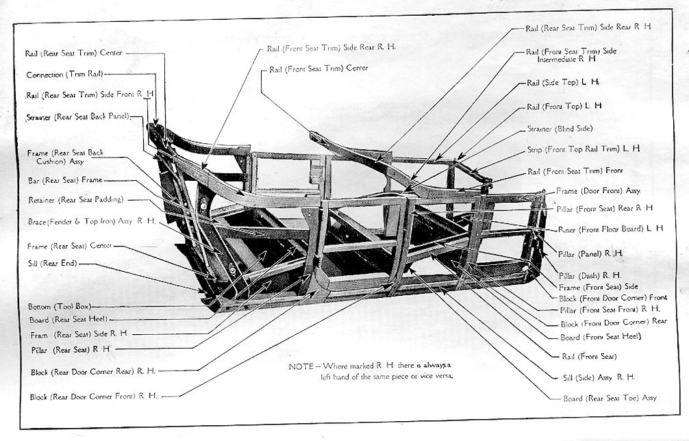

Post by Steve Jelf » Sat Oct 19, 2019 3:49 pm
I expect the Ford body books would be helpful on a project like this. A large part of the work would be researching measurements.

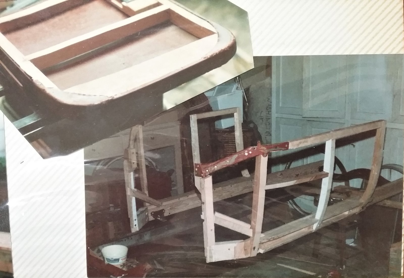

Back in the 1970's I re-wooded my 1919 touring with plans I bought from Mel Miller. I remember back then I had to sign a statement saying that the plans were for my use only and that I would not copy them.

Years later, Mel was advertising in the Vintage Ford for plans, and not responding or following through. People were complaining to Jay Klehfoth at MTFCA about them NOT receiving plans. I approached Mel about his plans, maybe having the MTFCA sell and distribute them with a cut to him, or selling out completely and transferring his Copyright. Unfortunately by then he was no longer of sound mind. Years later his daughter, Jennifer, was selling them. I was in contact with her once after Mel was gone and she said that she was going to sell them and carry on the Miller legacy. I think she did for a while, then seemed to follow in her father's footsteps.
Knowing that those plans were getting scarce, I would pick up a set of his plans if I found them at a swap meet, or wherever I found them. I believe he made plans for 1915-1922 touring and runabout, 1923-1925 touring and runabout, and 1914 "conversion" plans. He never did any plans for closed cars.
I don't know what sort of legal details Leon tended to as to not violate the Copyright laws.
I tried twice to get the rights to reproduce and sell his plans. Twice I failed. At this point I will not try again, but Thomas if you wanted to try, please contact Jennifer Miller. I'm sure you could Google some contact information for her, otherwise, contact me for an old e-mail address I have. If you are able to get the rights to the Mel miller plans, I will contribute all I have.
