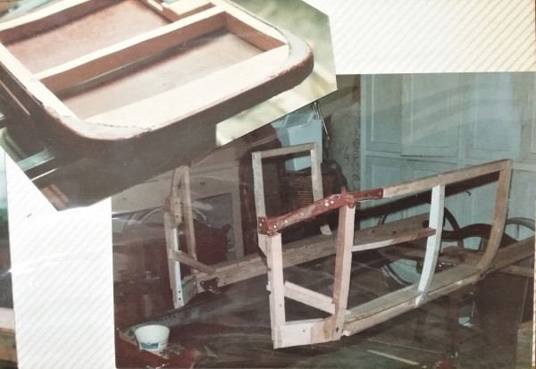

I posted on the other thread about having purchased a set of Roadster plans from Mel Miller years ago for the 1919 Roadster that I finally restored. If I remember they were for 14-22 bodies and in the plans there were notes about the minor variations in these bodies that you could refer to when you were building the body wood structure for a paticular car. I may be not entirely correct about the year dates but they were somewhere in that range for the low style bodies.
I made a few pieces from the plans and after going to a swap meet I heard about Fordwood and purchased the rest of the wood from them. This was more than 30 years ago and things probably have changed since then.

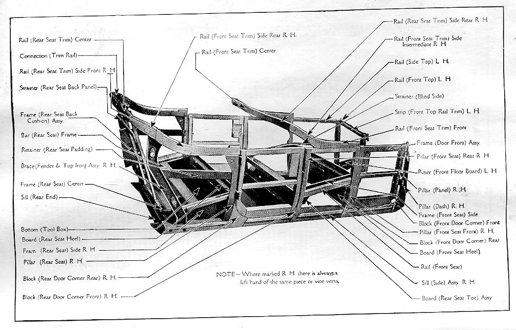

I expect the Ford body books would be helpful on a project like this. A large part of the work would be researching measurements.
