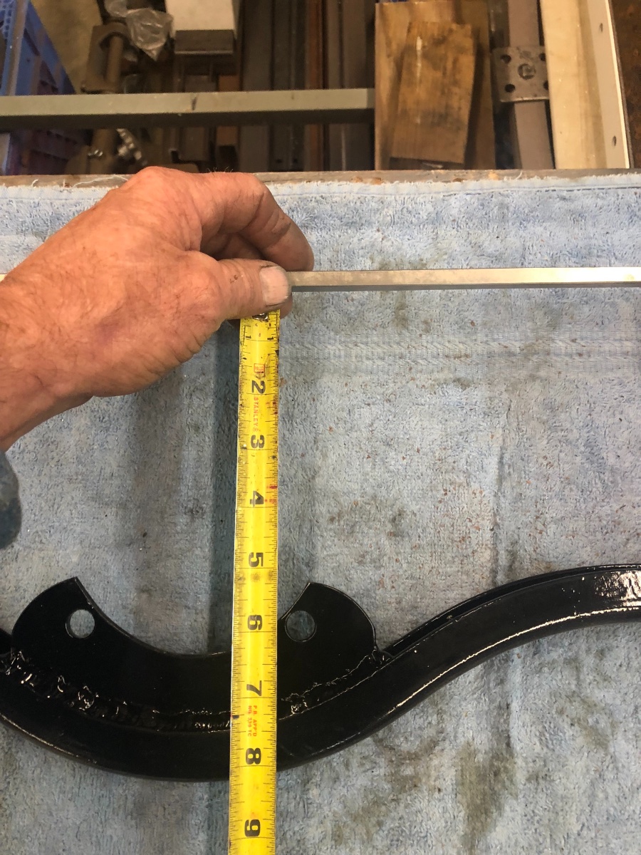

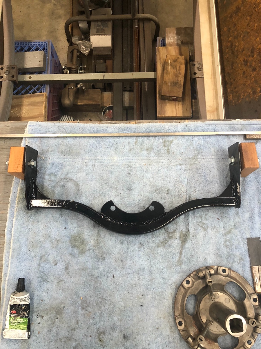

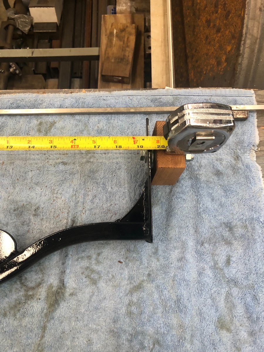

Here you folks go on a simple but functional rear mounting bracket.
Building a Simple Warford Rear Mount

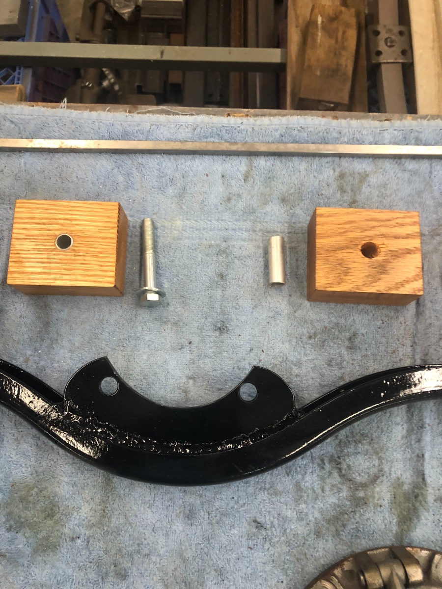

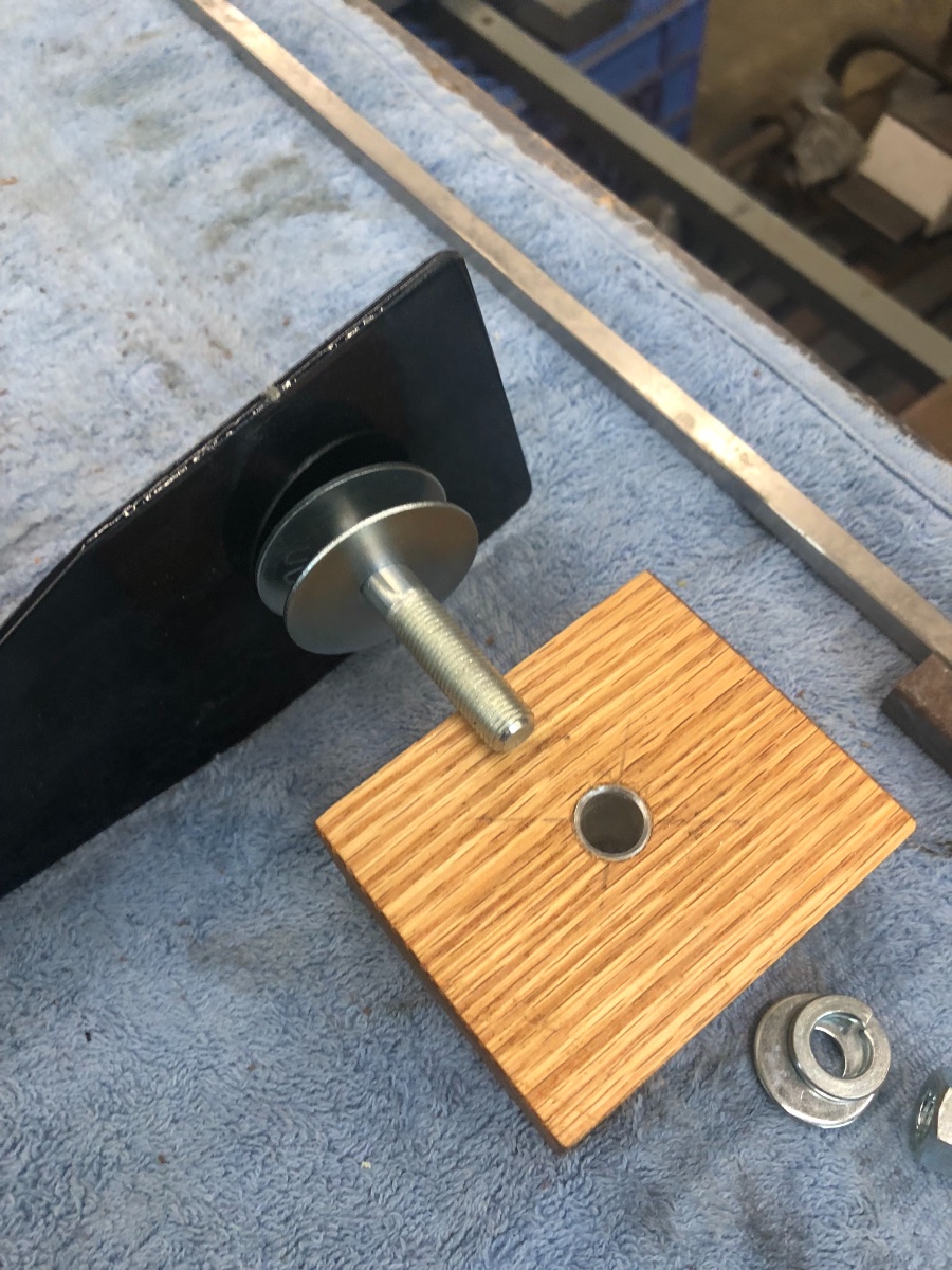

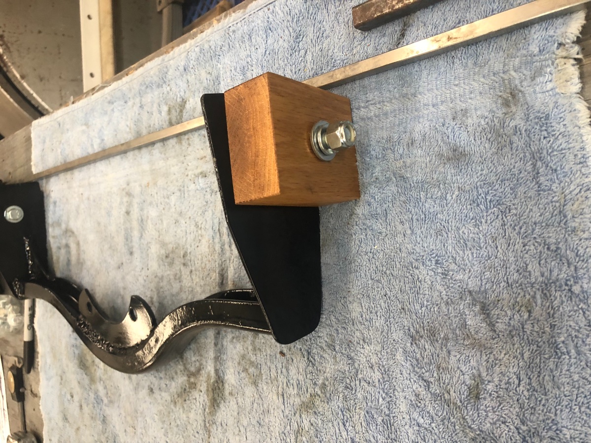

By attaching at the rear ball mount, gives you some nice clearances. When attaching to the frame, and using a little grease between the the wood and fender washers, tightening up then backing off the ny-loc washers, you have moment when the frame needs to flex. I like using a metal insert in my wood for longevity.
