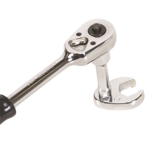

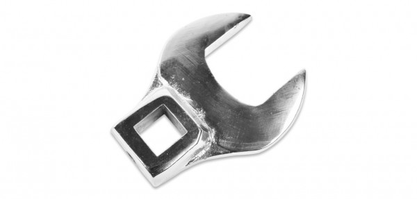

Glad you got the motor loose, here are crows feet and how they work, you do not have to recalibrate your torque wrench when using them, the difference is negligeble for the sizes used in cars.
Happy wrenching !

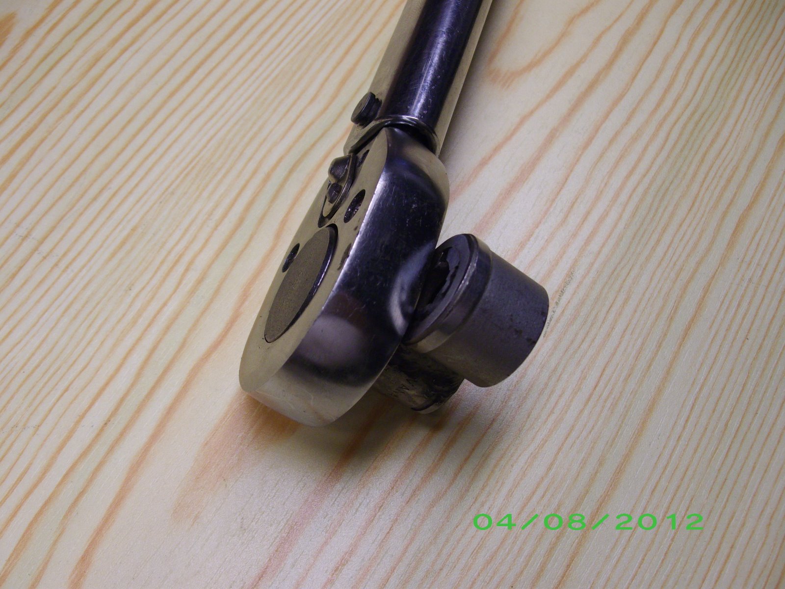

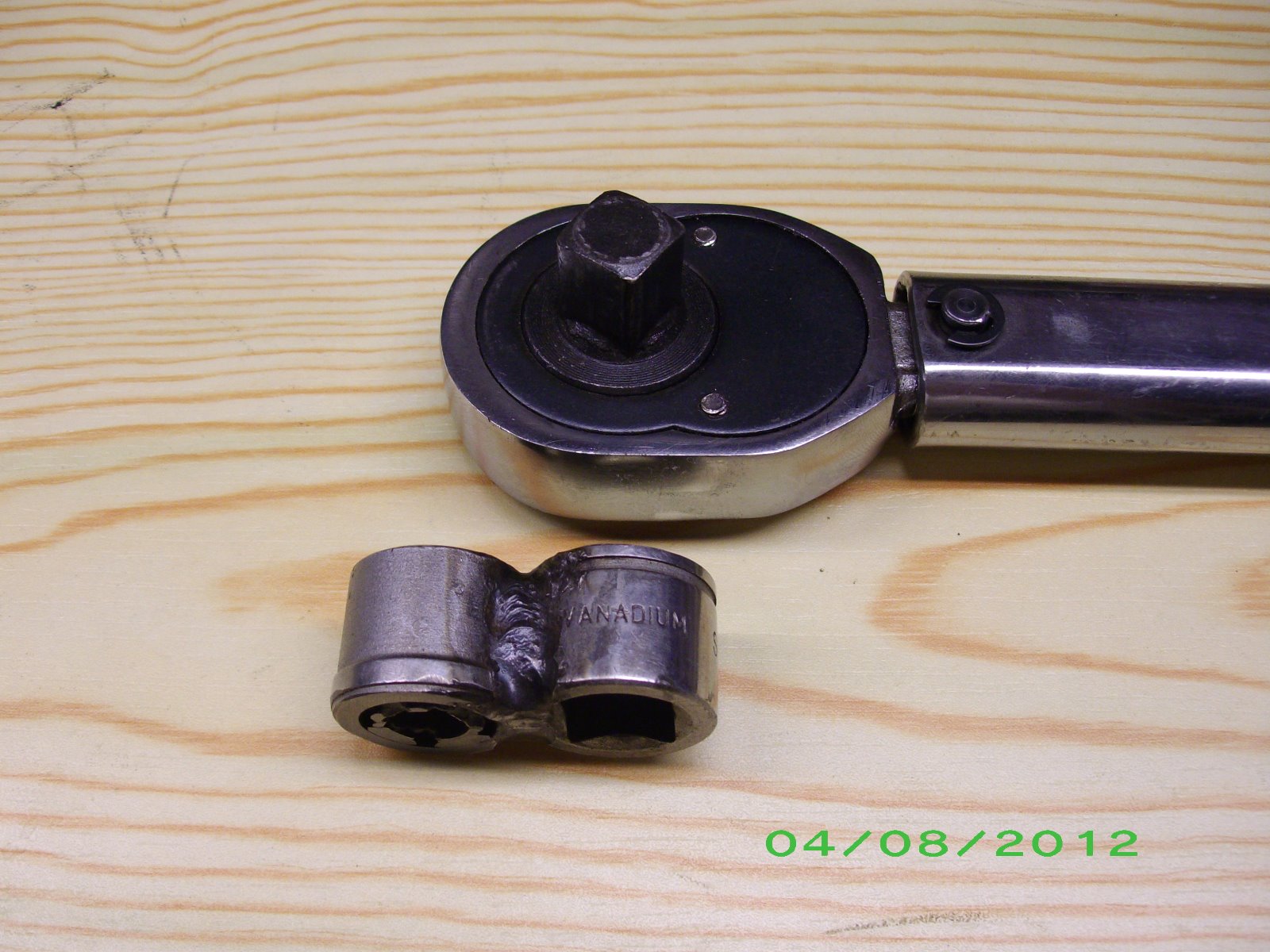

I cut a socket in the middle and weld them together .
When you set that side ways , then the [force ] is the same .

The car is a 22 touring with an Australian built body with very little space to access the rear three head bolts beneath the wooden fire wall. The crows foot wrench had no hope of reaching two of these bolts.
I couldn't even torque these bolts from the cabin side due to the location of the coil box.
So I used a ring spanner and just guessed when it was 45 foot pounds or better.
Ah, the trials and tribulations of a Model T!
Charlie B in N.J.
