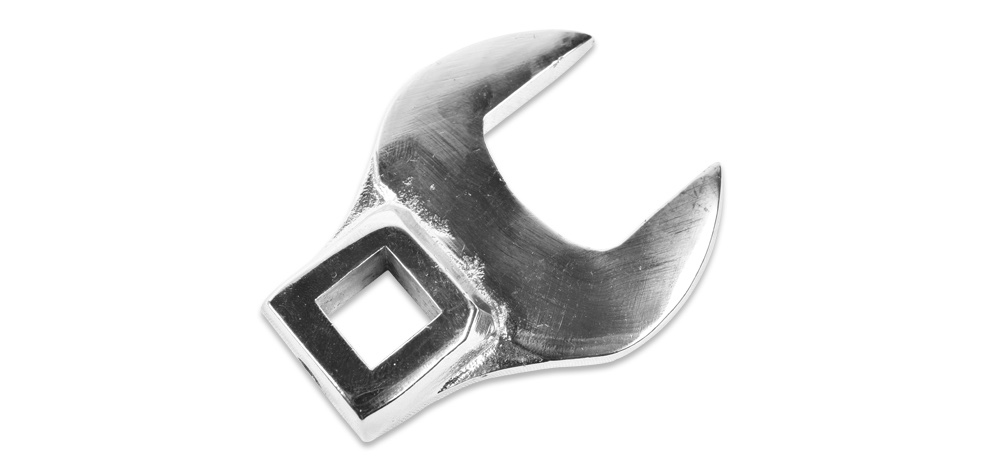

What is a "crows foot" that reaches to rear bolt heads for correct torquing? Is it available in Australia?

Will all "Crows Foot" wrenches reach the rear head bolts?
What adjustments do I need to make to the torque wrench setting to account for the greater wrench radius?

Glad you got the motor loose, here are crows feet and how they work, you do not have to recalibrate your torque wrench when using them, the difference is negligeble for the sizes used in cars.

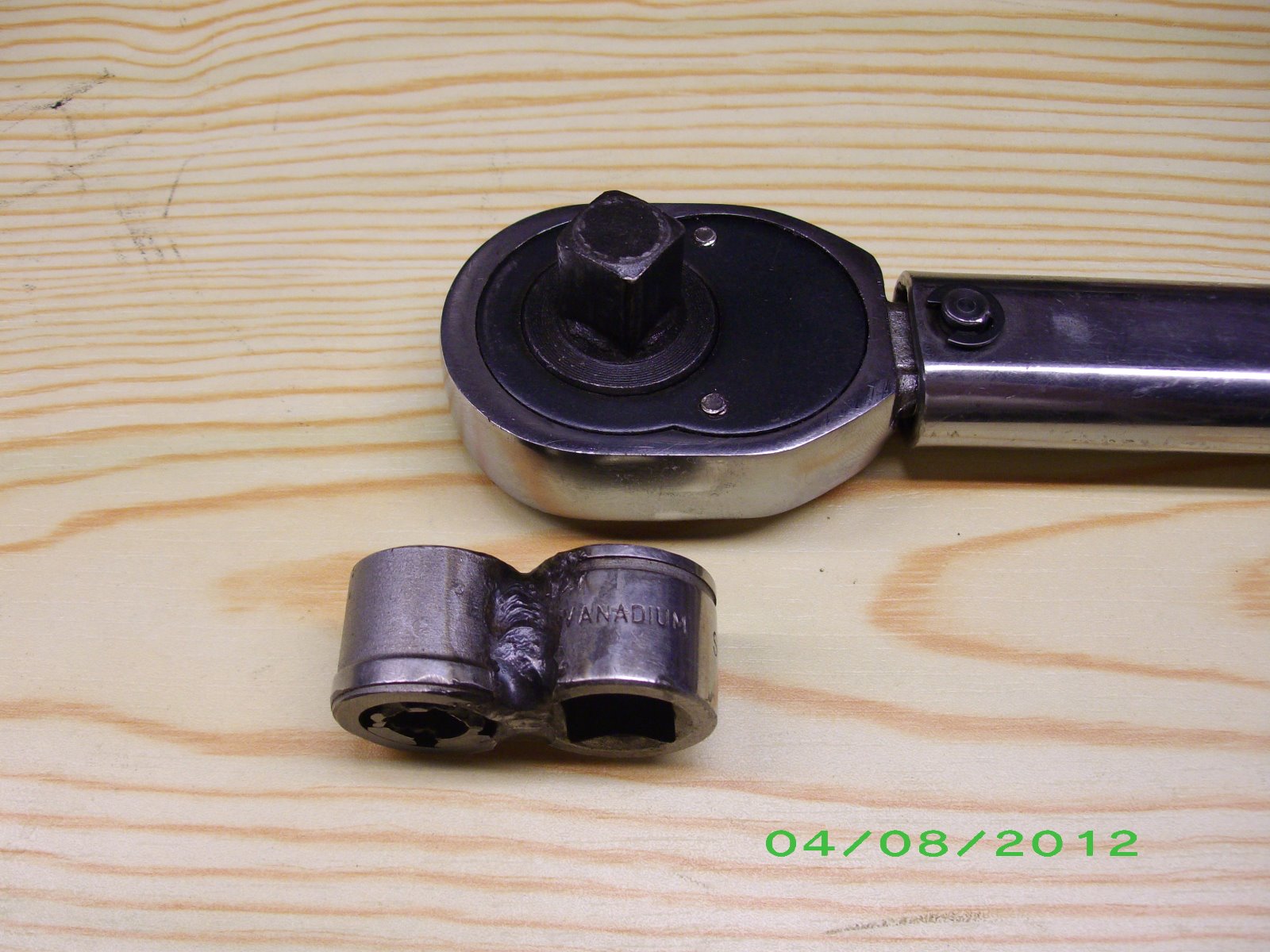

I cut a socket in the middle and weld them together .
When you set that side ways , then the [force ] is the same .

Thank you all for your advice on crows foot wrenches.
My experinece in this area was not good.
I brought the only set that was availablw to me locally in Australia and it was metric.
The crows foot set contained 15mm and 17mm but what I needed for head bolts was 16mm. (closest to 5/8 inch)
The car is a 22 touring with an Australian built body with very little space to access the rear three head bolts beneath the wooden fire wall. The crows foot wrench had no hope of reaching two of these bolts.
I couldn't even torque these bolts from the cabin side due to the location of the coil box.
So I used a ring spanner and just guessed when it was 45 foot pounds or better.
