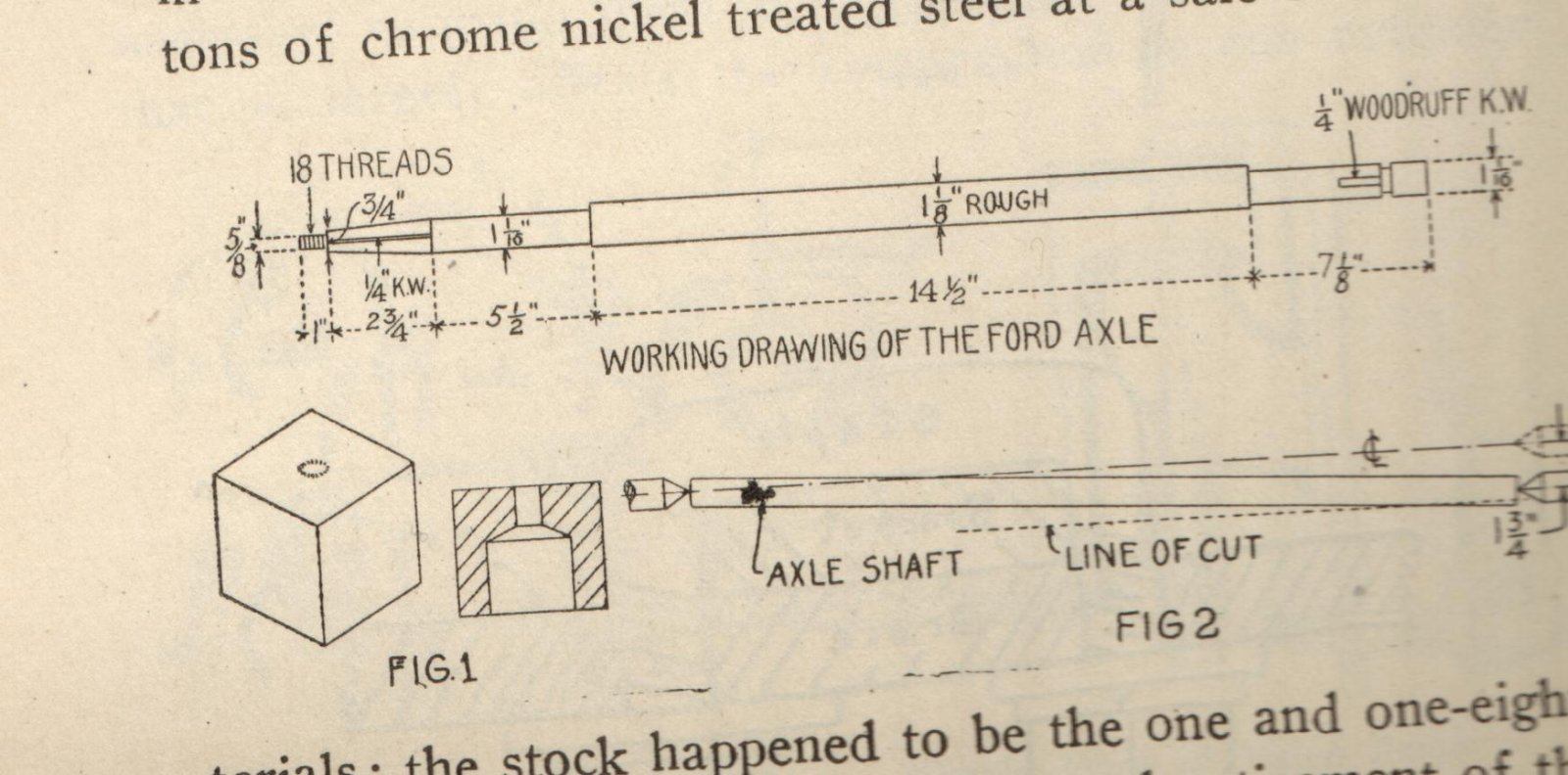

Hey all, I'm after a cad file or someone that has sketched up a detailed drawing for the rear drive axles. The only thing I have close to either is the image i've attached which I found on here.

Thanks Steve unfortunately I'm after dimensions ect. But those drawings sure are cool!

That drawing you have is pretty basic, and obviously lacks much needed tolerances. An interesting method of defining the taper across the entire length of the axle too... IIRC, it’s 3/4” per foot with centerline taper, can’t help you with gauge diameter, but know you need to keep pretty tight tolerance on the taper to maintain overall axle length

Just use the Ford Service book. You don't need drawings.

Here is a link with an additional picture for cutting the key way
