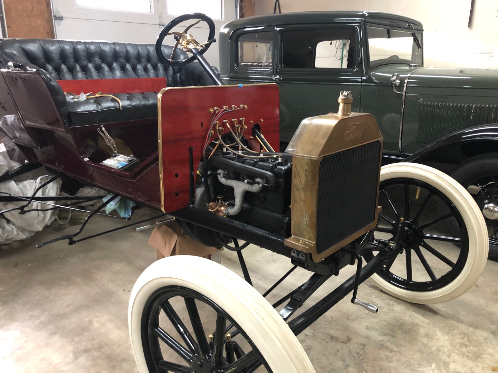

I trial fitted my radiator on my 1911 that has the engine and front spring already installed and of course the front cross member has spread and the outside of the frame is 23 1/4 so the radiator will not fit down over the frame and the radiator mounting holes are also too far apart. I have read the posts about straightening the front cross member with a chain and bottle jack to bring the frame back to 23" at the outer sides and the radiator mounting holes 21.5 inches center to center. Can this be done with the engine and front spring already installed? Thanks again for any advice, Art

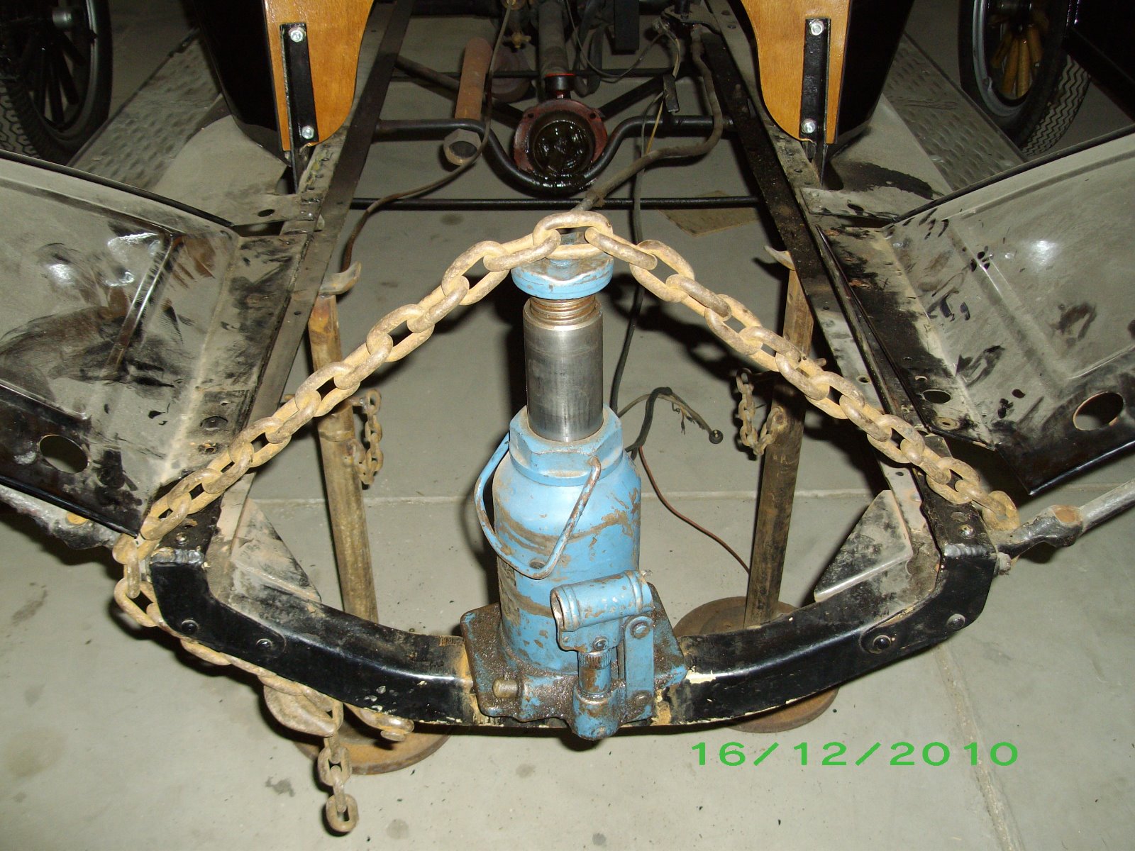

Art ; I did it without the engine and Spring , but I think you can do it with the Engine and Spring .

Only a quarter inch spread isn't much, and some people would do a little finagle and run with it. However, that is a bad idea. While a quarter inch isn't much, it throws the geometry off between everything from the firewall forward. Everything would be off a bit, the hood, the steering, the general stance of the whole car. So fixing it right is the right way to go.
I have straightened several such frames. Usually, it is easier to do than one might think.
However.
Steel stretches much more easily than it compresses. If a frame is not badly distorted, a simple jacking like Anthonie B shows can do the job just fine! A couple that I have straightened, were much worse than that, One I straightened had spread nearly a full inch. Heating a frame for straightening purposes is certainly controversial. Many offer good reasons why it should not be done. I tend to believe that there is a point of judgement call when heat is needed because the metal has stretched enough, that only shrinking it can result in a best repair. The really bad one I did, I carefully mapped (using a nice straight original as a guide). I determined where the stretched area of the front cross-member was, and rigged a chain binder I have to pull the stretched area back. I then heated the stretched area, leaving the open edges of the channel still cold to give a solid base to return to. Then pulled the chain binder tight, measured, and allowed to cool. When I removed the chain binder, and measured again, I found it so close to perfect (some of that was luck), no further adjustment was needed. I then reheated to a dull red the entire area and cooled it slowly to re-anneal the area.
Yours isn't that bad. A simple pull with a big chain binder or more likely a bottle jack and heavy chain, should work just fine. Although I haven't actually done it that way, doing so with the engine and spring in place shouldn't be a problem. I have seen others that did do it that way.

The hydraulic jack will allow much more precise control of the work than a binder/
boomer, and can easily be backed off to check movement, and restarted, over and
over again, until the desired results are attained.
