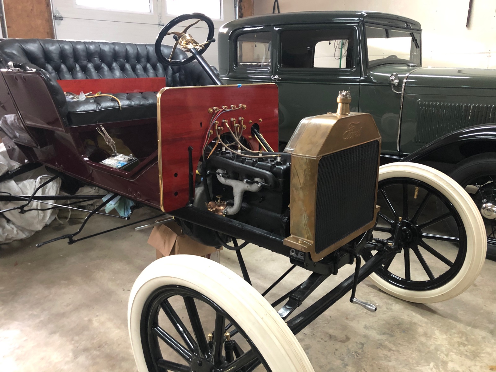

I trial fitted my radiator on my 1911 that has the engine and front spring already installed and of course the front cross member has spread and the outside of the frame is 23 1/4 so the radiator will not fit down over the frame and the radiator mounting holes are also too far apart. I have read the posts about straightening the front cross member with a chain and bottle jack to bring the frame back to 23" at the outer sides and the radiator mounting holes 21.5 inches center to center. Can this be done with the engine and front spring already installed? Thanks again for any advice, Art

I believe radiator off and front spring out is all the removal you need. I would cut a wood block to fit over the front bearing and support the jack. The radiator mounting holes should be 21½" on center.

I have dealt with this easily before with two pieces of 3/8" fine thread all thread, put across between the top pair of front fender bolt holes. Tighten, loosen and keep checking dimensions. You don't have to remove the front spring either.

Today I used Jeff’s 3/8 “ threaded rod method and after six or seven times tightening and loosening it was perfect. Thanks for the replies. Art
