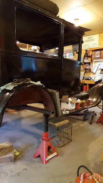

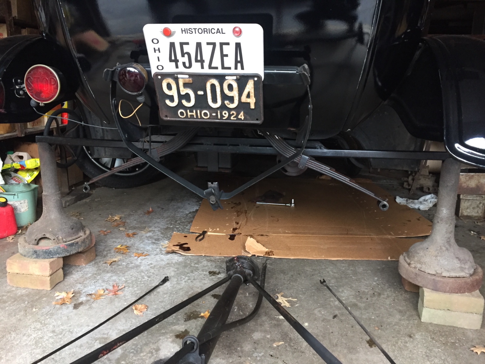

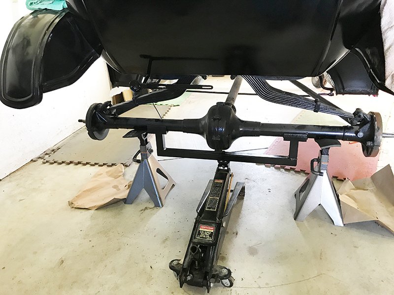

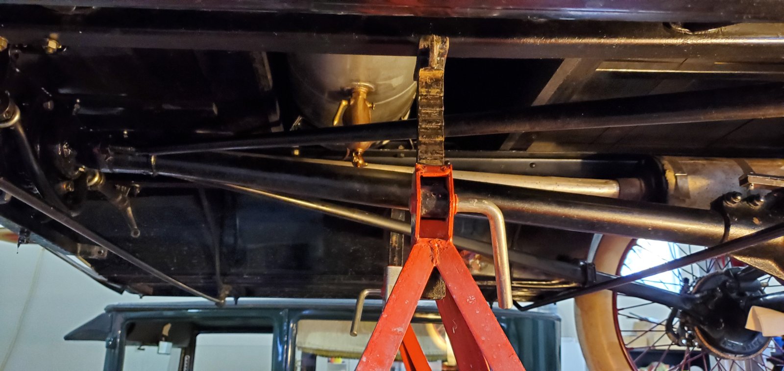

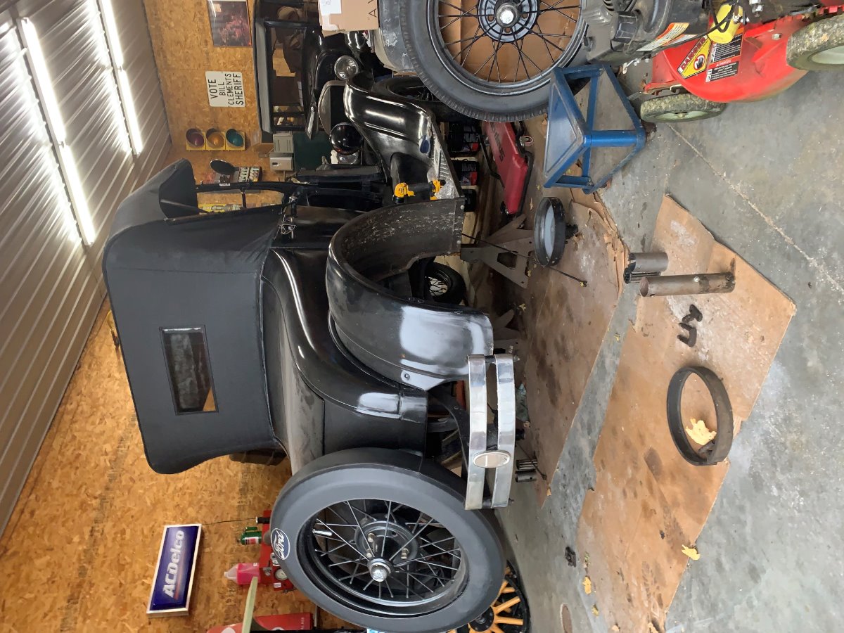

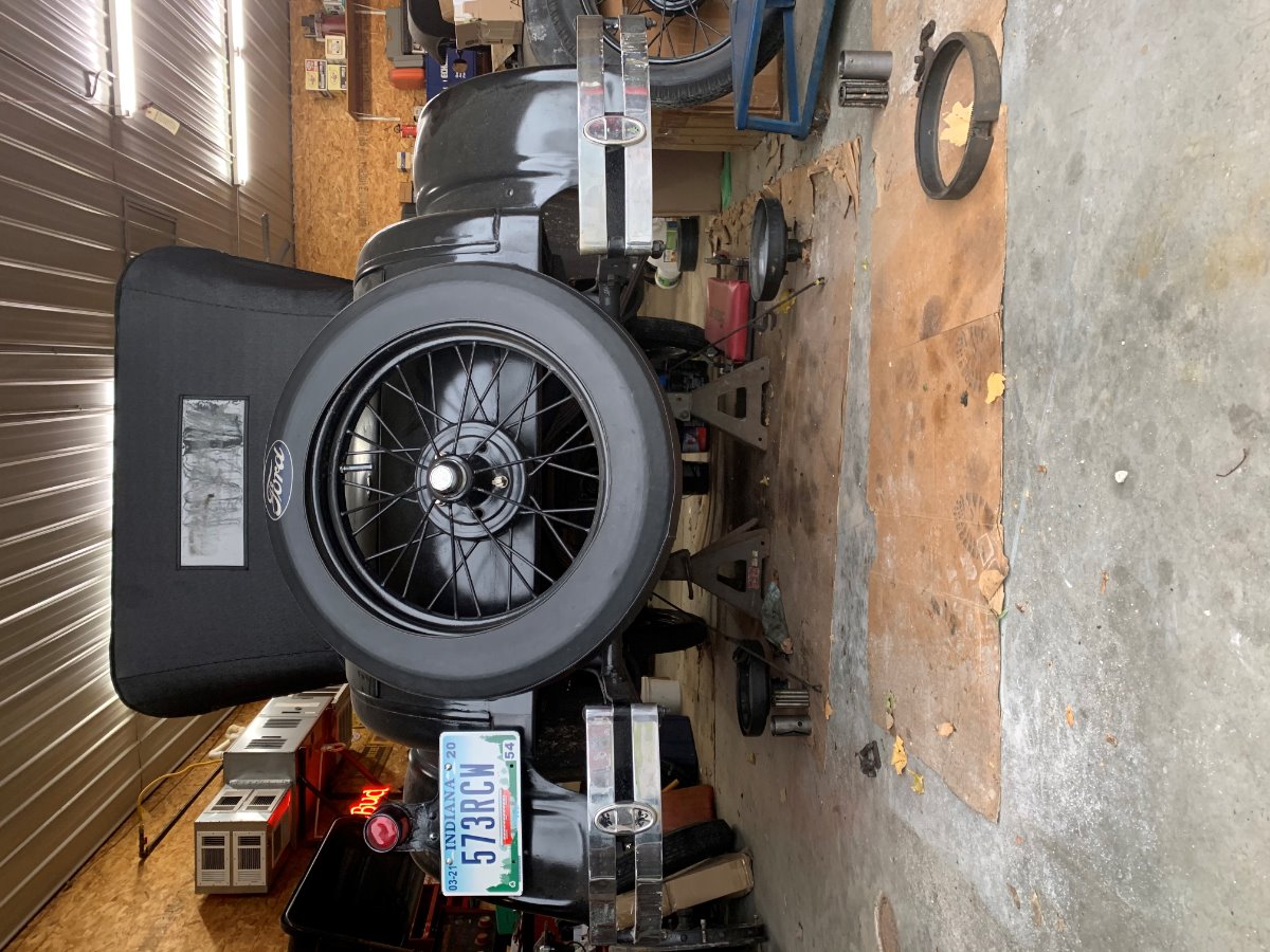

I'm removing the rear axle assembly to do some repairs on my Coupelet.
Does this look OK for balance?
The jack stands are just behind the door and just behind the gas tank.
They have to be outboard of the radius rods, this is as far back as I can get.

You can get them further back by first removing the radius rods and then proceeding. Apart from that, you really ought to use a stand with a larger footprint.

Looks a little teeter-tottery, but probably OK. it will get better once the rear axle is out.
When I removed the rear axle in Betsy to install her Ruckstell, I made a cross bar that spanned the rear frame rails and supported the car with it. If you decide to make a cross bar, make it beefier than mine, mine worked OK but was a bit saggy.

I remove my rear axle assemblies complete and place the jack stands right up tight to the radius rods BUT I do use the stands for my F-250 !

As long as the cat doesn’t jump on the back, you should be ok
I have mine about like Mark shows, borrowed the bar from a friend. Had the custom stands and elevation devices.

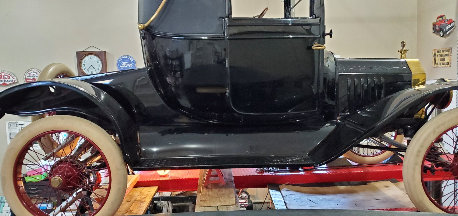

Jack stands too small
Not located far enough back, they can go back further, and should.
And now I see it's on a 2x8 spanning lift rails and on a lift!
Not a chance in hell that would be allowed on my property. Rethink this.

Thanks guys. I will look at removing the radius rods & move the stands back.

When I removed my rear end, I put the stands exactly where your's are. Didn't like it, no sir, not one bit. Long story short, I put a couple of safety stands at the junctions of the running boards, right where they meet the rear fenders. That's not a very strong point, but I rationalized that I was just trying to prevent tipping, while the main supports were beneath the frame proper.
As far as removing the radius rods before removing the axle/driveshaft, you might be able do that but you still need to have the radius rods fitted up to the axle and adjusted when you reinstall the whole assembly. Two reasons: (1) The driveshaft needs to be squared up perpendicular to the rear axle on assembly, and (2) On some cars the radius rods can't be installed once the axle is bolted up to the driveshaft.

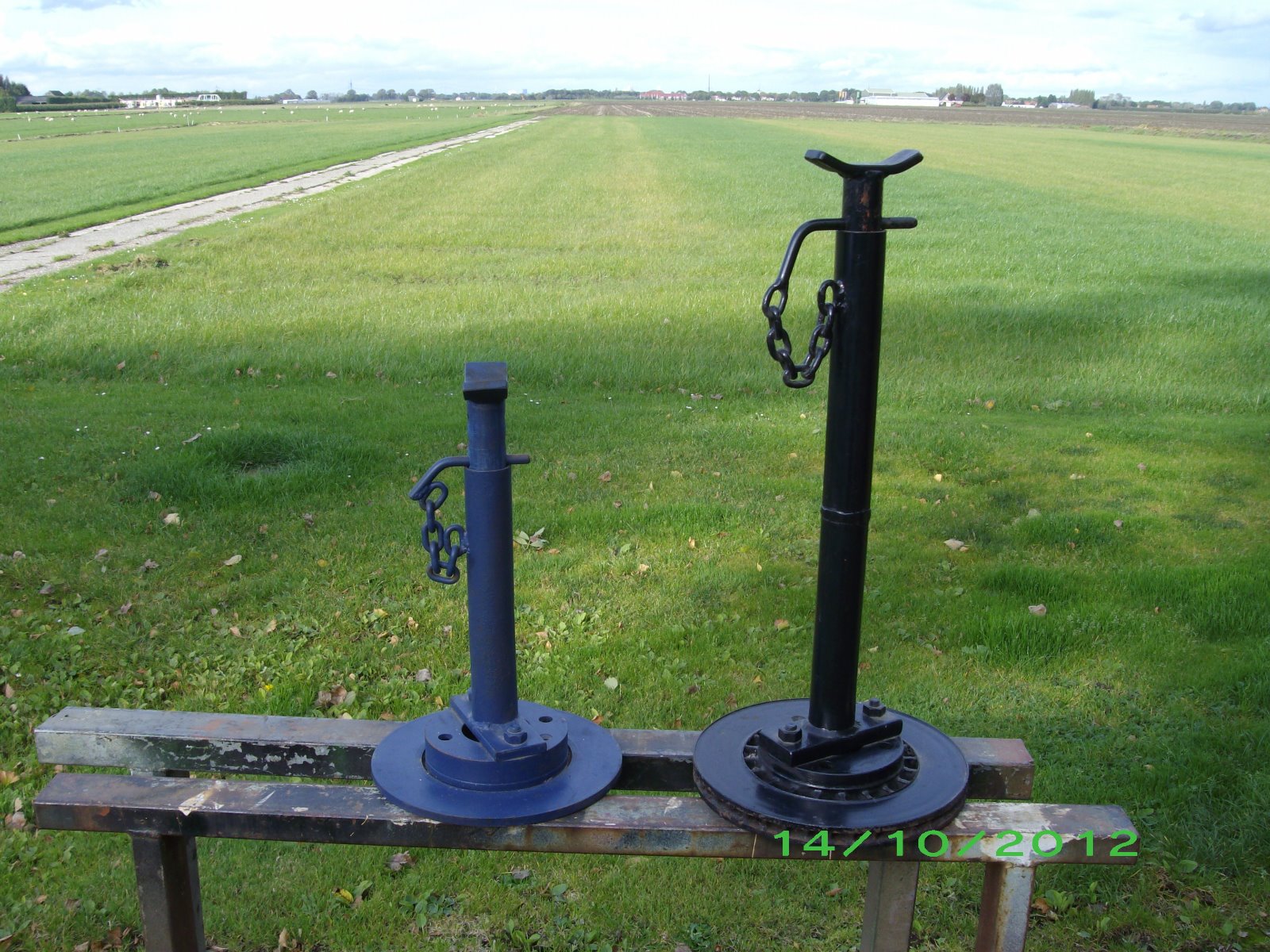

Get some beefier stands and use a cross bar - worked for me. I rigged up a double support for my jack - lifted the rear end - backed up the jack with Jackstands while I removed the wheels - then used the jack to lift it high enough to get the rear end off and supported it with a piece of square steel tubing across the frame with hefty jackstands on either end. I was able to slide the steel tube between the frame and the radius rods so the rear end came off pretty easy. It ended up sitting that way for 6 months without issue.

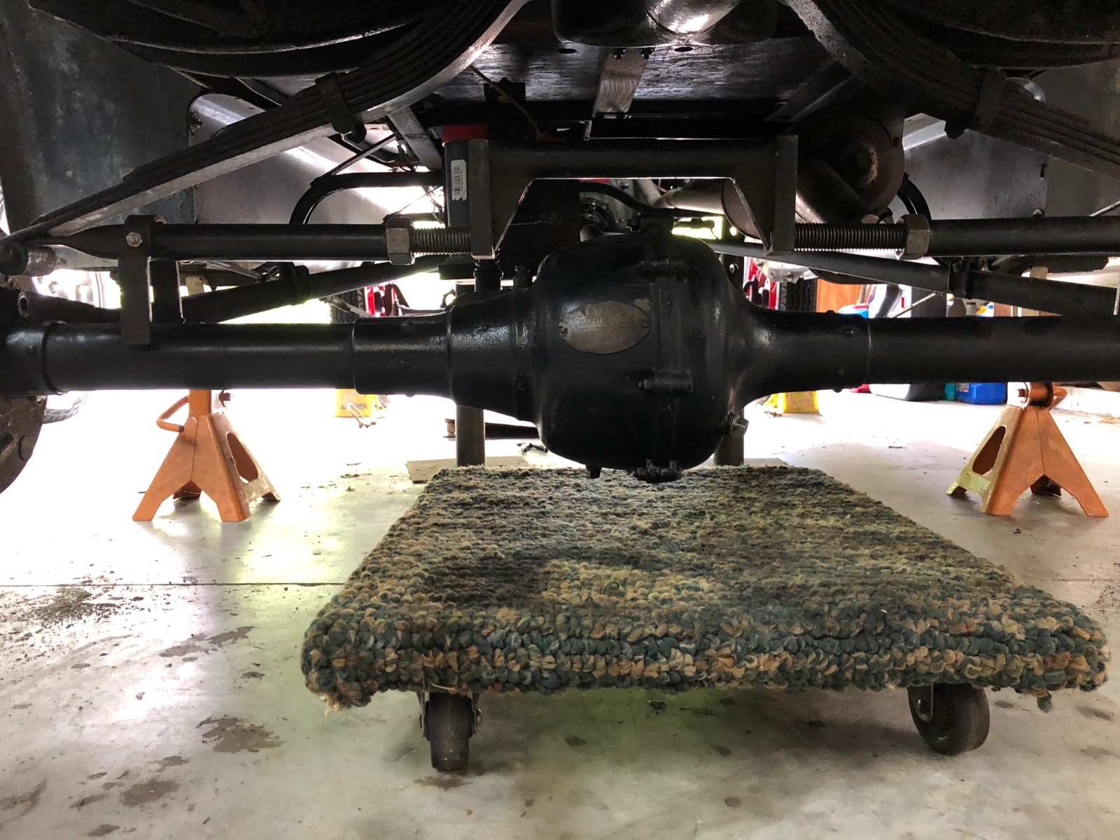

I just did the rear end in my 26 roadster. I placed the jack stands as far back as I could to clear the radius arms. It worked fine.

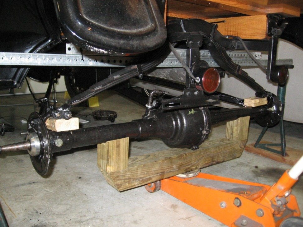

If you jack up the rear end and remove the wheels you can put a piece of heavy wall steel rectangular tubing under the frame and over the wishbones and support it on good jack stands.

The key is to use a cross piece of hardwood which just fits up to the frame without hitting the splash panels. I use a 3 x 2" Jarrah beam. This allows you to move the stands much further back and wider apart, altogether a much safer situation. Then there is no need to remove the radius rods.

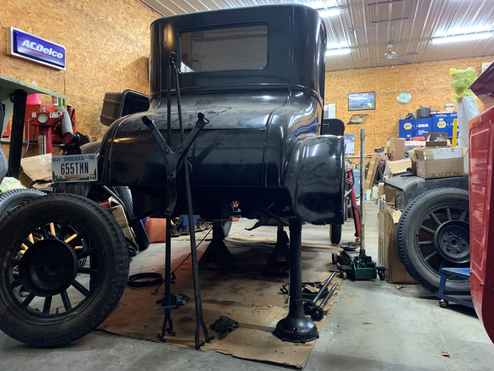

Chris that looks very close to the spot I used for my 26 Roadster. Maybe the lighter body makes a difference but mine was very stable.

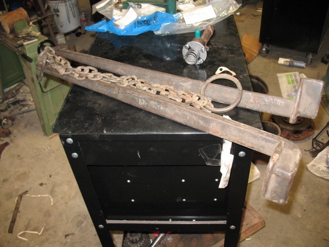

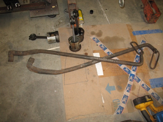

Here is a way to do it.
And there are these too
Here a way to lift the front

Chris B. ,

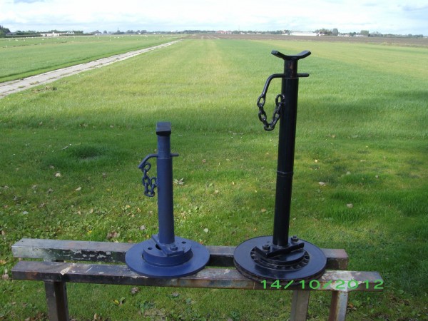

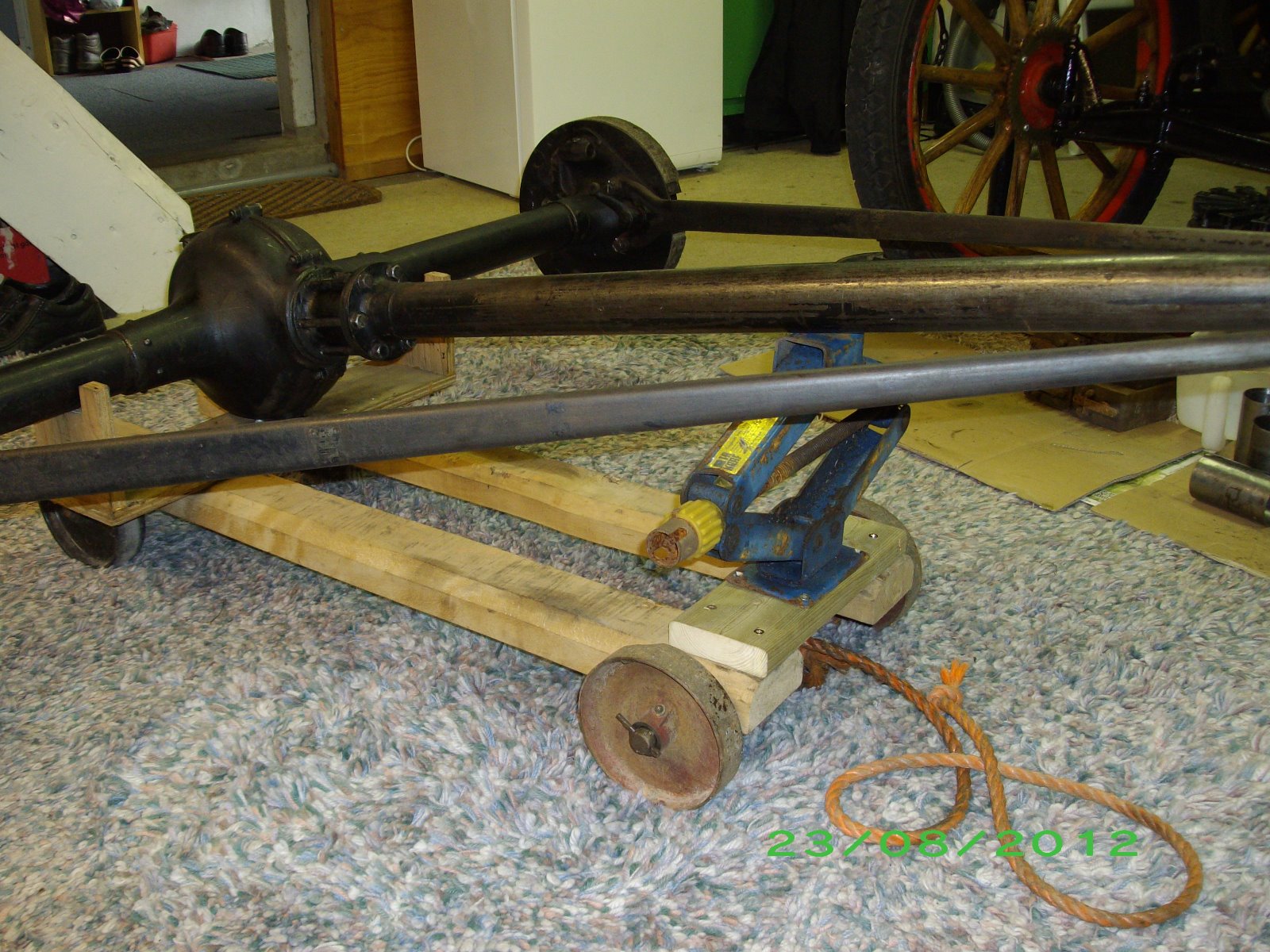

I use this to help me to remove the rear axle .

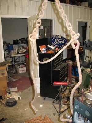

Well I guess it's time to share my secret of how I lift my cars when working on them. I have a phone booth in the back corner of my shop and when I need to lift a car I run over to the booth and …
Sometimes my daughter comes out to help …

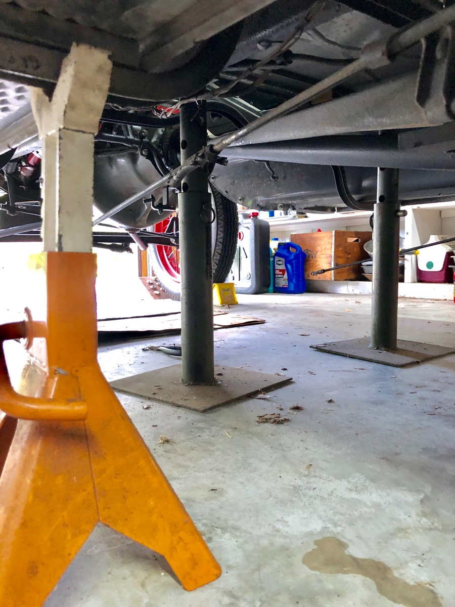

You don’t have to remove the rear radius rods, good balance is made on the frame as far forward as allowed.
Mine is done without a lift, but using safe high lift jack stands on the frame , these were US military surplus. Plus notice the yellow China stands there for added security anyway, they touch the running board brackets for peace of mind.
If you doubt you have adequate support, don’t proceed.

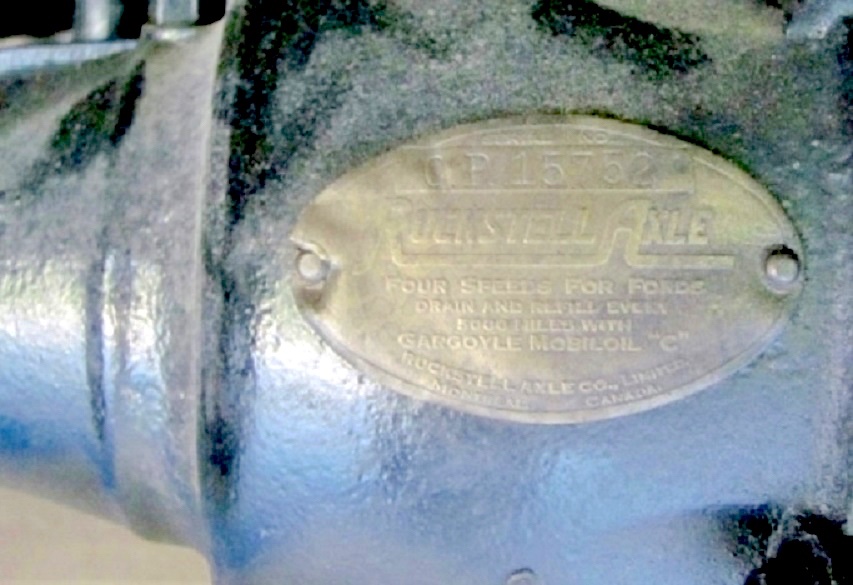

Dan, it looks like you have a Canadian Ruckstell.
- Posts: 4112
Re: Jacking help removing rear axle
Larry
Good eye noting the oval tag.
Yep, running an imported axle on my Model T......egads

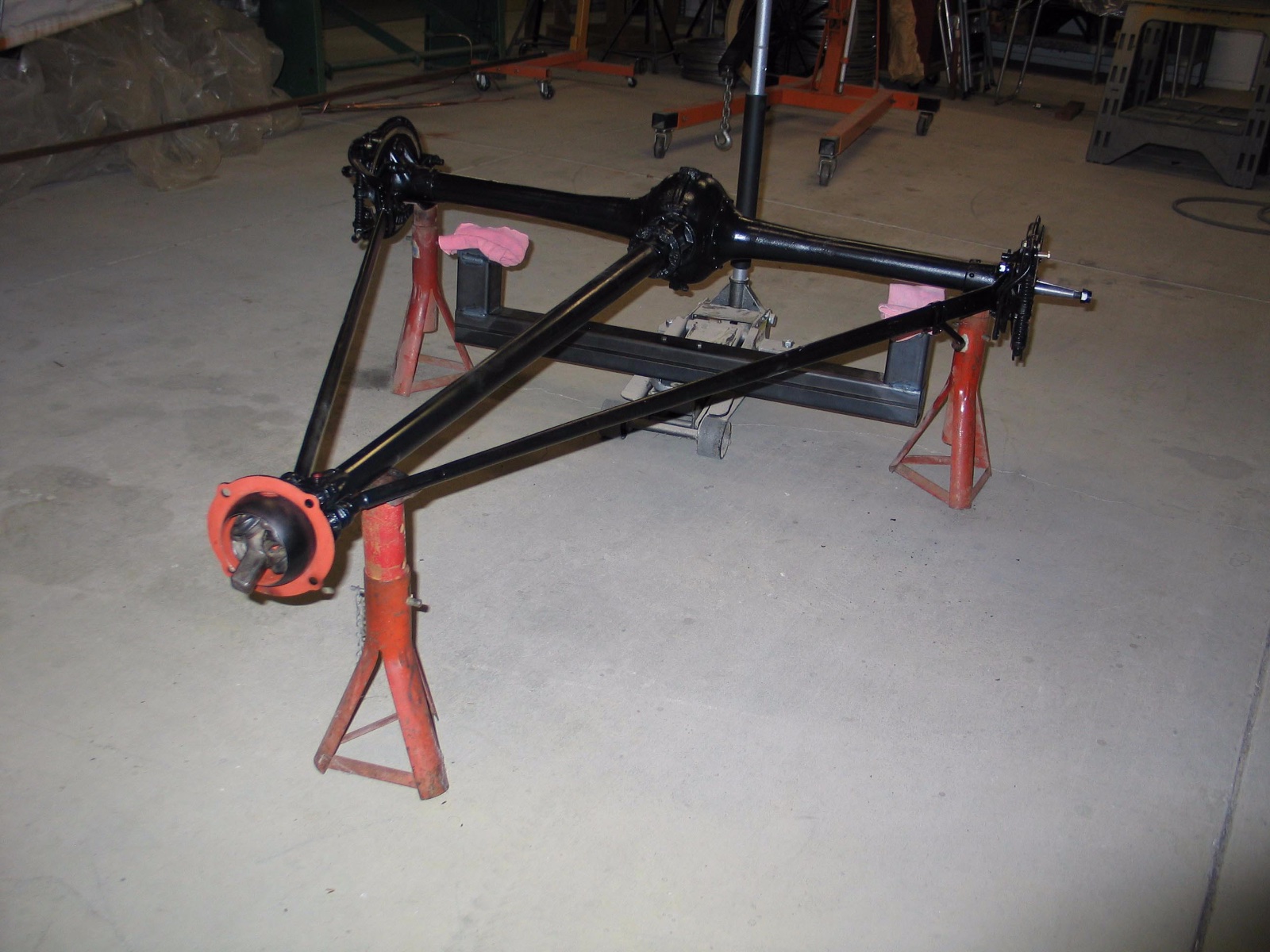

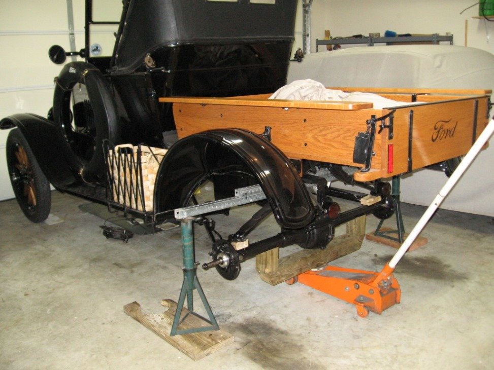

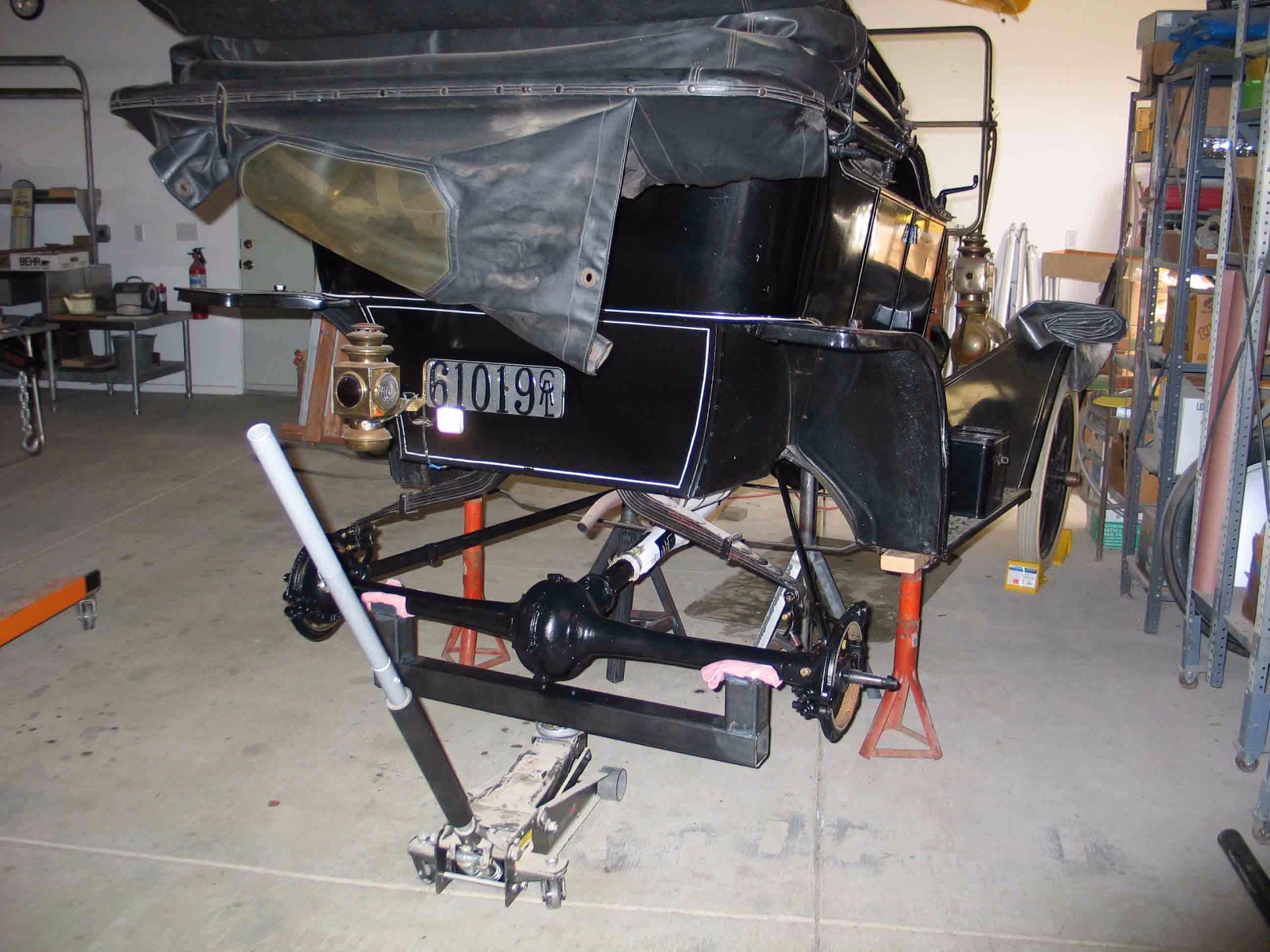

I use the method first posted above by Mark. A six foot piece of 2" x 2" square tubing right in front of the rear spring works perfectly. I agree you want better stands. I use home made ones that are 27" tall, which gives me plenty of room.
You didn't ask this, but I'll mention that you don't need a spring spreader. Just loosen the rear perch nuts enough to relax the shackles. You don't even have to remove the perches.
Here's a video of the whole thing: https://www.youtube.com/watch?v=8mZzAt9Q_4k

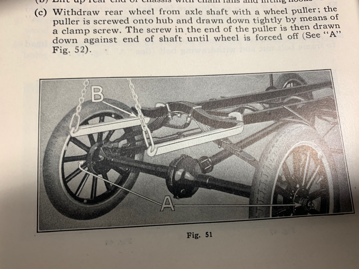

Here are some pictures. One is out of the service manual.
It works with a whole car.
Here is a picture one being used in the day. Here is the whole picture. Hope that helps. Dan

Would it be safe to put the ends of the straight bars on stands or are these lifting bars strictly an overhead hoist thing? Yes, I understand that ground support would get in the way of pulling the removed bits out from under the car, but I think that could be managed...
Eric

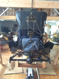

Personally, I prefer the overhead approach to rear axle removal. I built an overhead beam out of doubled 2x6s for my vintage chain fall. It could also serve for pulling the engine. Timber is handy and easy to make into needed garage items. The axle support on the floor jack is a 4x4 with appropriate additions.

Only used them by lifting, that way rear end rolls out easy. Dan
RGould1910
- Posts: 1244
- Last Name: Gould
- Location: Folsom, CA
Agree with Mike Walker that unless the engine is out of the car, there is no need to remove the radius rods. I use egg crates with a plywood topper to support jack stands. Done it literally a couple dozen times. Never an issue.
Scott C.
- Posts: 864
- Last Name: Clements
- Location: Waynetown Indiana
I just pulled the rear end out of my 26 coupe. Just like the roadster, I placed the stands as far back as I could to clear the radius rods. It is very stable.
