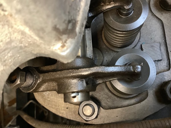

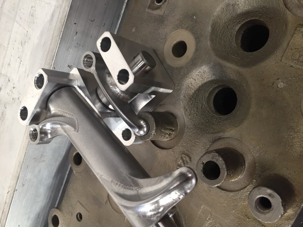

Chad I’ll post some pics tomorrow. I used a set that Jack Daron made up before he passed. He used to sell a lot of them. I’m not sure they are what Hank mentioned , but possibly so. Going from memory, we needed to use a small cap between the rocker arm and lifter that are made to revolve, used when things don’t exactly line up. T

Beautiful Work as always Kevin!

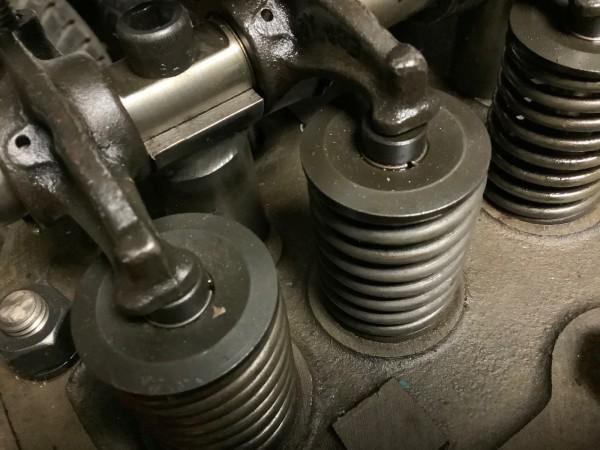

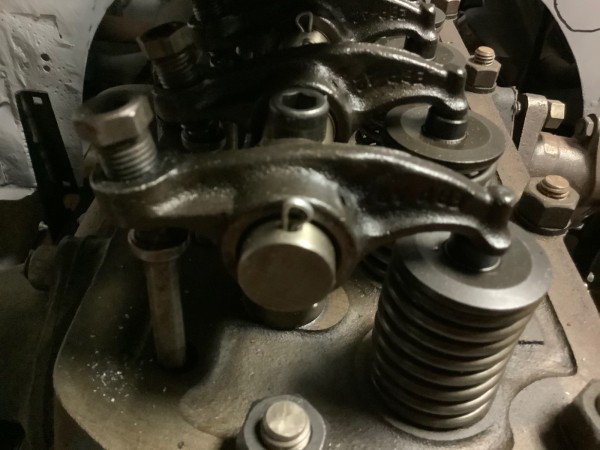

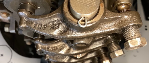

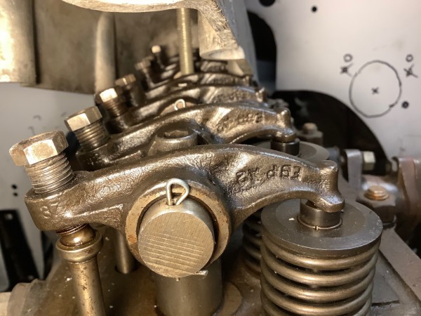

Tim,
What is the number cast into the side of those rockers?
Would it be possible to get a few more shots of that setup--including one directly above a pair of rockers?
Thank You for the time in doing this.

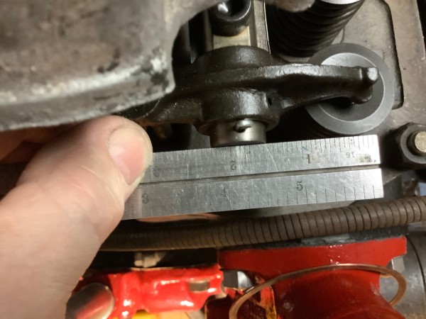

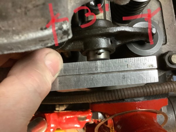

Chad, I have to tweak my firewall a bit to get the valve cover off easily. I’ll get to it soon, and can take better pics then. T
- Posts: 3384
- Last Name: Morsher
- Location: Norwalk Ohio
Re: Frontenac Rocker Arms
Looks like 3” between push rod center and valve stem center

A little searching on the web shows the EBP rockers coming from a 223 cube Ford 6.

Tim, THANK YOU!
What baffles me is why a straight rocker arm isn't landing on the valve tip. The pushrod to valve stem tip should be a straight shot.
But this is getting somewhere now. The geometry isn't that great with those 223 rockers, but it looks usable. I am being a little to picky I guess, I tend to get a little anal building engines.
Edit: I just picked up a used set of the 223 rockers to give it a shot. I'll still be looking though for other options.

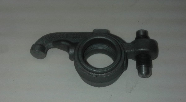

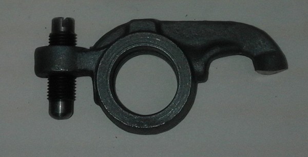

Nash Rocker
