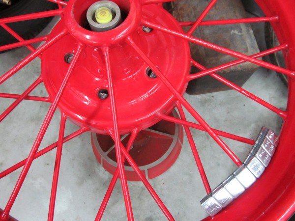

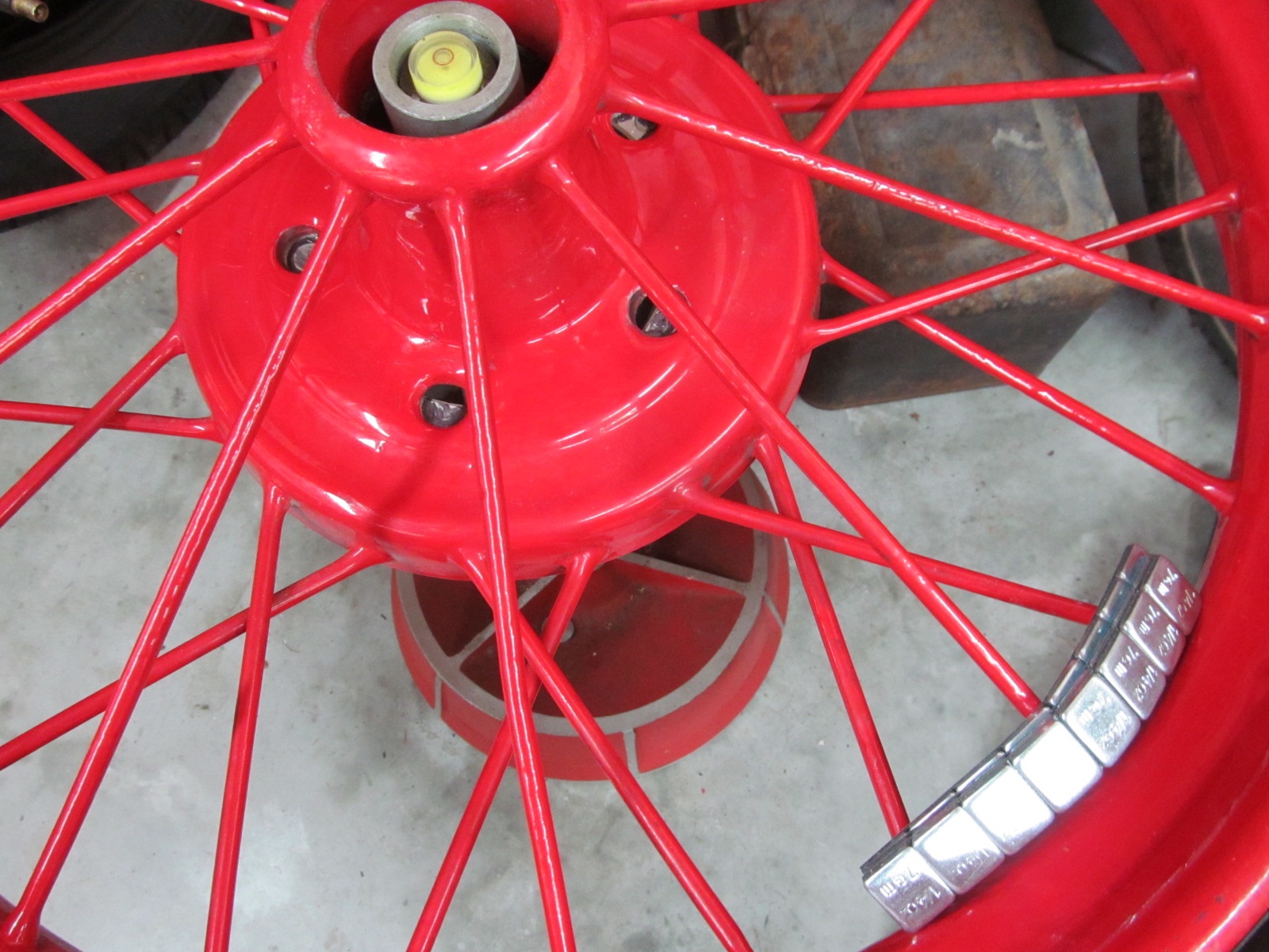

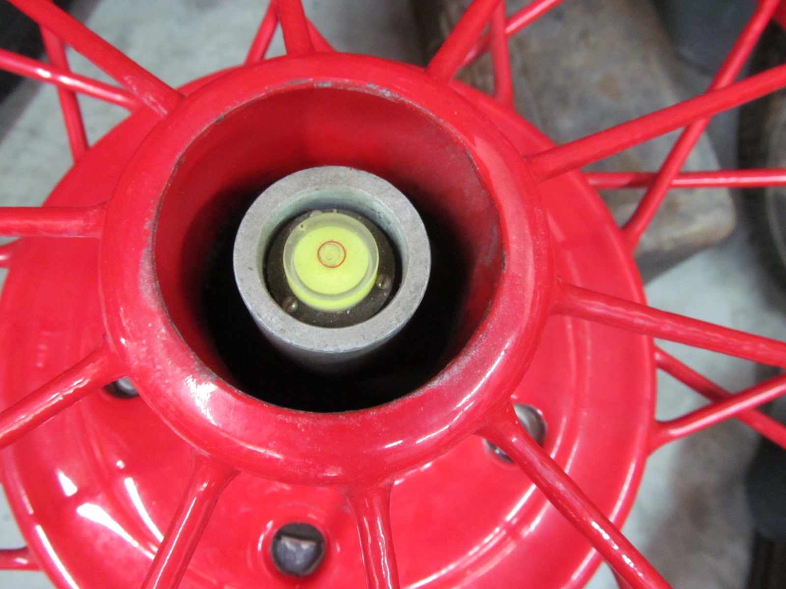

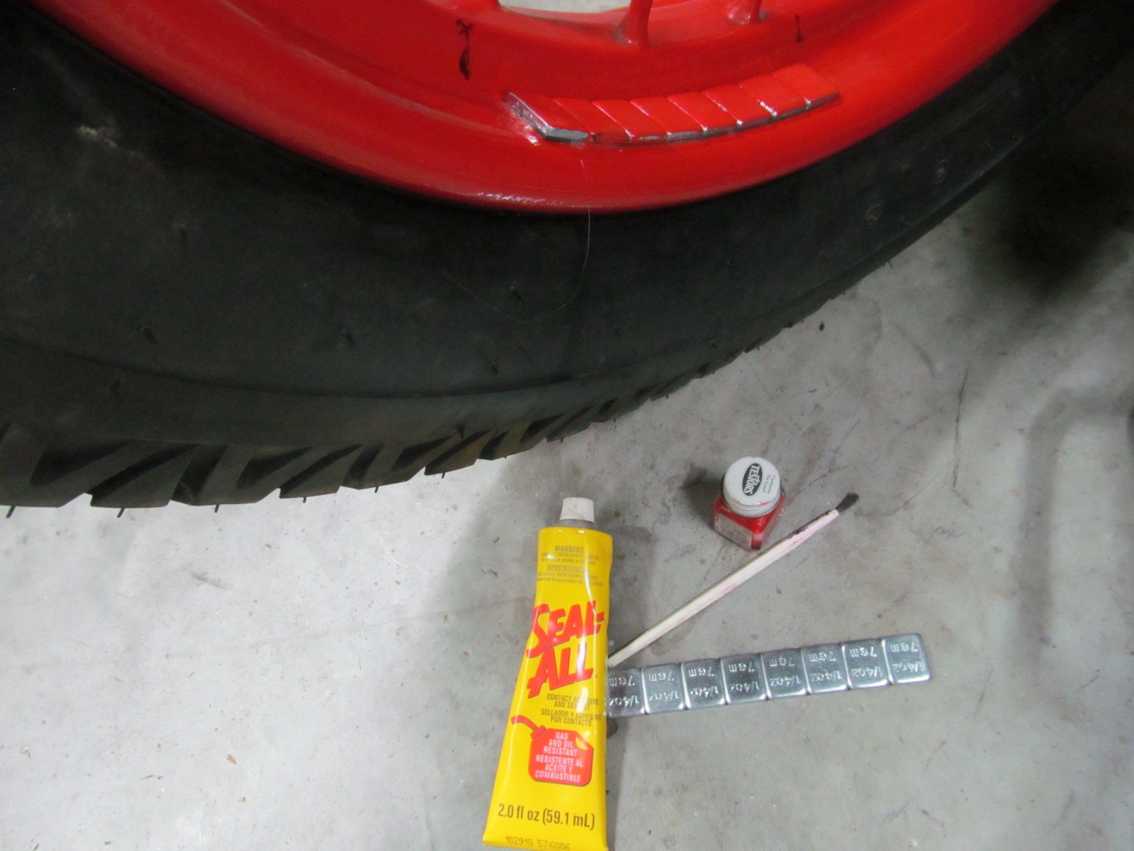

IMO and experience, balancing the new tires on the wheel helps with overall good tire wear, coupled with correct front alignment. Handling seems better with balanced wheel and tire. Even at my road speeds of 32-38 most times.
Easy with wire wheels, as you can bubble balance the Ford welded wire wheel, with adding glue on weights to get the tire and wheel in balance. For me, new tires require re-balance. When removing the old tires, the balance weights placed on the rim of the wire wheels had to be removed, and new weight positioned. That to me confirms tires are different and re-balance helps out.
For me, have never used tire beads in the tubes, as these work only at road speeds, that sling the beads where needed. At rest, the beads take another place in the tube. And seems to me hard bounce of tire over bumps would continue to sling beads up or down. And IMO, any moisture in the tube from air ups, might cause lumps, or maybe wear the thinner rubber tubes? Don't know, just think so. Do figure tire beads in tubeless tires work as intended.
Some do it this way.....interesting method.
This method works for me.
Moving weights around to find the best bubble center.
Once in balance, mark where weights will be placed.
Extra adhesive keeps those stick on weights best, paint hides them.
