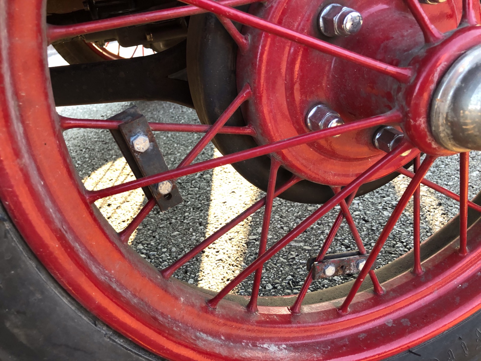

Loose bearing method with stick-on weights, use tape to put weights on felloe at the top, opposite the heavy spot. Keep adding weights until the wheel stays put no matter where you stop it. Sometimes you may need to move the weight a little one way or the other, but you should never need to put weight in two different spots. Once it balances, remove the taped weights and stick them on permanently. A little paint or black tape over them and they are hardly noticeable.

You will need as a minimum, the same amount of weight (or more) as it takes to static balance your wheel on the car. So, with loose wheel bearing, if it takes 5 oz of weight to get the tire to not seek a particular spot, then you will need at least that amount in the tube. Due to the way the beads disburse while running, once the wheel reaches critical speed, the amount of natural unbalance in the tire will be offset by the same weight of beads, and the remainder of "extra" beads will simply disburse randomly. Extra beads may be wasteful, but they aren't harmful.

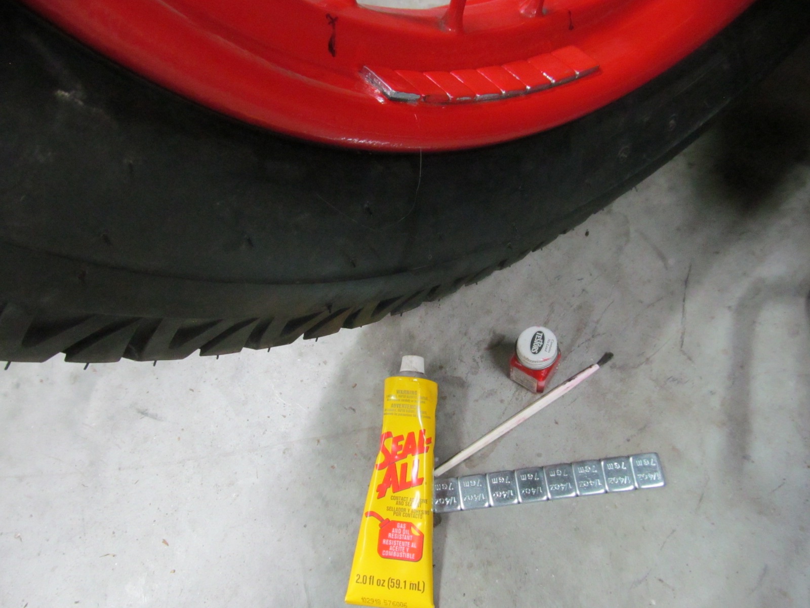

IMO and experience, balancing the new tires on the wheel helps with overall good tire wear, coupled with correct front alignment. Handling seems better with balanced wheel and tire. Even at my road speeds of 32-38 most times.
Easy with wire wheels, as you can bubble balance the Ford welded wire wheel, with adding glue on weights to get the tire and wheel in balance. For me, new tires require re-balance. When removing the old tires, the balance weights placed on the rim of the wire wheels had to be removed, and new weight positioned. That to me confirms tires are different and re-balance helps out.
For me, have never used tire beads in the tubes, as these work only at road speeds, that sling the beads where needed. At rest, the beads take another place in the tube. And seems to me hard bounce of tire over bumps would continue to sling beads up or down. And IMO, any moisture in the tube from air ups, might cause lumps, or maybe wear the thinner rubber tubes? Don't know, just think so. Do figure tire beads in tubeless tires work as intended.
Some do it this way.....interesting method.
This method works for me.
Moving weights around to find the best bubble center.
Once in balance, mark where weights will be placed.
Extra adhesive keeps those stick on weights best, paint hides them.

As Alan Long pointed out, modern wheels are dynamically balanced which means that weights are placed on both the inside and outside edges of the rim, sometimes in different locations. This is important with todays wide tires, however on a narrow "T" tire where the weight will be placed on the flat of the felloe which is basically in the center of the width, a dynamic out of balance will most likely not be noticed especially at Model T speeds. Back when I was balancing tires in a shop, and before computer balancers, we still dynamically balanced but the operator was the computer and learned to recognize where to place the weights by the nature of the vibration on the balancer. Also, unless a tire was severely out of balance, the vibration usually wouldn't start until approximately 30mph and then go away around 35mph, and then come back again between 65-70mph. Unfortunately some of the "T" tires available are severely out of balance and the car begins to shake at 20-25mph and may take 6 or 7 ounces to balance. I have balanced many modern tires on aluminum wheels, including semi-truck tires on aluminum wheels that took less than an ounce to balance.
