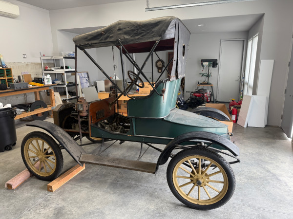

I have started restoration of a 1908 Model S which seems to be in similar condition to your car, with half of the oiler shaft missing and half rusted in the radiator. No rust or wood rot. Engine #1454.

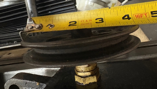

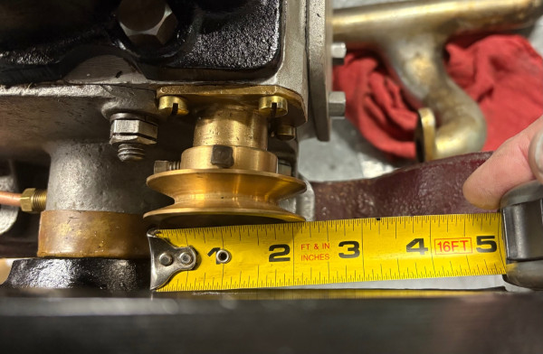

First question from my side at this moment.of someone could measure the diameter of the pulleys of the oiler and the one at the engine side
Thanks for the reply I think we have more or less the same car, serial number are also close together. You are always welcome. I send you an email.

It just so happens that I have the McCord Oiler for my 1908 Model S Roadster on a bench at the moment so I took a picture of the pulley with a tape measure next to it.
The S Roadster’s engine is on another bench nearby, so here is a picture of the drive pulley.
Hope these are useful,
Trent Boggess
