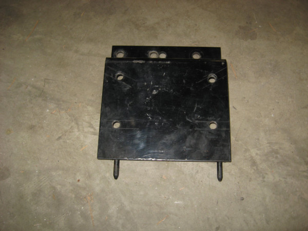

Hi Dan. I have one I made as a second that functionally is the same. It has been drilled for the bolts to mount at the water jacket and has the pins that align into the pan holes. I never drilled it for the engine stand because I never mounted it on my stand (I didn't need to hang two engines at the same time).
I can send a picture tomorrow if you are interested. You can have it for $30 plus actual postage. It can fit in a flat rate padded envelope. I'm attaching my contact info; please send an email and I'll get a picture to you.

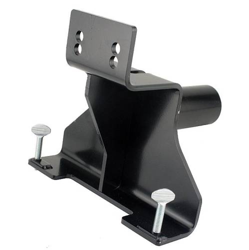

This is the type I'd like to get.

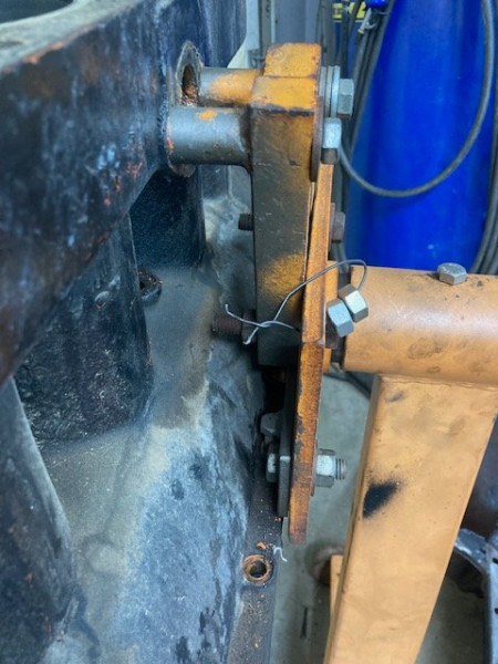

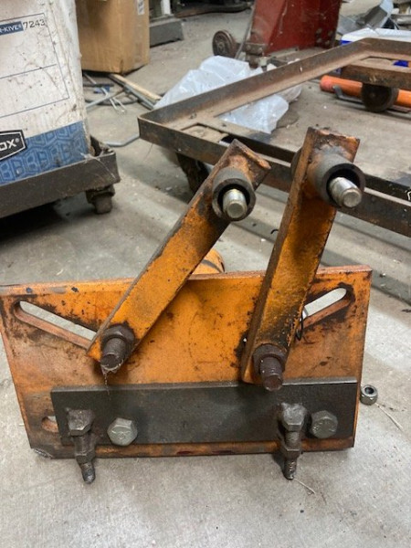

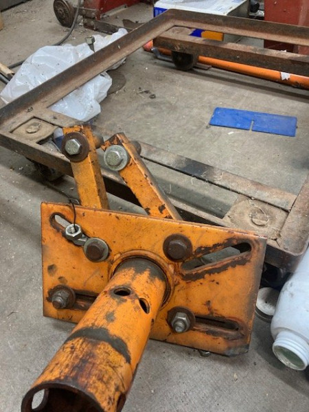

I'd check out Gary's the price is great. But for others that missed out this is what I came up with for my cheap budget. Using a $30 swap meet
engine stand & a little ingenuity I came up with this. It's cheap & you can move the center of gravity ( engine only to engine & trans ) without
taking the engine off the stand. It will not work with every engine stand & requires some drilling & welding but not much work that you can't
find someone to help with if you can't do those yourself. Craig.

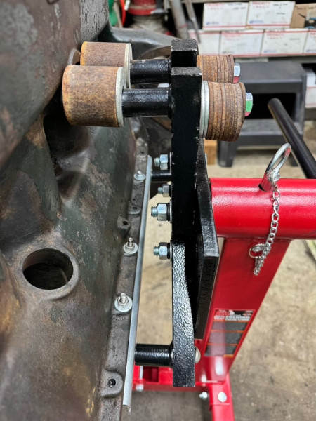

I made one I'm using now, I need to adjust the bottom angle iron above the pan, not perfect but does the job. Just looking for the basic one as I want to start another engine I have at the same time. I could make another, but the one piece unit would be nice to have.

Engine stands come with the round tube / plate assembly and four arms to bolt up to pretty much any engine block. The adapter plate the vendors used to sell mounted to this, or fixed adapters; all you had to do was drill 4 holes for the arms to bolt to, or if your tube/plate assembly had fixed holes you’d drill the T adapter plate to match. The problem with one having a fixed tube is that not all angine stands have the same diameter tube, so an adapter plate has a fixed tube attached it only works with stands that accept that size tube. That’s why an adapter plate that bolts to the tube is more versatile, and why I built mine that way.
If you’re interested let me know, if not that’s fine too.

I'm looking for one like the venders sold that will fit both the Model T and the Model A like the one pictured above. Thanks for your offer though.
