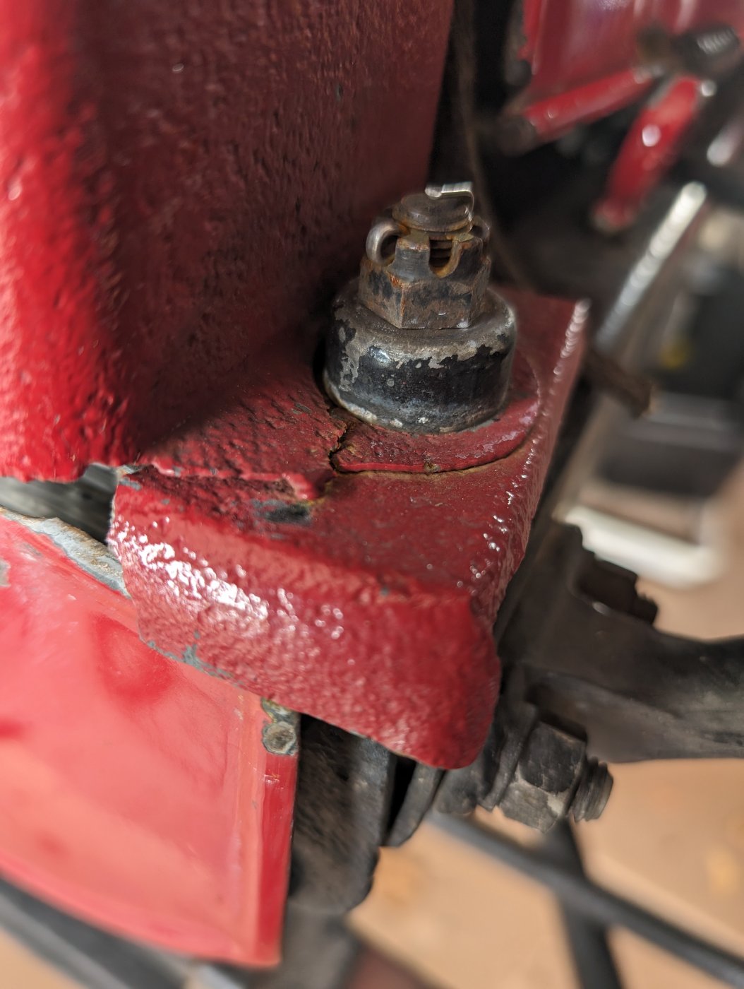

I do not know if they have a name. These small pieces that are
rivited or welded to the main shroud to give it extra support. I need both
left and right sides. Thank you.

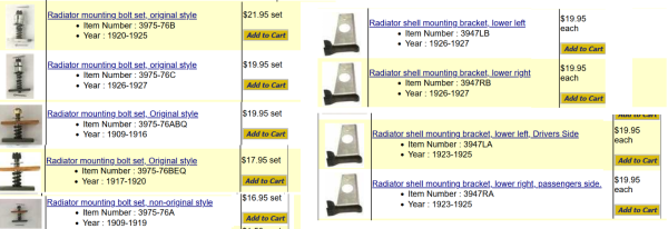

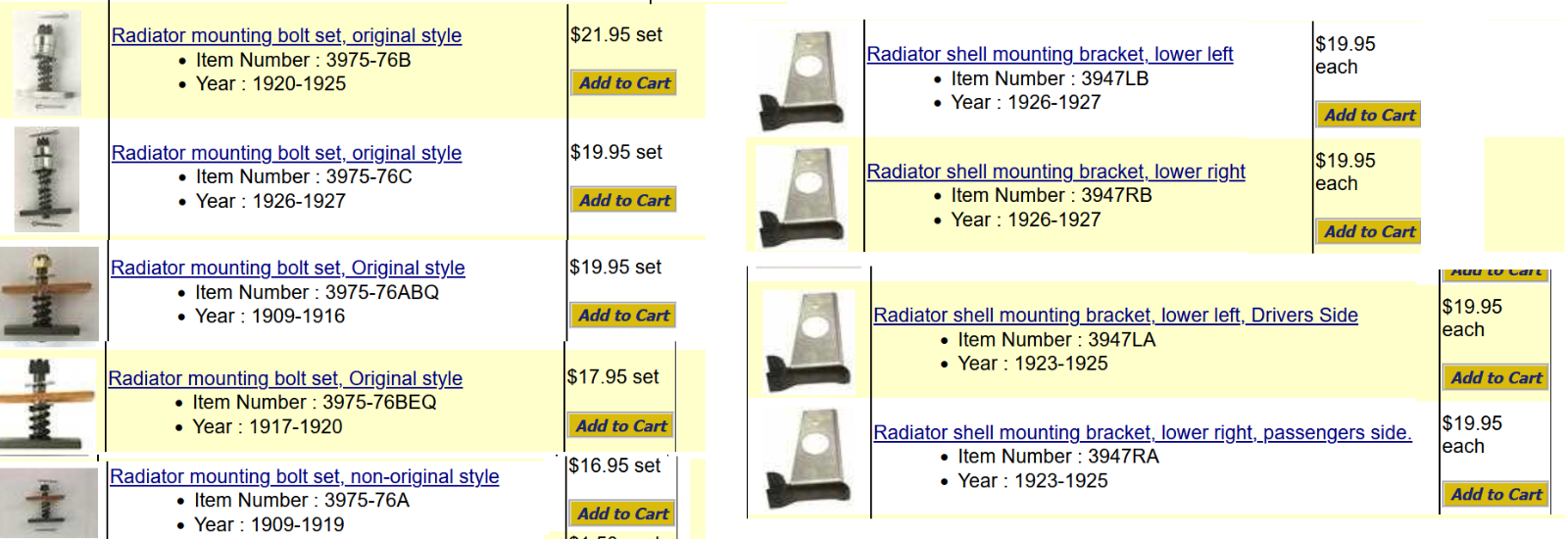

Dave, your photo shows a mix of parts. if it is a low radiator car, it has a later reproduction apron. that is narrower than it should be. If it is a low radiator car, the pieces you show are actually part of the attached skirt on the shell.
So a high radiator car has those pieces riveted to the shell. Langs list them as part no 3947 in brass or steel, left and right.
Hope this helps.
Hope this helps.

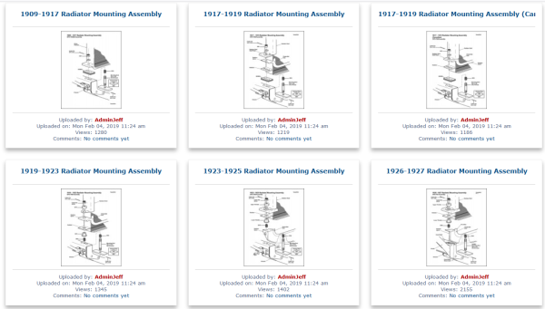

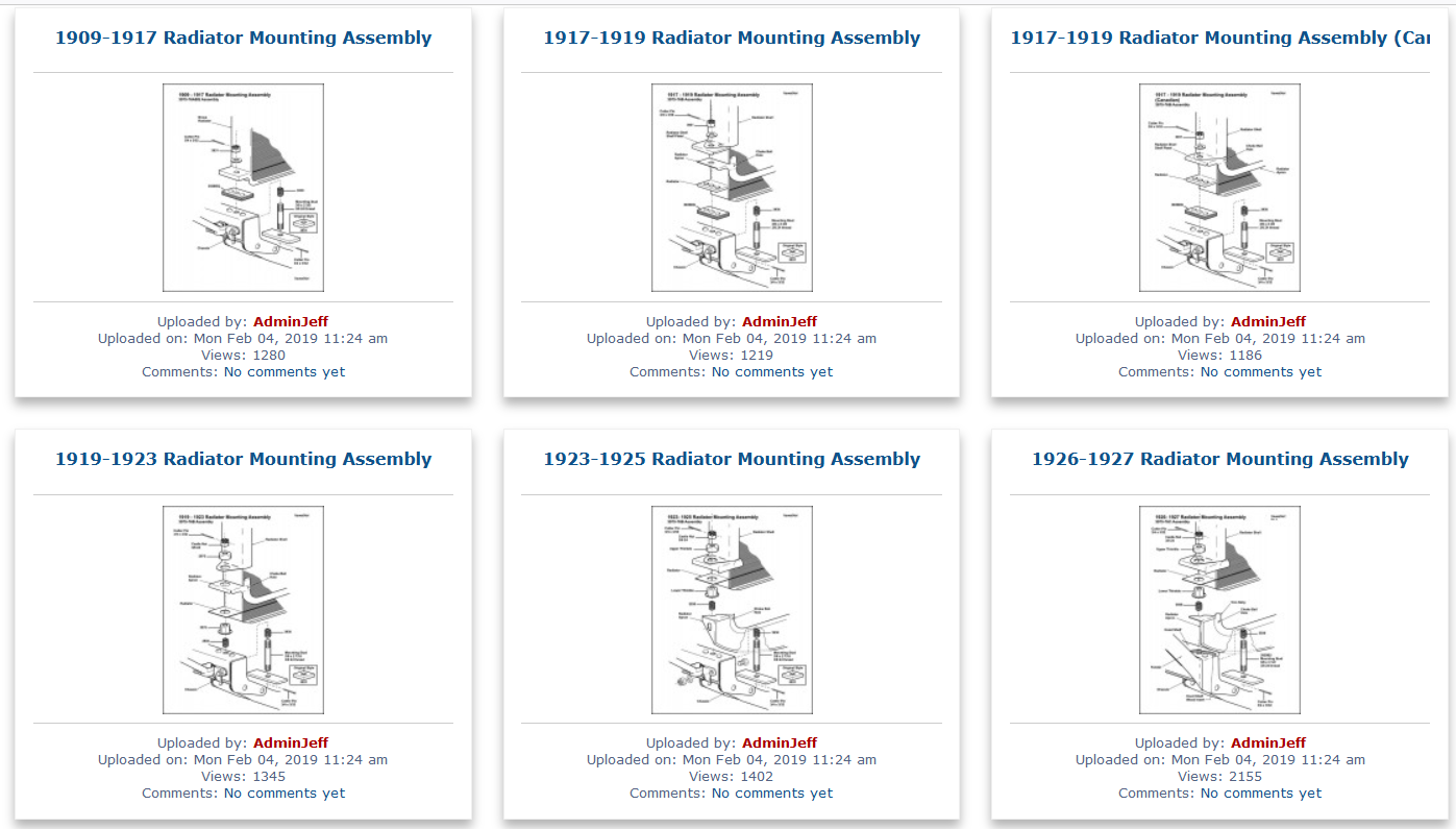

year dependent
https://www.modeltford.com/model-t-part ... radiators/ --
click here to get to the diagrams app.php/gallery/album/35

It is a speedster, so it is a mix of parts. The engine is a 24 so try to stay around that time period. A friend built this in high school, so I am sure it is not all one year. I did not know Langs might have some. I have had a couple shrouds break apart at that point, so any extra support is better than none. Thank you.
