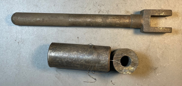

Heres the tool I use. Got the idea from Dan Hatch.

Richard, thank you for your reply. I am hoping to remake the original tool, I am not trying to repair an axle. I believe I made the Steven's tool you show in your picture

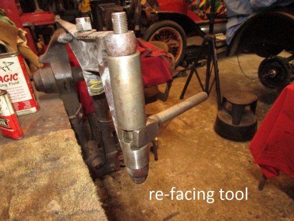

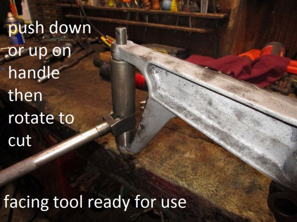

If you do make the tool for sale like your Reaming Fixture Frames, I will definitely buy one, not just saying' I'll even pre-pay. I use a reverse spot-facer and it works, but an original or quality reproduction would be very much appreciated. Here are a couple of photos from the Forum showing it in use (for those not in the know) and a link to a complete axle rebuild. As far as I know it is not shown in the Stevens catalog.
viewtopic.php?f=2&t=26080&p=200399&hili ... le#p200399
DB axle (16).JPG (69.17 KiB) Viewed 6485 times
DB axle (17).JPG (70.12 KiB) Viewed 6485 times
dobro1956
Posts: 1433
First Name: Donnie
Last Name: Brown
Location: Hills of Arkansas
Re: WTB Steven's front axle yoke resurfacing tool
Post by dobro1956 » Sat Feb 01, 2025 12:40 am
Jack. The photos posted above are my refacer. I may have the only one left ??. I have never seen another. I do not want to sell mine, but would consider a short term loan if it would help you getting them made. I use it fairly often so it can only be loaned for a short time. The main issue I see is the cutter is extremely hard. Properly making it would be the key to having a useable tool. It really does not "cut" as it re-faces but "scrapes" the surface smooth. It makes extremely fine shavings and must be cleaned very often as it's being used. The cam and the handle would also need to be very hard because they are under a lot of pressure when in use. But they probably are not as hard as the cutter. Send me a message if you want to discuss it.

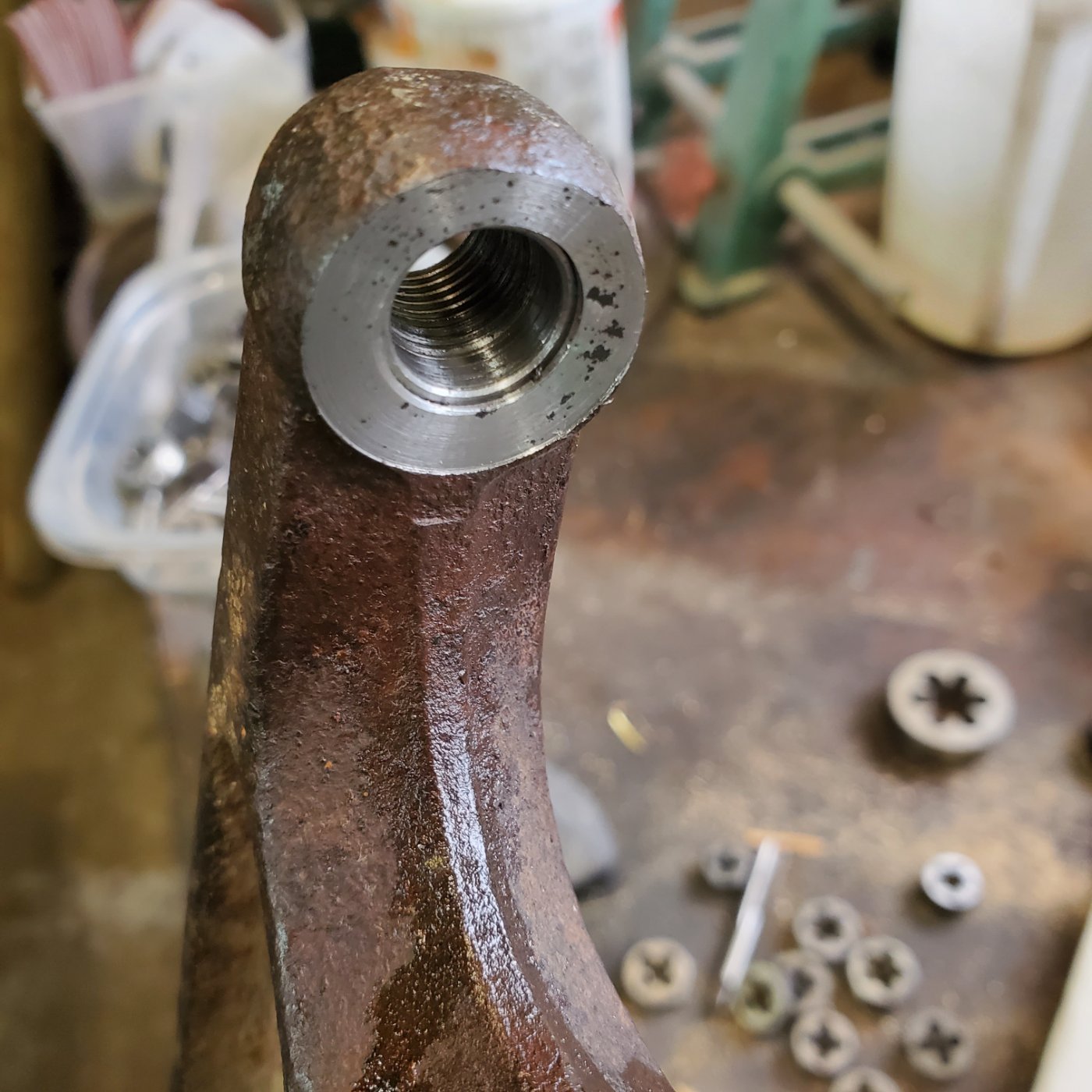

No, there are at least two survivors. This one is NOS.
