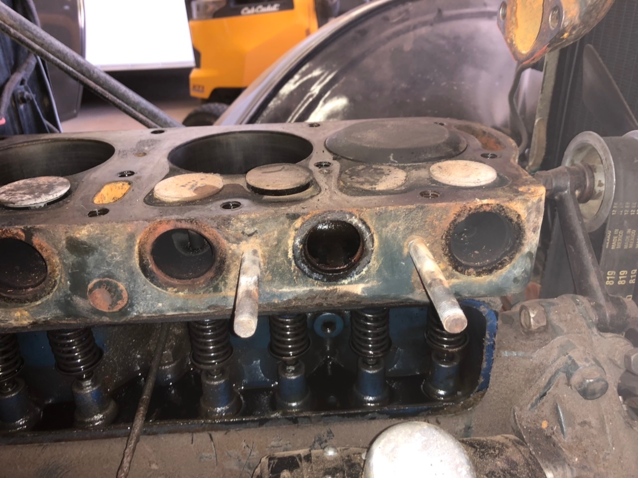

After talking over possible causes with Ron, I decided to pull the head off which I had not yet done. I was pleased to find no two piece valves and I have aluminum pistons. I was not pleased to find evidence of the #3 exhaust valve running hot and also possible issues with #1. The bores, pistons etc look great and I am pretty sure this engine has had a rebuild not too many hours ago. Do I have sticking valves or leaky manifolds? I have manifold gasket kit on the way in case I need to tear these down. Any observations welcome.

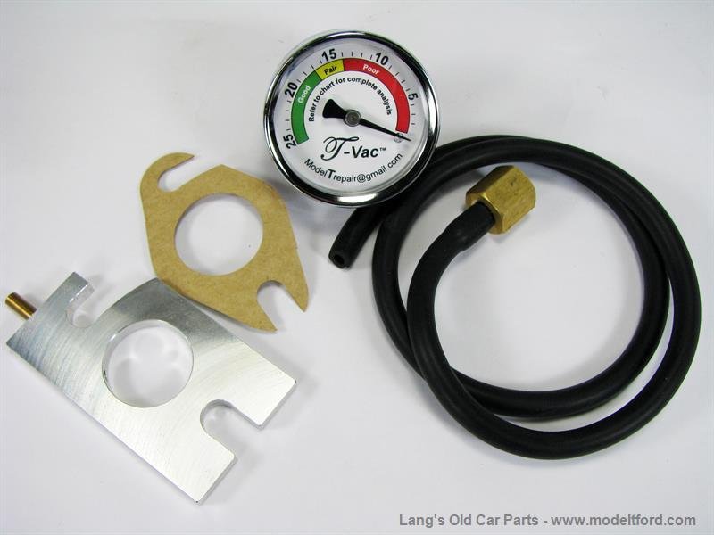

Re: Erratic Rough Running TT
you need one of these

Cory is on the right track. I think you should be looking for an intake leak.

I had read your thread with interest and hope you have solved your issue. I’m always up for a new tool so will take a look at the T-Vac. I’m really hoping I’m not in line for a valve job but that would be par for the course at this point.

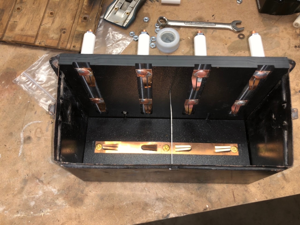

Well, some of the parts showed up so I dove in. Unfortunately the T-Vac is backordered so will press forward with out it. Completed the coil box with the Langs/Fun-projects kit. I then pulled the manifolds. It definitely showed signs of exhaust leaks on #3 & #4. It had the dreaded fiber gaskets which were well beyond their life cycle so probably had intake leaks as well. The manifold checks out square so I’m going back with individual copper gaskets and new glands. We willl see where that gets us.
