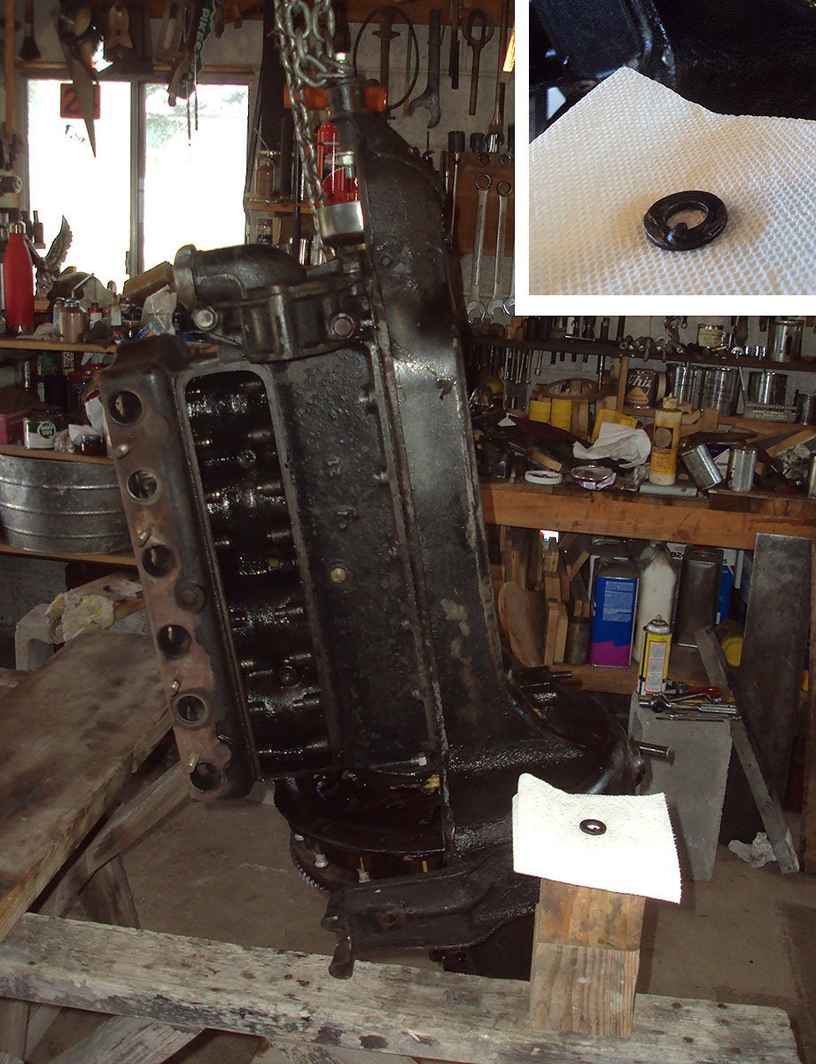

Here is a photo of the offending washer in backwards. I hadn’t heard of the taping trick before. I did wire a towel on and spun it through a couple of times. That also worked for me years ago.
I removed the inspection cover from the crankcase to see if I could get at it that way. Also tried a finger, a screwdriver and a wire through the drain plug hole. I can’t feel or hear it anywhere. As much as I hate to I decided to pull the engine and stand it on end. The headlights and radiator had to come off. The nuts are now rusted in place. I had just struggled with my ’14 radiator bolts. That hidden plate idea works well until your stud nuts seize. Penetrating oil and heat finally worked for the nuts but the headlight posts were really tough to break loose. I was reminded of many fenders we found torn around the post to free them from the car. I have patched these fenders in that area as shown. I had drained the radiator a few days ago. It turns out that when you tip the radiator in removing it there is still enough coolant in the lower tank to dribble for as long as it takes to find a bucket.
Also it is a good idea to get the hood rod out of the way. In my case the coil box lid is in the way and the box bolts have to be loosened to get the lid off. This reminds me that I haven’t had to change a coil in 7 or 8 years. (looking at the bright side where ever I can find it.) The dark area in the coil photo shows where I notched the wood for the lid. I had good patterns and photos but it still had the problem. I need to cut a notch for the hood rod head too.
I thought the head should be removed at this point to. I feared the gasket was the root of the coolant in the oil problem. It turned out not to be. The two rear head bolts are tucked under the firewall recess. My socket wrench won’t go on them. One was stubborn and required making a bar to hold my end wrench down. It felt like the cheater bar was bending my end wrench but things finally broke loose without damage. My Uncle George gave me that Craftsman set in 1964.
I felt as though I had removed everything but the body. Well guess what! The crankcase arms are wider that the space between the body wood and brackets at that point. This may well be my fault but the same problem exists with my ’15 Runabout. Now the body bolts have to be loosened on one side and the body lifted about an inch.
I left the project yesterday with the engine standing on end and no sign of the washer. I found I can manage 5 hours and after a nap another hour or two. I haven’t resorted to violence but remember a ’19 Overland I had. The head had been broken in a way that looked like a frustrated mechanic took a sledge hammer to it. But I digress. While this has been somewhat frustrating it probably is a good chance to clean, oil and adjust everything. We have enjoyed a lot of driving in this car with a minimum of problems. Many parts are in much better shape than I expected to find them. Today I will remove the crankcase. I can’t imaging where that washer went. Perhaps into the drums?

I started yesterday pushing the magnets on wires in every direction I could with the engine vertical. I was starting to doubt my sanity. Where could it be. Then in preparation to remove the crankcase I tipped it backward. At the angle shown I heard the sound of the washer hit the floor. That was as wonderful as losing it was horrible. I will never know where it was but it doesn't matter.
I will still remove the pan as most of the bolts were removed. I had done a lot of cleaning in preparation for re-installation. It will be much easier with out the black, greasy, slimy crud on everything although it is a great preservative I have found. As it is nearly an eighth of an inch thick I practice my skills with a putty knife followed by dry and solvent soaked rags to get the worst of the crud off. This saves a lot off solvent when I go to the wash pan. In the spirit of Steve Jelf and other thrift heroes I save the paper packing that parts come in, smooth it out and save it on a roll. This is great to drop on the floor to catch all the little grimy clumps that smear ooze everywhere. I don't want it on the carpet. :D A can to scoop it into is also handy. I will think of a good use for it someday. Perhaps a dandy wood stain.
I enjoy the fact that this car uses parts discarded from use that still are usable. The pits and corrosion is charming to me in it's own way. Also shown is my answer to slowing down the pan bolt leaks. I made copper washers and cut donuts of plastic tubing to seal the oversize bolt holes. Not perfect but better that other fixes I have tried.
At long last I can finish cleaning parts and simply put the engine back in place. What else could go wrong? :?
Since I had no real plans for the week this had been a good thing to do in many ways. The weather is great for this and car work is always a nice pastime. This car doesn't require the perfection of the better restorations and I can appreciate how average mechanics saw things back in those days repairing well used Fords.

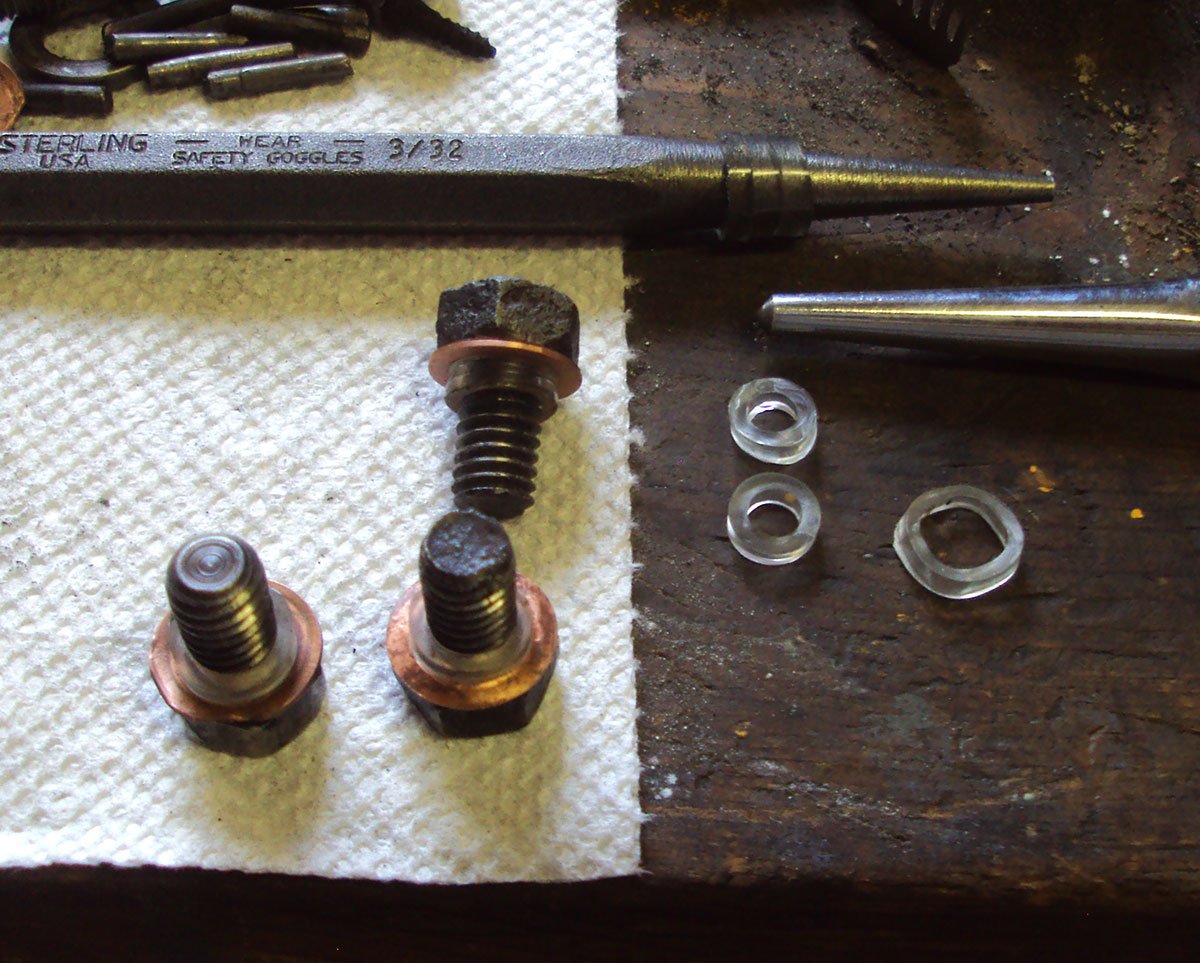

Progress is going well on reassembly and installation. I see that vendors are offering an o-ring seal kit for the inspection cover bolts but it is required to countersink the bolt holes for them. I was cutting new donuts for my solution. I don't have the right size tubing so I stretch these on. By stretching them on a tapered punch they are easier to persuade on the bolt. Leaving them on the punch overnight works best. They soon shrink back tight and I don't have to modify the holes. Most of the plastic pushes into the hole and little is seen under the washer.
I also noticed my valve spring caps have been "renewed" with some braising. It seems to have worn well. I don't see this procedure discuses it the service manual or the flat rate book. I wonder how common it was.

Rich - run down to your local Lowes - they have tin roof sealing washers - rubber seal with aluminum washer - I install on every engine that comes out of here !

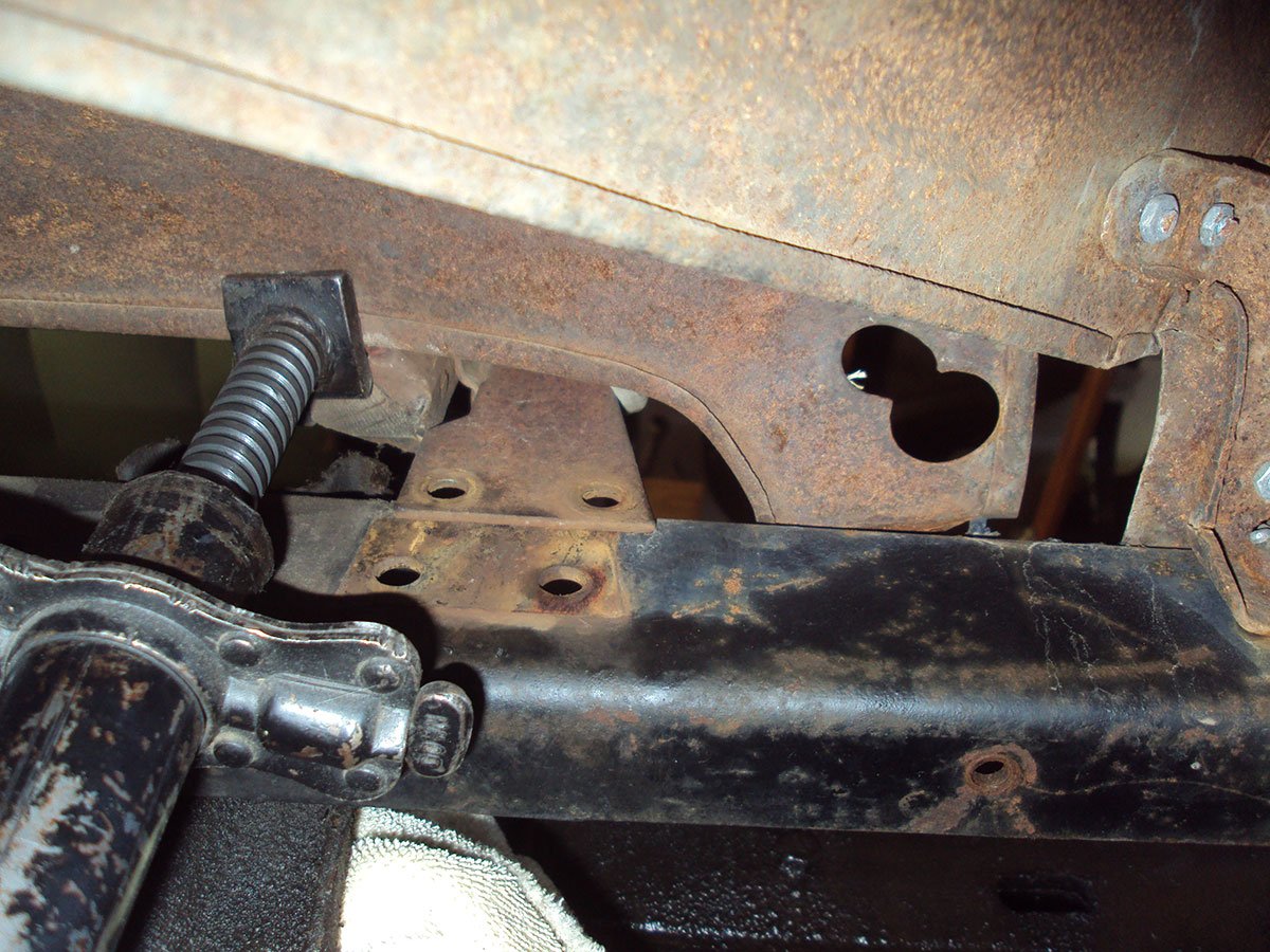

I have had trouble getting the hogshead in without tearing up the rear gasket. I cut this out of sheet to protect the gasket and help slide the hogshead past the ball cap. It worked well.
Leaving the steering bracket in place seemed like a good idea but the suspended motor got away from me and wiped out the grease cup. Oops! Looking for a spare I found this one with a damaged cup. It seemed only right to salvage the lower part and use the good cup on it. It was one of the old type with a seal.
Fortunately the cup fit the housing. I say that remembering my old friend, the late "Fireball Erickson", who insisted there were two sizes of that 3/4" thread, a large and a small. :lol: I couldn't convince him that 3/4 was 3/4.

3/4 may in fact be 3/4, however some manufacturers did use a different thread pitch. I have a small box of (not enough) miscellaneous grease cups. Along with a number of complete good cups, are several parts and pieces, some in good condition, some, not so good. Among those, are several perfectly good bottoms, and tops that are anywhere from nice to nasty. Many of those tops and bottoms will not fit together and work. These same bottoms and tops I can find complete units that interchange and work fine, so I know the threads are good. I often will exchange a rough, pitted or dented top, for a nicer one I have that doesn't fit any of the loose bottoms I have.
A couple years ago, I had "fun" fixing the grease cup for my '15's fan. It came with a damaged but actual genuine original female thread bottom mounted on the original hollow fan shaft bolt. However, the threaded area for the cup was damaged beyond use. Wanting to use the right piece I had, and not destroy any good complete grease cups I had in the process, took a bit of finagling. I took a standard common bottom I had several of (condition was poor), hacksawed off the threaded for the cup area, and after a bit of grinding, brazed it together with the original female base. Now I had a decent looking rare base, but none of the spare cups I had fit it. So, using a thread file, I altered the threads enough to work. Working with a bit of valve lapping compound, made it work more smoothly. I left it snug enough to hopefully not vibrate off should I ever get the car running.

Maybe too insignificant to mention, but I will, are the starter and generator cover screws. Mine was buggered up as many are. I have zinc and nickle plated ones that would work but look out of place on this car. I decided it was worth the time to repair the slot. Metal isn't missing but pushed out of place. It isn't difficult to pound it back and file a bit to get a slot that works right. I have saved many original screws this way for what it's worth.
Also, I noticed one was coarse thread and one was fine thread. Is there anyone out there who knows or cares what is really right?

Rich, it would have been much easier to retrieve that washer by just flipping that coupe over! Since you are a bit older than George was perhaps you could have just purchased a replacement washer and been done with it! ... if you could find three other guys to contribute enough cash to afford that replacement washer!

That's a great story Terry. I spent a lot of time considering leaving the washer there but the thought of catastrophe won out.
Switching my end wrenches to tighten and torquing to "about right" I have the engine back in and it runs. In the interest of curiosity and conservation I am reusing the old gaskets in most places. The head gasket is fiber with metal around the combustion chamber. Lots of copper-coat is applied.
The pan gaskets were a good fiber material and not cork. They stayed bonded to one surface except for the spot shown. I used Form a Gasket #2 on it. Holding it in place with string also keeps a guide bolt in place for positioning the crankcase.
Finally I gave the assembly a good coat of enamel in hopes that will do some sealing. After cleaning the crankcase there were several patches of bare metal showing and the paint will help that.
The rest of the engine has a mix of old paint, bare metal, rust and dried grime that I find pleasing to me. As it becomes oily and dirty that will be fine too. While all this is far from the way most of us enjoy the cars this has become fun and a different way of enjoying a Model T. I see a couple oil leaks already and will wedge some string or cloth in the cracks.
I'll report back when it sees the road.
