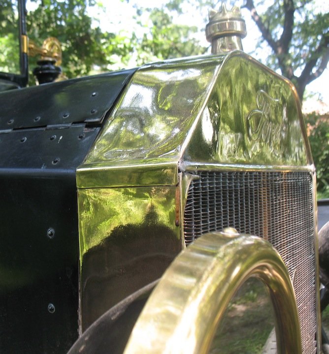

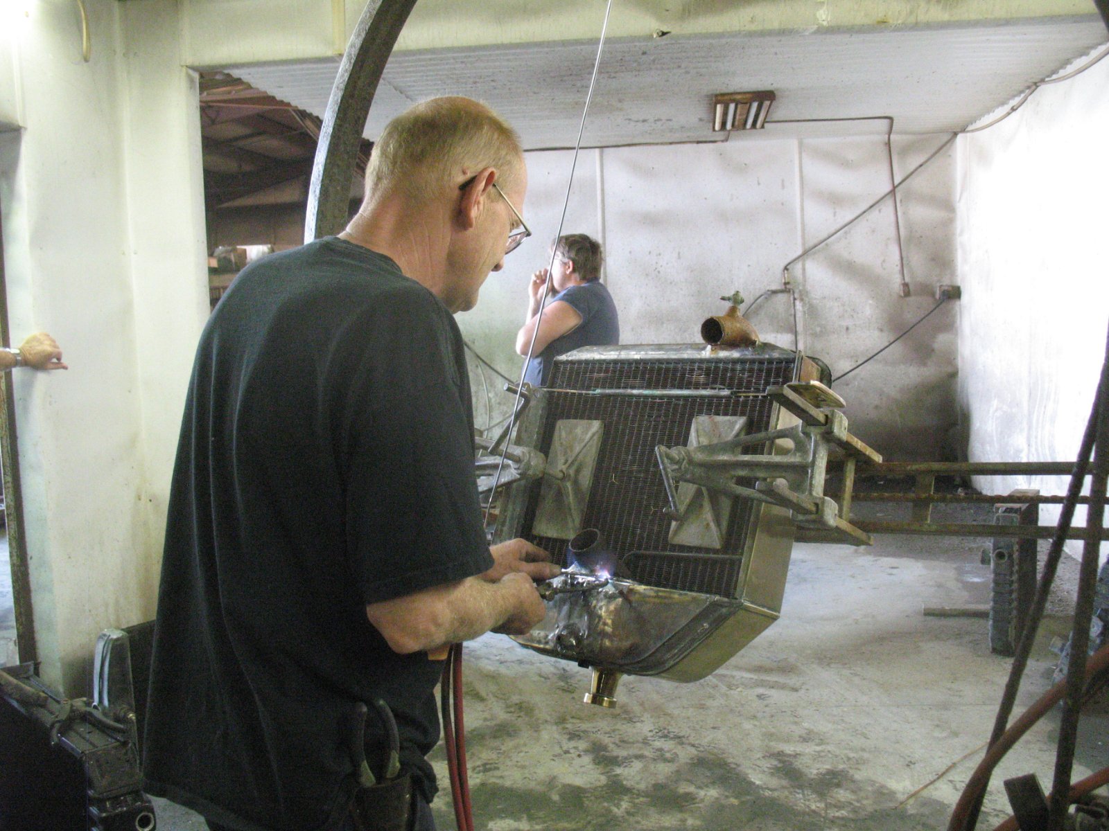

Instead of buying a new radiator for my 1915 I had the original recored, for three reasons. Most important to me was that I got to keep the original appearance. The new ones are not made the same. A secondary reason, but also significant, was saving a few hundred dollars. The third reason was second hand. I have no personal experience to back it up. But I have seen forum posts griping about the new radiators not surviving well on cars that get driven, and my car gets driven. I've had to patch up the tank on my original, but it doesn't look bad for 105 years old, and the recore solved the overheating problem.
PS: If you stick on a Ford logo don't use brass wire. :)

Steve, great method. I agree, if your tanks are good, maintain the originality. Hard to find good shoes to record in today's world, but I am sure they are out there!

My recore was done by Tom Nolte. He did a radiator for Rob's Model K, so I sent mine to him.
TOM’S RADIATOR SERVICE
2341 184th Road
Sabetha
KS 66534
(785) 284-2080
