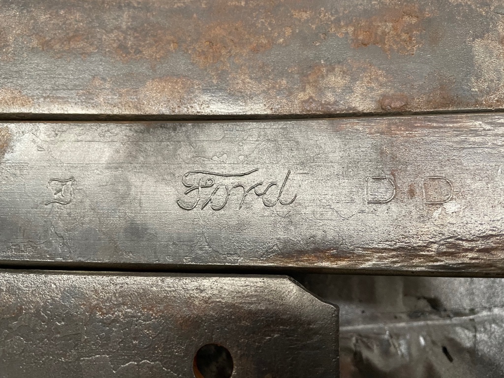

I'm prepping all of the parts for my ‘24 touring’s front axle for paint, including the spring leaves. After wire wheeling the rust and paint off of the spring leaves I found cracks in the top two. My plan was to replace them with the top two leaves out of the old spring assembly from my ‘25 express wagon that I replaced because it had lost much of its arch. However, the top two leaves in each set are different lengths as follows:
’24 touring top 2 leaves: 8-11/16, 13-1/4
’25 express wagon old top 2 leaves: 13-3/16, 14-7/8
The third leaf down in both sets are 18” +/— 1/16. Did the stack up change from ‘24 to ‘25? If not, which, if either, is correct?
Miles
1924 Touring “Bonnie”
1925 Express Wagon “Clyde”

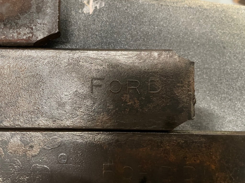

The lengths of the top two leaves of the two older sets aren’t even close to each other. In fact the top leaf out of the old set from my ‘24 is about the same length as the second one down in the set from my ‘24 touring, yet the third leaves down in both sets are very close to the same.
Measuring the new set on my ‘25, I think the shorter set of top two leaves are correct.
Also, I note that all but the top leaf out of the ‘24 have Ford markings, some block letters, some script, but all are embossed (not stamped, but actually raised above the surface), which I assume would have to be done in the forging process.
Miles
