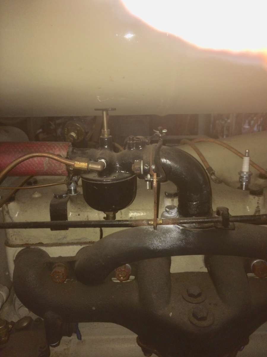

- Posts: 2889
- Last Name: House
Re: Fordson Assistance
Ya’ll I cheated
....I tried following the up and down movement of the raw gas as it turned into an air/fuel mixture and found that sheet metal ‘coil’ was toast so I turned to the old standby NH carb. Makes starting and running much simpler....Question: How do I keep the 2 bolts fastening the bottom of the radiator from leaking??..they extend up into the lower tank coolant.

George's photo shows the version of control rod that is dropped down along the head. The higher version has that rod up even with the head bolt heads (no drop). I'm not familiar with the radiator bolt leak problem, but I know what you mean. Perhaps some silicone smeared on the bolt threads?

George, I like the NH carburetor setup. It makes it down draft. Is it prone to flooding? Are you using the water bath aircleaner? Joe, your coils must buzz if it is running, probably can’t hear them over the engine noise. A battery is the only thing that makes them buzz in a T before starting.
Howdy Joe,
There’s no problem using an NH carb on a Fordson. I have one on my ‘19 ladder side 6 spoke rear wheel too. Don’t use the water bath air cleaner either. Just don’t plow in a dust storm.
