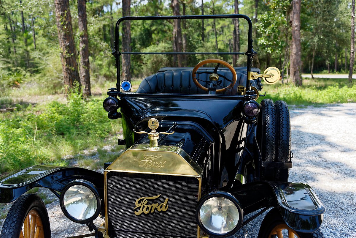

Hey guys,
I inherited my dad's 1916 Touring. I would like some of you to go over the pictures and tell me what's right, what's wrong and anything else you might add.
To begin with it is a 1916 (1222277), I have the original engine in my garage. It currently has a 1924 engine in it for ease of starting. It is 6 volt. I have changed out the spark plugs for modern ones because they all leaked. It runs well. I know I have a hot exhaust valve on number 3. (some may spot the paint coloration) I know the wheels and steering wheel came black from the factory.
There are more pictures on my google drive that have very high resolution. for instance, You can read the K-1 stamp on the speedometer.
https://drive.google.com/drive/folders/ ... sp=sharing
Thanks in advance
Jeff

More pictures

Engine area

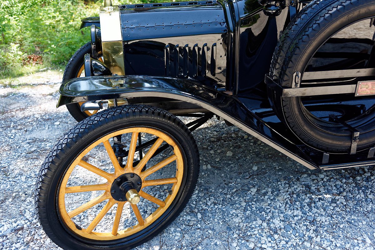

Very nice.
The only thing I'm seeing, the front hubs have been up graded to later ones, a change that I would leave as is, they are a stronger hub around the outer bearing.

That T presents itself very well !
One item I see is the generator brush cover - the gap where the retaining screw & nut is what should be straddling the cutout post - someone seems to have done a little handy grinding of the band for clearance !

Post by RajoRacer » Sat Jul 18, 2020 7:17 pm
The speedometer drive is "whonky" - it should be loosened up at the pinch point & rotated so the cable attachment point is pointing towards the rear of the car.

Post by George House » Sat Jul 18, 2020 7:53 pm
Beautiful anatomically correct touring. Only things I can add are super picky: the 4 manifold clamps on the ‘24 engine are the heavier ‘26-‘27 and installed upside down. And someone smarter than me on this Forum said Model T s never had brass top prop nuts. Also, the front top prop nut left side is missing....I said left side-not drivers side-just for you Allan

Post by Allan » Sat Jul 18, 2020 8:52 pm
Good one George. There can be no confusion with an international audience that way.
The only thing I could find, outside the 24 engine, is a common occurrence. The upholstery nails in the doors are way closer together than is usual. Restorers often do that. The usual gap between them is approximately 2 1/2".

Post by Steve Jelf » Sat Jul 18, 2020 11:33 pm
A lovely car, mostly correct as far as I can see. Exceptions are the "natural" wheels you noted, mostly a modern fad*, the step plates, and the modern hose clamps.
No manhole oilers are being made as far as I know, so my 1915 wears the brass twist oilers on the shackles and the "modern" flip tops elsewhere.
*All Ford wheels came from the factory painted body color until 1925 when varnished "natural" wheels became an option. I believe very few people ordered that option. Other than advertising, how many period photos show Fords actually wearing "natural" wheels? Mighty few, if any.

Post by Allan » Sun Jul 19, 2020 12:47 am
Jeff, the manifold clamps are on the correct way round for 1924, but they are 1925-7 items. The foot which rests on the manifolds is flat on each side, so the clamp can be installed either way, allowing the dealers to stock just the one part for any T. On the later cars, the manifold studs were shortened, [to save a cent or two?] and the new style clamps were installed In the opposite orientation to those on your car. These shorter studs had a rolled in ridge, up to which the studs were inserted in the block.
Regarding the upholstery nail spacing, in Bruce McCalley's book "Model T Ford" there are illustrations showing how it was done. They are not uniform, but generally there were 6-7 down each side and 5-6 across the top and bottom, the spacing often being somewhat random. There are clear photos on page 217 to show this.

Post by Bruce Compton » Sun Jul 19, 2020 1:05 pm
Wow, what a beautiful car. The only thing I can see looking specifically at the two front wheel photos, and it may be the camera angle or my 78 year old eyes, is the lack of caster. If you are driving this car at speeds above 15 MPH, then all is well, if not there is a chance that the axle is in backwards or the spring perches are on the wrong side. I saw this once before on a 1913 Hershey show winner after the owner quietly told me that he couldn't handle the car at speeds above 10 MPH. Anyway lets hope it's the camera angle or my bad eyesight.

Post by Jeff5015 » Sun Jul 19, 2020 1:51 pm
It might be due to the wheels being turned to the left. It handles quite well at 35. So, I suppose it's OK.
