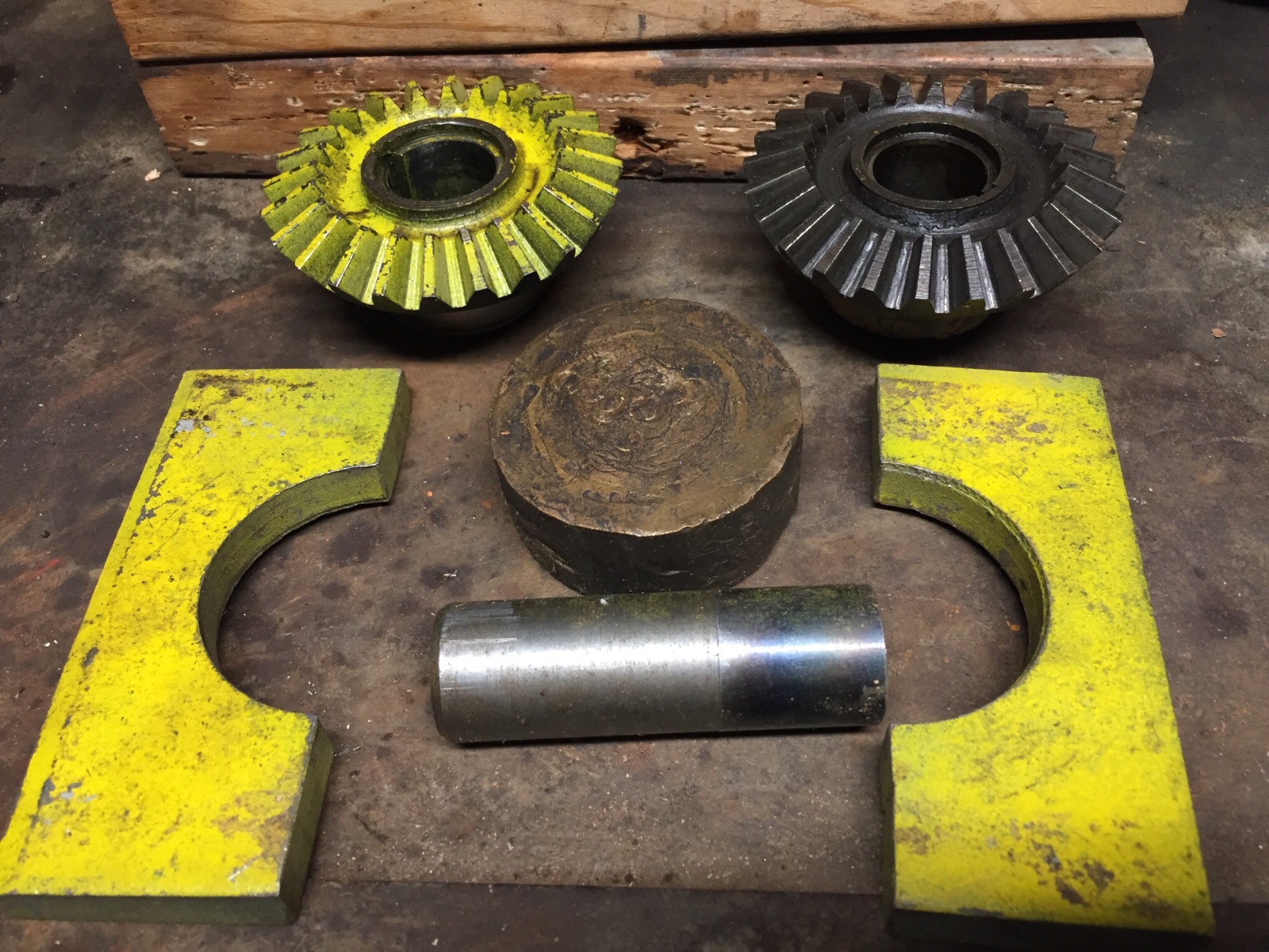

Chaffin's sounds like the way to go! I was just happy that they delivered the axles to Bakersfield last year.
Here are the tools I bought/used. I didn’t have instructions. But you can guess use. I used one gear to avoid the teeth or the gear that I was removing touching the base.
Matt
Matt

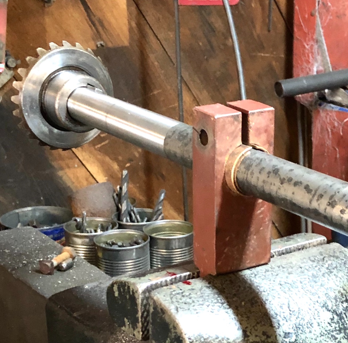

Pressing off the gear is two steps, but goes pretty well with press and fixtures.
Now putting on the gear on the new axle, without harming the taper end is the plan.
More than one way to skin that cat.
First try was to use a Model A hub for support to the taper, which was greased, and the Model A hub since it is different size would allow easy release. But the long shaft was hard to hold upright to get a good start onto the gear.
So did a switch and improvised a beefy split- clamp to secure the shaft higher up, with the clamp resting on the press bridge. That worked really well to get the gear on and down.....but...
just a little way. (note in photo you can still see 1/2 of the key exposed).
Seems when we added some WD-40 to the gear, that slippery lube ran down the shaft and made our makeshift shim stack of brass in the clamp slip, so wouldn't hold the axle up.
But easy fix, wiped clean with lacquer thinner, and added a longer grade 8 bolt to the hole in the split- clamp, and tightened that up firm on the new axle shaft. That did the trick! This improvised split-clamp held amazing, and back on the press the gear was fully pushed down to expose the key groove.
Improvised split-clamp holding fixture on axle shaft

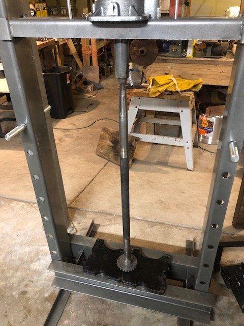

This is what I did in order to salvage some nice gears that were mated to bad axles.Kevin Pharis wrote: ↑Tue Jul 21, 2020 1:59 amIf you saw em off just behind the gear (band saw... not hack saw!), the axle stubs pushes right out. And this way there’s none of that “shoot outa there” paranoia![]()

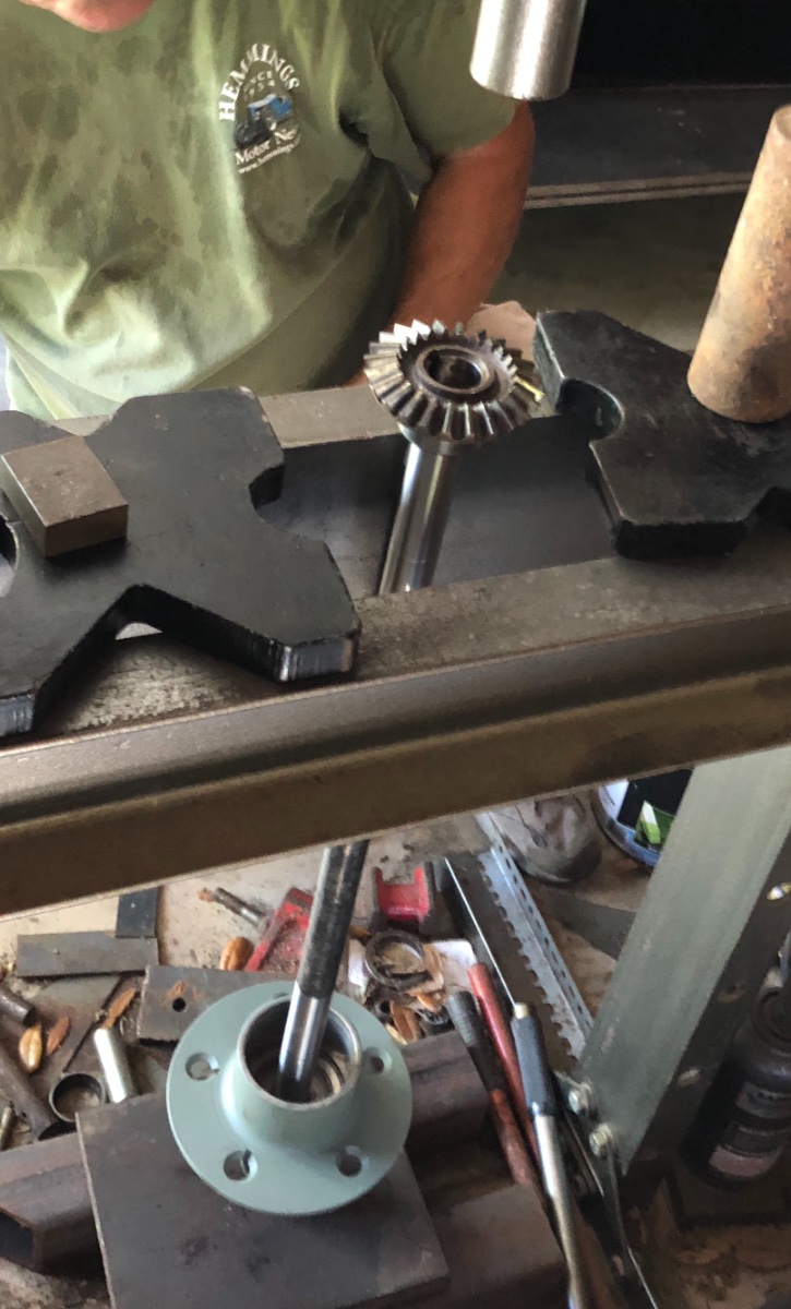

I used a model A hub with an axle shim to hold the taper to press it. I made a hollow spacer to fit inside teeth.
