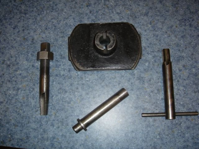

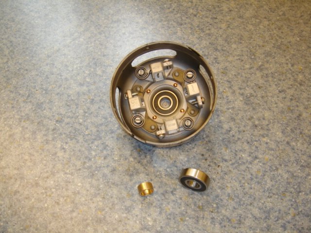

That Babbitt bushing is factory number T-1759 and was used in the Model T starter brush cap.
It was a common starter problem for several reasons. After factory installation where something very similar to Lubriplate was added there is no provision for further periodic lubrication. You commonly see starter brush caps modified for periodic oiling. When servicing the starter using this NOS part is difficult if you do not have the proper tools. The Allen Electric starter repair kit included a special driver and align reaming tool.
It is not clear why Ford used a Babbitt bushing in this application. Babbitt is great for radial loads, but not axial wear from the starter armature wearing into the face of the Babbitt eventually causing excessive armature end play.
The brass bushing sold today by Model T parts suppliers is a problem for the same reason; needs special tools for installation and no provision for periodic lubrication.
The best repair solution to all these problems is the one Dan Hatch commented upon and is a pre-lubed sealed ball bearing and spacer to entirely replace T-1759. Because of the low duty cycle of the starter that adapted modern solution will last another 100 years.
