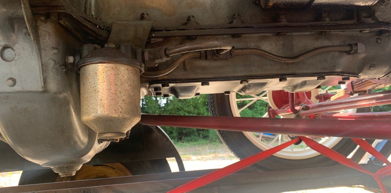

Just acquired a 1927 Speedster. The previous seller bought it on eBay, five or six years ago, and all he could remember was that it came from California and had been "renewed" in the 1990s. It has a custom trailer with tandem axles.
I am looking for any information about it? Who owned it? What upgrades, especially the engine?
The features,
12 volt system
Edmunds and Jones Type 20 headlights
Canadian engine
dropped front axle
Z'd frame
Double Solex downdraft carburetors
Atwater Kent Distributor (problem and replacing with Bosch)
Foot and hand throttle
Ruckstell axle
Speedo
Oil pressure gauge.
White with dark red undercarriage
Burgundy leather bucket seats.
Electric Fuel pump with regulator
Rootlieb fenders and running boards.
I am sorting it out so I can drive it.
There is a spark at the points, but does not transfer to the plugs. The center part of the distributor cap is worn and may not be connecting. I don't get a spark from the coil. Apparently Atwater Kent parts are no longer available. So I have ordered a Texas T (Bosch) Dist, plug wires, 12v coil and plugs. Taking the lazy out and going solid state.
Hope to have it running soon.

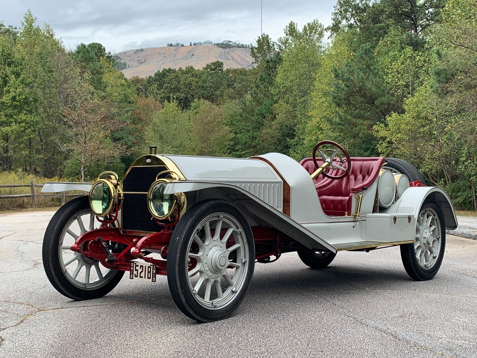

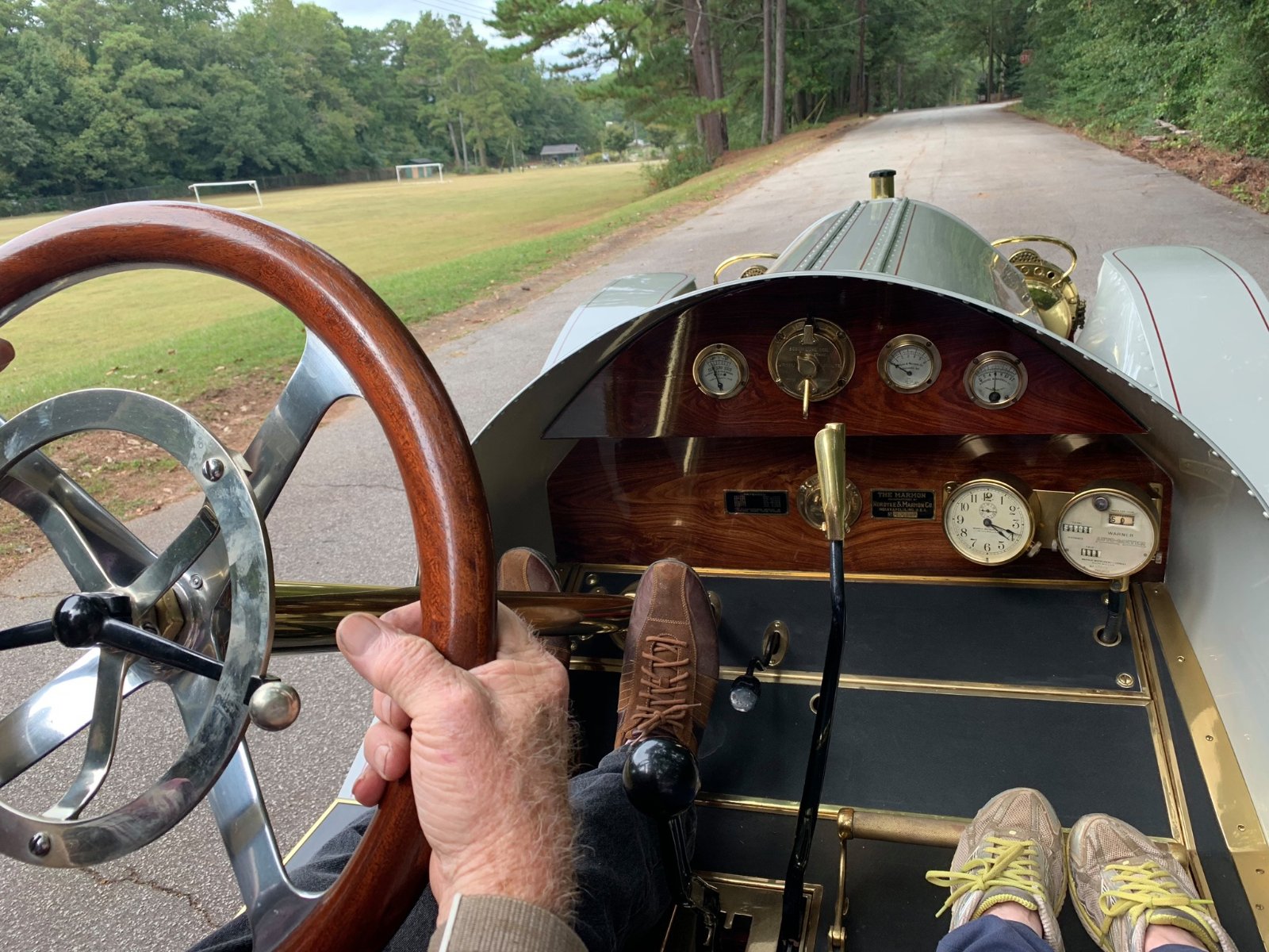

1913 Marmon Speedster 48B. 9.3 liters. Burgundy undercarriage like the Model T. Burgundy bucket seats. Front fenders. Big Brother

They're both pretty cars.
Those big, more upscale cars from that era always draw such a stark contrast to the T's. They must've been impressive beasts to someone from the country who was used to seeing Model T's and the like.

Bill M. - "A cow & a calf"!
Maybe a poor analogy, but a calf really is a lot more nimble and energetic that a cow,...so,.....maybe NOT such a poor analogy after all!
A real beauty Bill, and I'm betting that you'll eventually be driving the "T" speedster a lot more than the Marmon!
