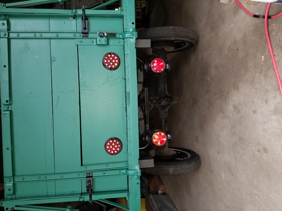

The weight is a factor. Maybe I need to think about a rack that the tires slide in from the side. The tail lights are in the way to the rear. Moving the lights outboard of bed runners may be an option also.

Dallas, can you reverse the brackets and make them swing outboard instead of inboard? Would that provide enuf room, and still keep the look?

Post by Dallas Landers » Thu Jul 30, 2020 9:31 pm
Dave, I have to do some measuring.
