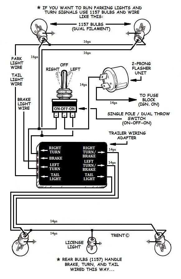

It would help to see what the components you have are and/or how you have things wired now. I assume that the taillights are double contacts.The first diagram is the general wiring using a black box (trailer), second diagram, that takes care of making the tail light brighter when you step on the brake. You may not need this - don't know what you have. The last one is for '26 T. If you show me what you have I can help.
Taillight Converter Box.png (9.63 KiB) Viewed 8234 times
Also your flasher needs to be for LED lights. Suggest you work on the turn and brake lights first then the turn signals. LOL Frank

What is the part number of the trailer converter in the above diagram and will it work on 6 volts?
Jerry

Jerry Young wrote:
Thu Jul 30, 2020 9:39 pm
Jerry
I don't have a part number since I bought a kit from one of the vendors. But, go to etrailer.com and search for a universal converter, not a model-specific converter. They have the 4-in, 3-out converters that don't require a 12V power wire.
