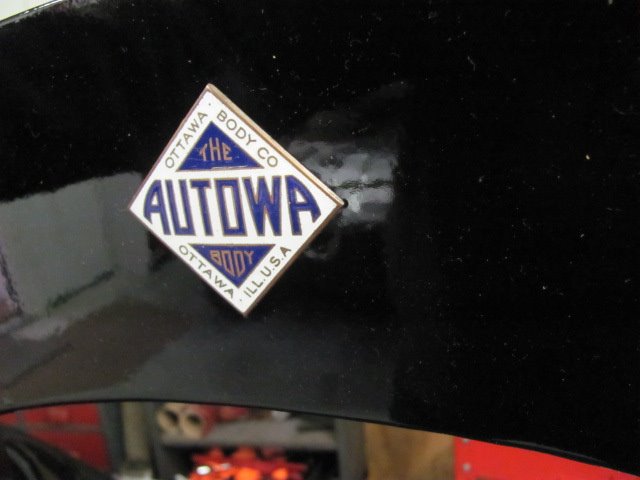

Just me, but I wouldn't trust silicone adhesive for such a rare piece. As silicone adhesive can age and the heat alone at that spot on the radiator would make silicone adhesive for long term in that vibration spot a suspect.
The extremely rare emblem off this shell was originally held just with rolled metal edge in a circle, it was loose over time too, so pried it off to refinish the shell. Installed the cloisonné emblem back in place using J-B Weld. Can trust J-B for this preservation. ;)

Greg
Good comment, on this shell the area around the circle was masked from paint, and circle of J-B Weld placed on emblem, plus some around the rim of the emblem on the inside of the shell.
