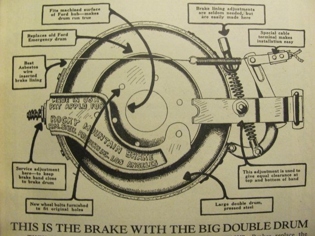

Original Rocky Mountain Brakes are pictured above. I have them on all of my cars. The current Rocky Mountain Brakes are not Rocky Mountain at all, and I believe the outside diameter of the drum is less than the original. The bottom line is, if you are going to make a reproduction, do it correctly, or don't do it. The first issue brakes were close, but the owner of the company didn't do his research as I have, and used a Bennett brake equalizer, which works in the opposite direction than a true Rocky Mountain. It pays to do your homework when reproducing something, but many in this hobby don't do that!

- Posts: 5539
Re: Ad-on brakes
The current Rocky Mtn brakes ARE copies of the 1926-27 AC brakes. The 1926/27 AC brakes didn't use the center anchor point. While I still have 30X3-1/2 on the front of my 1921(still original steering ratio), I went with the big drum and Rocky Mtns on the rear with 21" wheels to get more rubber on the ground. Have 3 braking systems; parking, RM's and transmission. I made my own equalizer that works independent of the parking brake. I did use a set of original AC small drum brakes on the 21 before putting the big drum setup on for a while, they worked good. Those AC's cable activated brakes are now on a friends roadster, still working good. The 25 is getting a set of Bennett shoes as soon as I repair and reline them.
