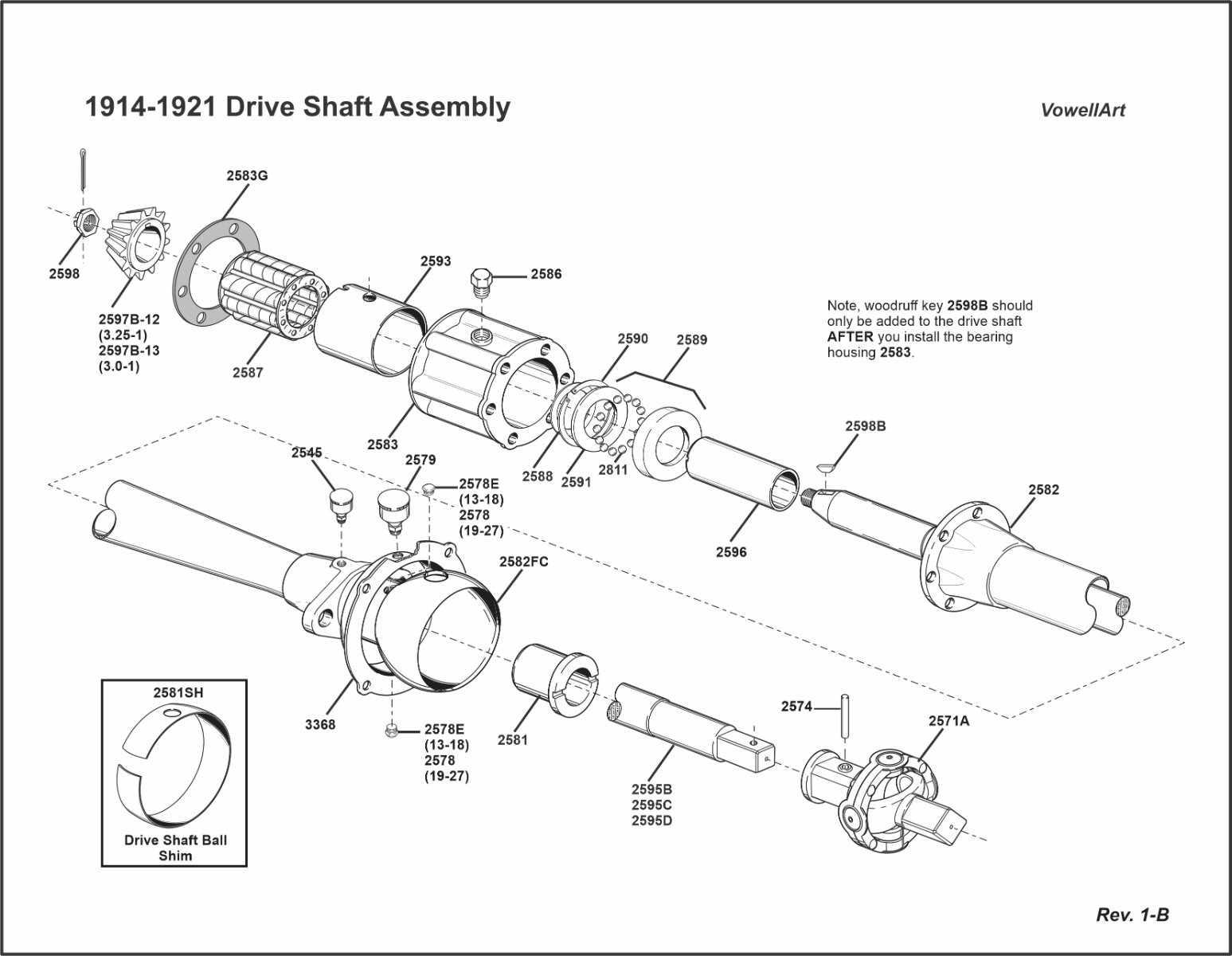

***1914-1921 Drive Shaft Assembly***
- Posts: 2948
- Last Name: Hjortnaes
- Location: Men Falls, WI
Re: ***1914-1921 Drive Shaft Assembly***
2586 does not exist on my cars
please include bolts that go into 2583
Otherwise it all looks good.
- Posts: 5497
The 2586 would have been used on all closed spool housings. It retains the pinion bearing sleeve. 1921 back would have used studs not bolts.
Edit re 2586;
Except the early housings that were babbitt.
Edit re 2586;

- Posts: 3901
- First Name: Larry
- Last Name: Smith
Since when does the cast iron housing use bolts? They use studs and castle nuts!

Topic author - Posts: 584
- Joined: Sun Jan 06, 2019 8:44 am
- First Name: Martynn
- Last Name: Vowell
- * REQUIRED* Type and Year of Model Ts owned: 1922 Touring, th "Lady"
- Location: Sylmar, Commiefornia
- Board Member Since: 2012
Small change
The reason for this change was because to show the differences between the 1918 and 1919, I'd need to draw a completely new drawing for those small plugs that cover the pin holes for the U-Joint. Just didn't think it was worth it...so I made a notation instead.

- Posts: 3901
- First Name: Larry
- Last Name: Smith
Like everything else, do your research before posting on the forum!
- Last Name: Vowell
Larry, that's exactly WHY I do post to the forum. My research is limited, you guys know a hell of a lot more than I do, sooooooo, I post here, so you and everyone else can help to make them correct.
