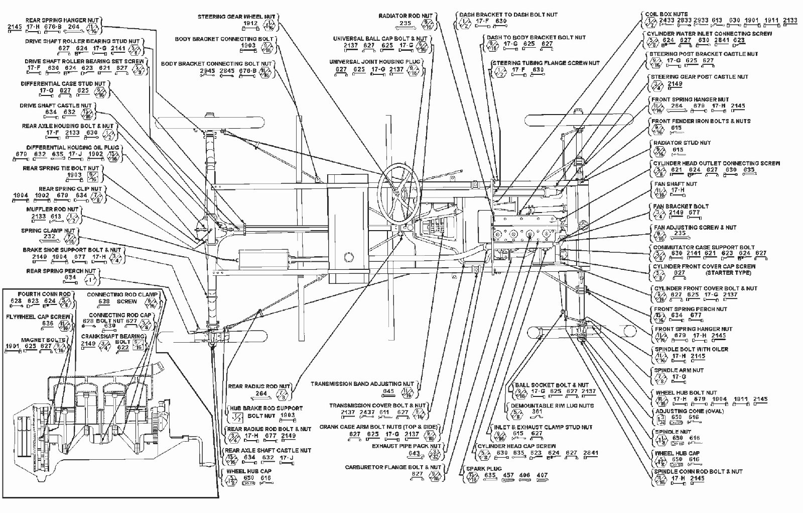

This is a link to an earlier discussion this year and contains a spreadsheet of nuts & bolts by application https://mtfca.com/phpBB3/viewtopic.php? ... eet#p90892 (right click on image to enlarge it)
You could also use this diagram to make your to make a list
