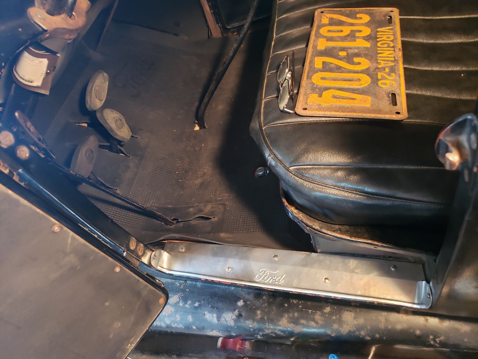

I just completed this chore on my 26 Touring but used aftermarket sills. My holes were mostly stripped out on both the front and rear sills. Where I could, I simply used a nut and screw. Some nuts I had to use EZ Turn on the tip of my finger to hold the nut and get the threads started. Took a lot of mechanics gymnastics. I believe the frame is drilled and tapped for #10-32 threads. Some of my front holes worked without nuts. A few holes where a nut wasn't possible, I bought a riv-nut tool to set in some new threads. Under the front seat pan I had to buy a small riv-nut tool you can see in the pics. If you need a positive ID on the threads and more info on the riv-nut tool, let me know. I used oval heads rather than flat.
The aftermarket sills required some mild cutting and bending to fit right.
Good luck!

Oh, I ordered from Bolt Depot and also got stainless steel screws.....
By the way, EZ Turn is sticky and great to start hard to reach nuts.
