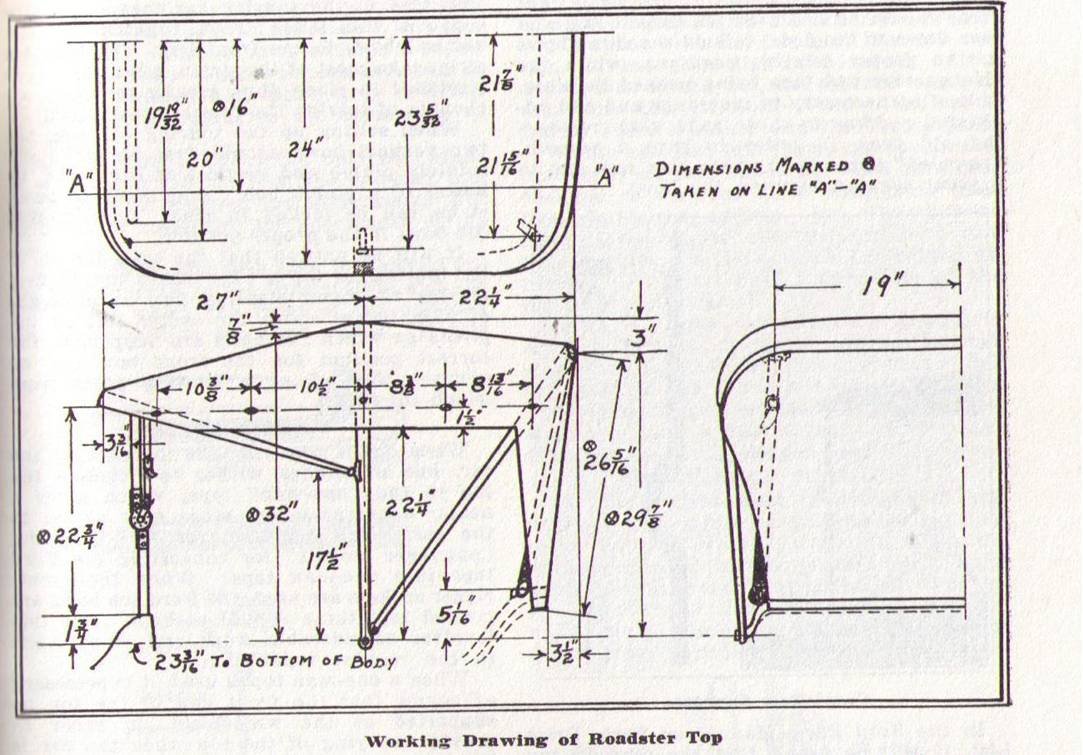

I need to know how far the top bows extend above the sockets for a Roadster. I did a google search for the info I need but didn't come up with anything concrete. There is a drawing which has been posted many times which gives the total length for the socket plus bow (32-7/8") for the middle bow, but not the front or rear ones. Does anyone have that info in your notes? Thanks.

Only have this info gleaned off the forums past. Nothing specific have seen on the '15-'16, but this may help you.
’17 Roadster round/ oval socket iron
Bows are 47 1/2” wide. Front #1 bow protrudes 7 ½” from iron, Middle #2 protrudes 7” and Rear #3 protrudes 8 ½”
’13 – ’14 Touring Most are similar, some vary
Wood bows 53” wide. Front #1 bow protrudes 7” from the iron, # 2 protrudes 9” #3 protrudes 6 ½” and Rear #4 protrudes 6 ¾”

Mike, on the 1913 roadster, the amount the wood is driven into the sockets (Ford called it the "drive", logically enough) is 6" all the way around; front, upright, and rear. I believe the 1917 oval sockets would be the same. Hope this helps.

John Regan posted some detailed information on the 1915 runabout top at: http://www.mtfca.com/discus/messages/29/23098.html I have reposted that here: While he does not share how far the wood bow goes into the top socket, he shares lots of other details there.
++++++++++++++++++ John Regan's post is below +++++++++++++++++
By John F. Regan on Sunday, January 07, 2007 - 04:13 pm:
Clarance:
The following dimensions taken from FACTORY DRAWINGS of 1915 Roadster top:
Front bow:
Center of iron pivot point to INSIDE front wood surface of front bow is 26-1/2". This is measured along the iron which is of course sitting at an angle. The bottom most edge of that front bow wood should be in front of the windshield and sitting 1/4" lower than the very top most edge of the windshield tubing and if all is correct then that same bottom edge of the front bow should be sitting 3-3/16 in front of the front edge of the windshield tubing.
Center Bow:
Center of Body iron Pivot point to bottom most flat surface of center bow is 32".
Rear Bow:
Center of rear bow iron pivot point (where is joins the center bow iron) to bottom surface of rear bow is 34-3/4" That rearmost bow wood edge sits 3-1/2 behind seat rearmost edge. To confirm that location further - the rearmost edge of the rear bow should be 29-7/8 above the center top iron body pivot point (not the rear bow pivot point). The bows are 7/8 thick typically and thus the topmost surface of the center bow should end up 3" taller than the rearmost edge of the rear bow. Since bows are rectangular in cross section. Each of my dimensions calls out the correct EDGE of that rectangle if it is sitting as it should be since then angled bows have a topmost edge, bottom -most edge, front most edge, and rear most edge.
Front bow is DIFFERENT than the other 2 bows. The bows typically have a slight crown in the center. The front bow is different in that it has a larger RADIUS than the other 3 bows. Typicaly repro bows are a set of 3 with ALL alike so you will need to take that into consideration when trying to fit the front bow. Because the front bow is sitting almost horizontal then it is intuitive to me that the front bow needs a larger radius at the corners so that the curvature of the top material will then match the shorter radius of the next 2 bows. Placing a bow at an angle essentially makes its radius to the sides much smaller and that is the reason that original tops fit better at the front than repro in my estimation.
To PRE-ANSWER a question - NO I will not provide a copy of the factory drawings to anyone. This is simply because as an engineer I respect the intellectual property rights of the Henry Ford Museum to these documents and have signed an agreement there to NOT copy their documents. To provide copies would endanger my agreement with them that I signed and they could bar me from further research there and that would be a catastrophy for me since I love to research.
+++++++++++++++++++++++ end of John's posting ref dimensions of the roadster top ++++++++
You mentioned the illustration below by Murray Fahnestock that has been posted several times:
If you know someone that is good with trigonometry/math -- they should be able to tell you the length from the center of the upright to the front of the front bow and the same for the rear bow. With the distance of two sides known and the 90 degree angle it was easy for me to figure that out about 50 years ago. But not so much today.
However, if you mock up the top sockets, with the bows, with the car -- you should be able to mark a good starting place for how far the top bow should go into the top socket and have the dimension which are given in Fahnestock's illustration come out correct. Then you can work the top bows and fine tune the measurements with the top bows inserted into the top sockets.
How to mock it up? See Bob Cascisa's method at: http://www.mtfca.com/discus/messages/80257/93079.html and the photo of how he did it is shown below:
That takes a lot of clamps -- and you may need to use string to tie the uncut bows to the side of the top sockets. There will be some adjusting to get it correct. Good news -- you are working with a roadster so doing the front and then the back -- the center top socket stays vertical.
And if the body was rewooded, be sure the pivot point is correct -- again you have seen this illustration before:
Hopefully one of the folks with a 1915-1917 oval socket roadster will give you some additional measurements.
Respectfully submitted,

Hap -- Thank you for your post. There is lots of good information in it, as is the case with all of your posts. John R. gives the overall lengths of each iron + bow, so it's easy for me to ascertain the point at which I need to fit the bow into the socket. And thanks for the link to Bob C's very informative thread. I did woodwork for 40 years+, so I have lots of clamps. :) I now feel confident in moving forward with the rest of the work.

Armed with the numbers in John Regan's post, I forged ahead. Since his numbers are to the bottom face of the bows, I clamped a 4' level even with that edge to use in making my measurements. That worked quite well.
