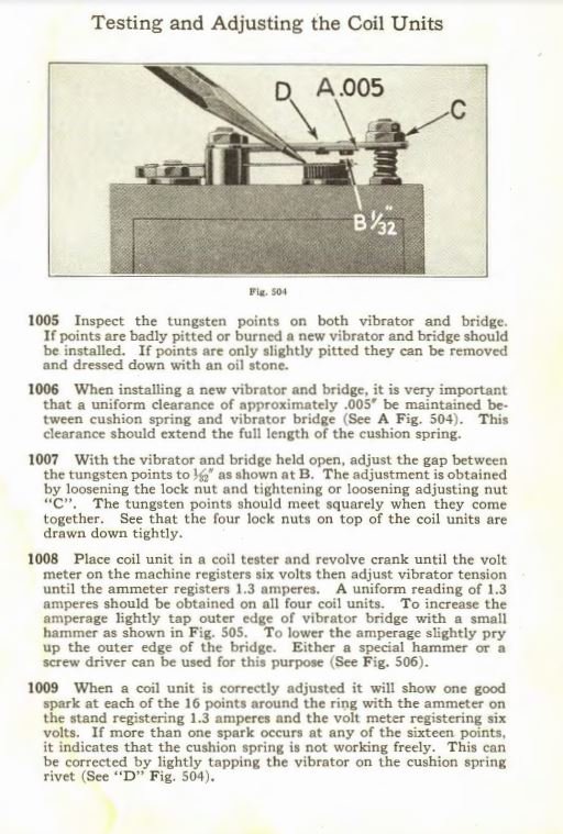

We missed the Christmas parade one year because we added more gas than Blackie's gas tank was used to having. The crud & rust from the tank stopped up the gas line. It varied in how long it took for the car to start starving for Gas. And back in those days, I just opened the carburetor drain valve and saw that it was dripping really slowly - not enough to keep the engine running. EPA might not think that was a good idea today. Sorry, I don't recall what year TT you have. So I posted a link to the 1925 Ford Service manual with the repair tips for running poorly located on page 237 see the link at: http://www.cimorelli.com/mtdl/servicemanual/default.htm ..
From that 1925 Ford repair book the following pages may be helpful:
Note I sometime have problems getting the pages to post in the order that I would like. So there will a couple of posting with one attachment to each.
And see also the index for other things like rebuilding a carb etc. No it doesn't cover True fire.
Respectfully submitted,
Hap l9l5 cut off
By the way -- did it used to run good and then you installed the true fire and you had the problem? Or it ran good and you changed something else and then it ran poorly?

Re: Surging after about 15 minutes of run time
Post by Hap_Tucker » Sat Sep 05, 2020 9:30 pm
