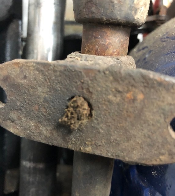

- Posts: 4047
Re: Handbrake cross shaft
Correct in earlier cross shaft brackets with square like recess for felt plug.
The later ones with round hole. But that hole also used a cylinder of felt too for oil wick.
Here is original, used a pick to pull away the old dry felt!
- Posts: 7146
Dan, I had presumed that to be rusty accumulated crud in any I have pulled. I'll have to be more observant next time.
Thanks, Allan from down under.
Dan is correct. I read somewhere, maybe a parts book(?) a long time ago about those holes. My (Dallas's) '23TT and my '25 coupe have the round holes. I made new ones with a cheap hole punch and some leftover felt from some project. ( Really quite a technical project!)
What does the felt do? I see those holes in my 26-27 frame and wondered if I should put a zerk fitting and a grease gun. Thanks for the clarification.

- Location: central MN
Felt keeps the dirt out whilst being oily for the moving parts. Unless fully yucked-up with dirt-rust.
I broke a shaft mount because it was rusted securely.
Welded it back together and went on.
Hmmm, I have felt and scissors.
Why the heck haven't I re-felted those holes?
Cotton waste would work too. Lightly stuffed down in the hole so the oil will get there also.
