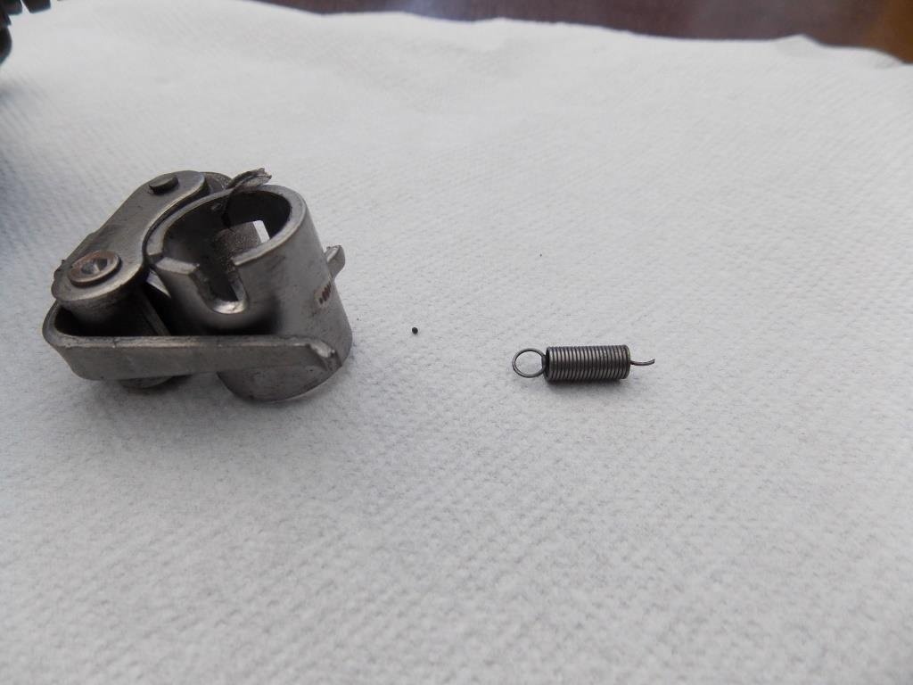

Yesterday during the home ride after ice cream at about 3 miles from home my car start to run as crap.
This morning I found why.

I've seen that. They run on 2 cylinders, the bottom 2 on the timer. The time I was following the culprit there was a loud backfire.

Re: It run as crap.
"For want of a nail, a shoe was lost . . . "
Easy fix though ! No wonder wise heads say "Check the timer first !"

Re: It run as crap.
Good catch, also easy to put together backwards,after repair or during installation. Ah the wonderful timer....
