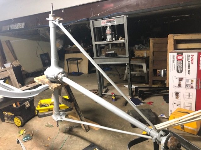

You can flip the drive shaft tube over. As you can see from this picture: download/file.php?id=65457&mode=view the drive shaft tube is upside down. I turned it back over: Take the bolts out of the spool, take the radius rod bolts at the differential off. Put 2 smaller bolts into the spool at the differential to fix it in place leaving the other end of the spool/drive shaft tube loose. You can then rotate the drive shaft. If you are worried about the gasket getting bunched up or if it does get bunched up remove the pin from the u-joint and temporarily remove the u-joint. The drive shaft tube will slide up the shaft and give you room to rotate or take it all the way off and replace the gasket while flipping the tube over.

Post by Its_Always_T_Time » Wed Sep 30, 2020 12:54 pm
By flipping I mean the grease cups are facing towards the floor and I want to flip it back so it's facing the sky.

Post by DHort » Wed Sep 30, 2020 9:47 pm
Greg. When you flip the rear axle in this instance, you are really just turning the drive shaft tube 180 degrees and leaving the axle in place.

Post by ivaldes1 » Wed Sep 30, 2020 9:55 pm
Yes I made the same mistake just recently on Hay Wagon to Speedster Project. See my description above for a way to flip it back over.

Post by Fordwright » Thu Oct 01, 2020 12:06 pm
I never understood something about over-greasing. If too much grease will break the seal, how did the grease escape?

Post by Mark Gregush » Thu Oct 01, 2020 12:47 pm
The U-joint housing does not have any seals. So grease can and does flow past the driveshaft bushing down the tube, around the bell or into the engine, but mostly around the bell. Any oil getting past the 4th main washes it out too.
