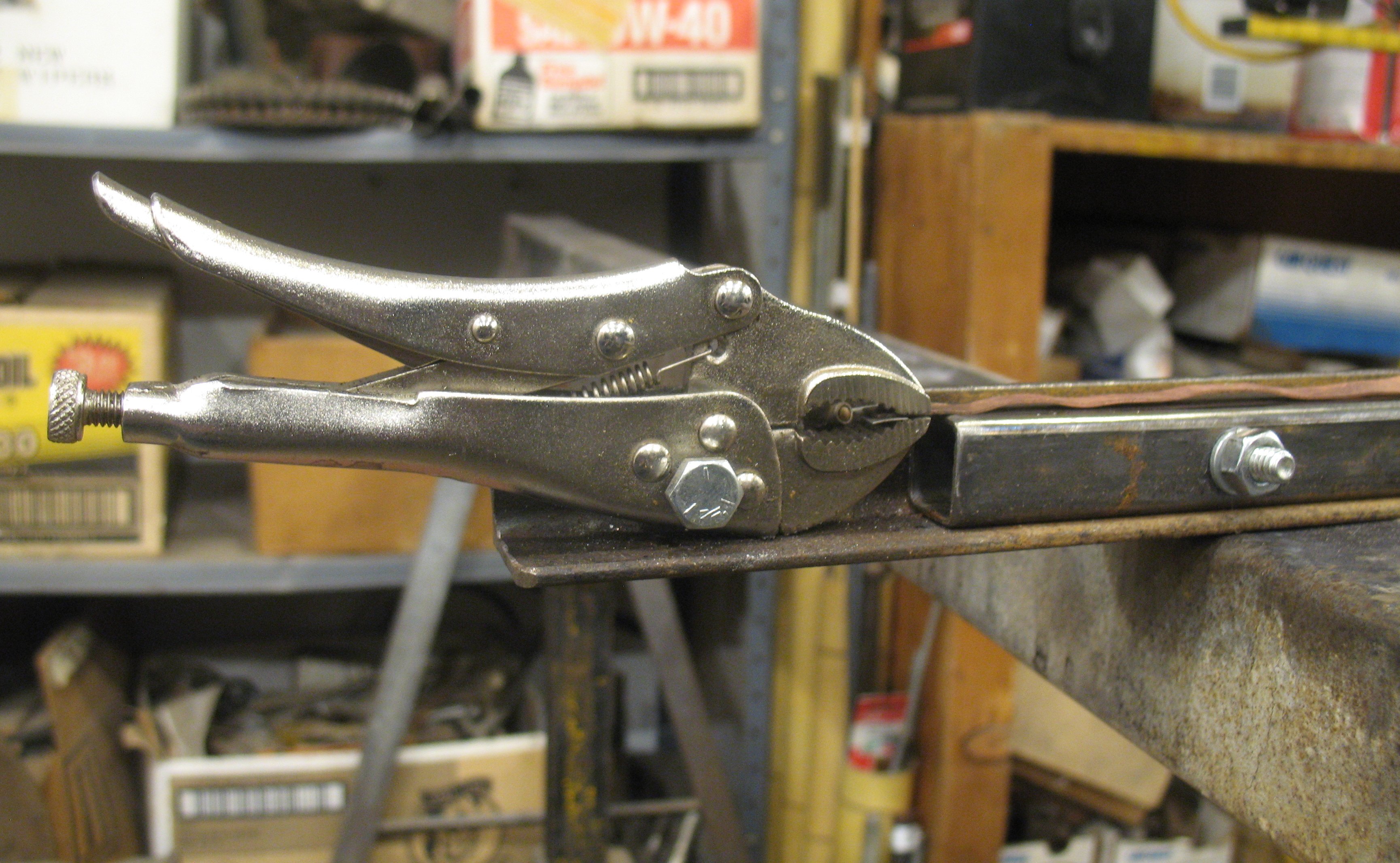

Today I finished straightening mag coil ribbons.
The outlay for my straightener was under $20. I paid $5 each for the two locking pliers, and $7.77 for the square tubing. All the other parts are stuff I had on hand.
The square tubing serves as an anvil if the ribbon has a spot that requires flattening with a small hammer. That's mostly not needed. The stretcher pulls the ribbons pretty straight.
Some of the ribbons had a few rough spots that needed filing.
The final step is wire brushing to remove any little bits of old insulation that may have survived the cleaning.
All 32 ribbons straightened and ready for new insulation and rewinding into new coils.

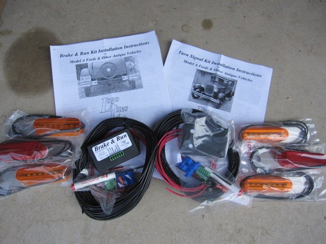

Got some stop/turn lights mounted to the bumpers, hope to finish wiring tomorrow. Nice kit from Logo Lites in Duluth GA, great installation instruction and nice quality parts.
www.logolites.com
Got the LED's in as well today, big difference from the available China glass bulbs.

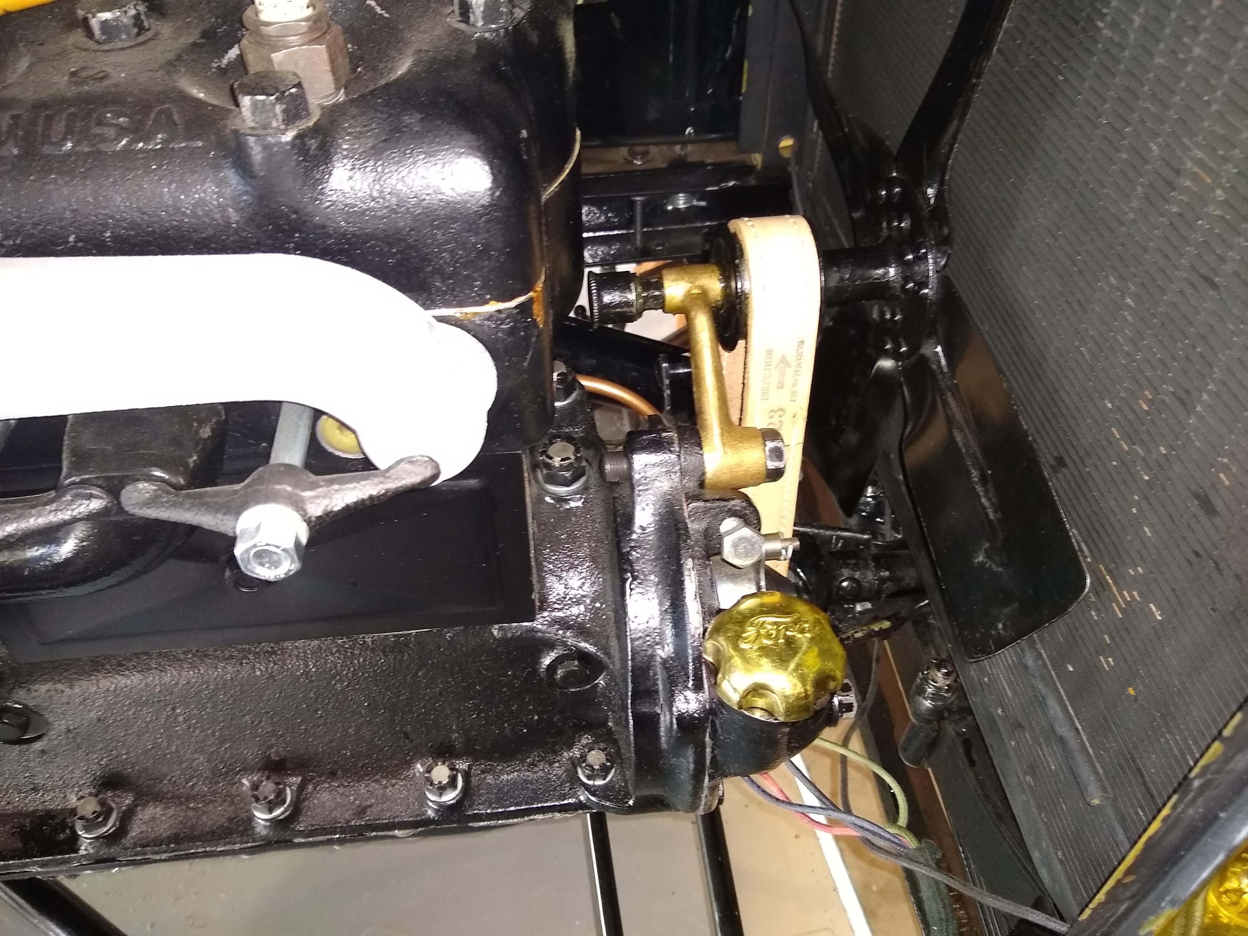

Last spring when I finished restoring our 15 runabout, I reinstalled the leather fan belt that came with the car because it appeared to in good shape. However, when tightened it, the belt was right up to the big bolt holding the fan onto the engine. That didn't look right, so I finally got a new 23" leather belt and installed it, along with a new arm because the nub that the tightening bolt was worn. Now it clears everything, as it should! I was surprised how much the old one was stretched - over one inch longer. No wonder it wasn't fitting right. It also was starting to fail at one spot on the inner surface.
I also installed one of Tim Morsher's RAJO oil gauges, which I think looks cool if anything. Last month I installed his replica gas gauge, which is nice to have too. I've been still dipping the tank to see how well it compared to the 'stick'. The last tick mark before empty is 2 gallons for my round tank, which is as low as I like to let my tank get.

Beautiful 15 ford engine compartment. One question is the bolt that holds the fan arm on missing the cotter pin behind the timing gear cover? I have seen those bolts back out and destroy a brass radiator. Just trying to save a catastrophe.
Yeah, that's a good catch. Thanks. I just put one in. I don't want my nice Brassworks radiator chewed up! I also checked our 21 touring and it was also missing a pin in the fan bolt, so I added one there too!

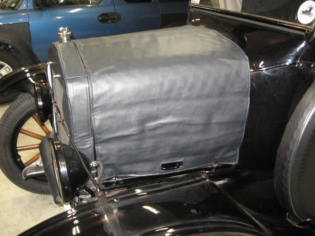

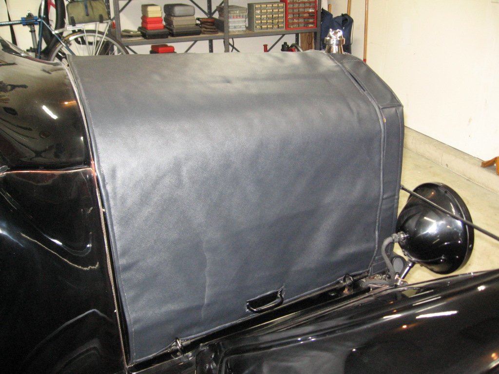

I pulled Betsy's winter front and hood blanket out of storage and installed them on the car today. A little early, but the winter front flap exposes the entire radiator opening when it's rolled up, so theoretically it could stay on year round. The camera flash makes the vinyl look gray, but it is black to the naked eye. :)

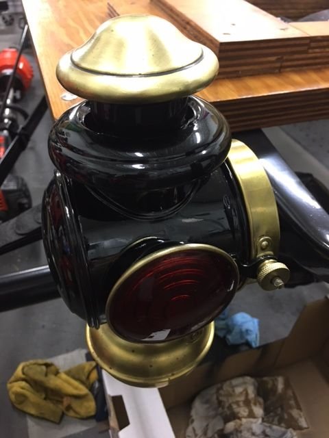

Finished several items this week for my stock 1914 speedster: Tail light, monocle glass. and Disck wheel. I hope making my first fire-up engine gine this Sunday!

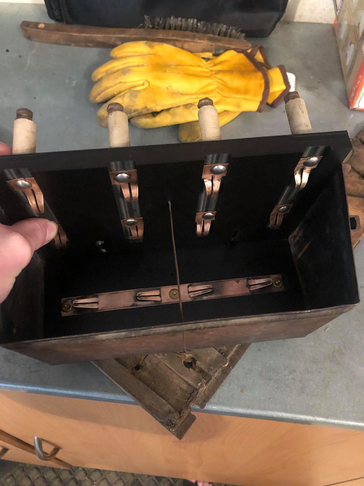

Made some good headway on the coil box. Won't be finished until I get a new soldering iron

I would not suggest doing any soldering with the parts assembled. The stuff is water proof but not sure how soldering iron proof it is.

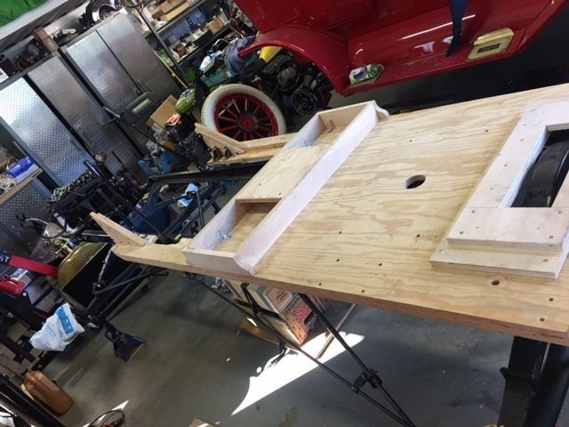

This is where we were at the end of October.
Lower body mainly finished except the floorboards over the transmission.
Getting started on the roof for November.
