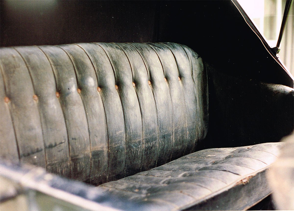

Re: HELP! Can Get some pics of interior upholstery from 26 or 27 Touring please?!
Here are some I took of an original. Other will have better I'm sure.

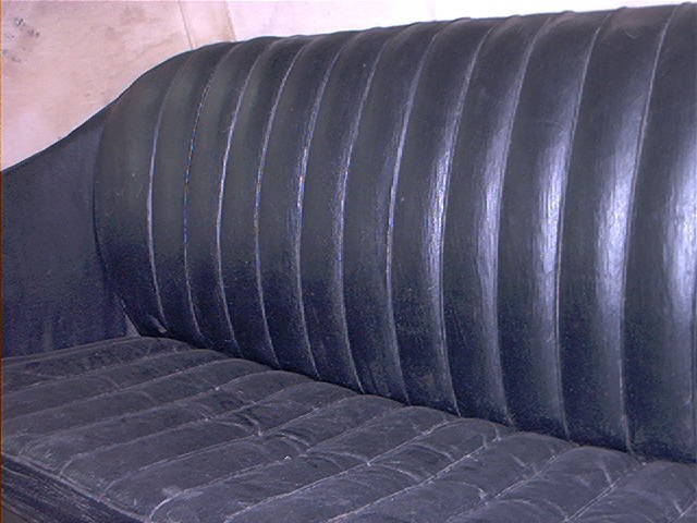

One more of the original and one of a freshly installed kit.

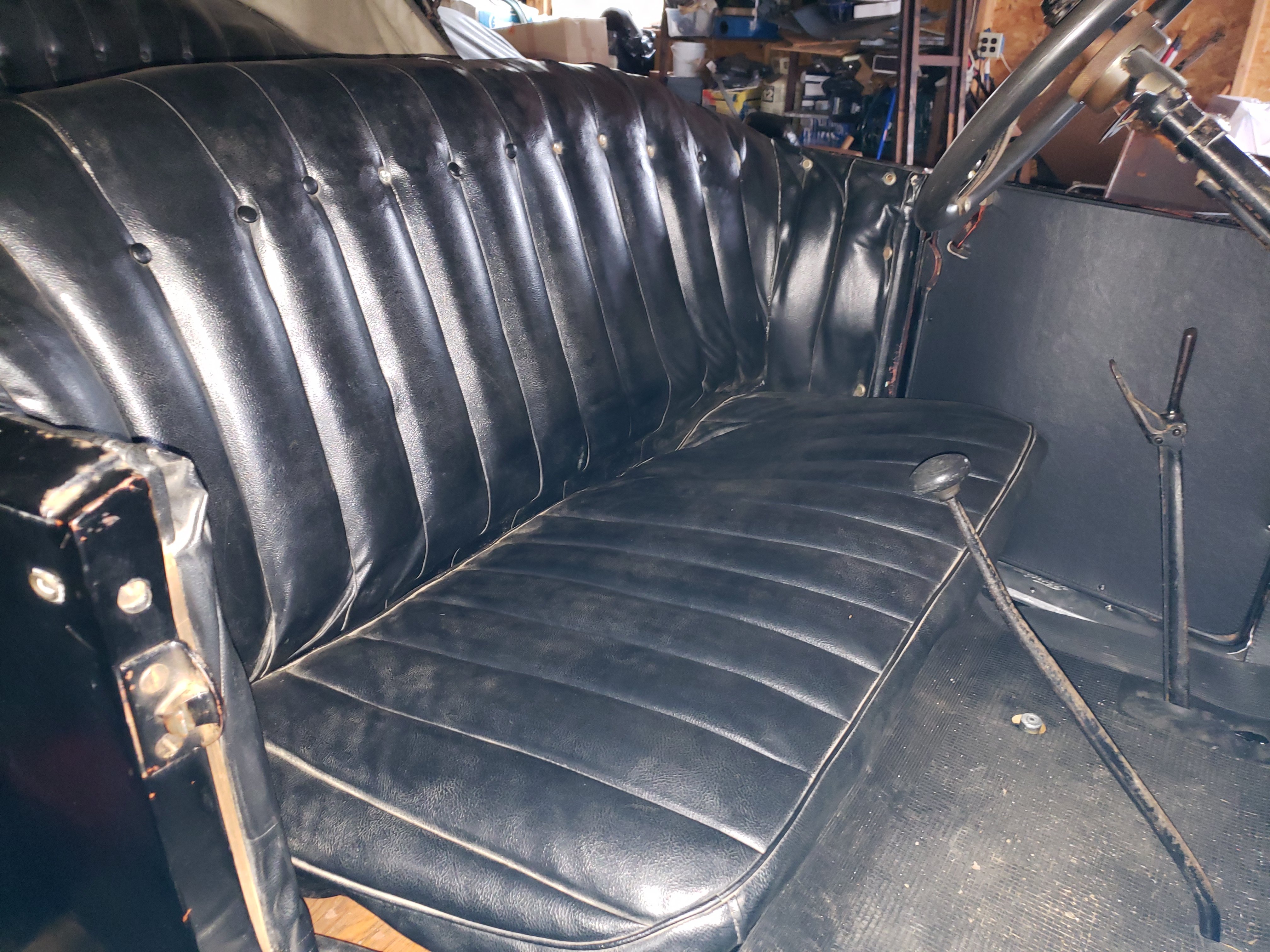

Does this look correct?
The seats were from a coupe.
Here's my 26 Touring.
