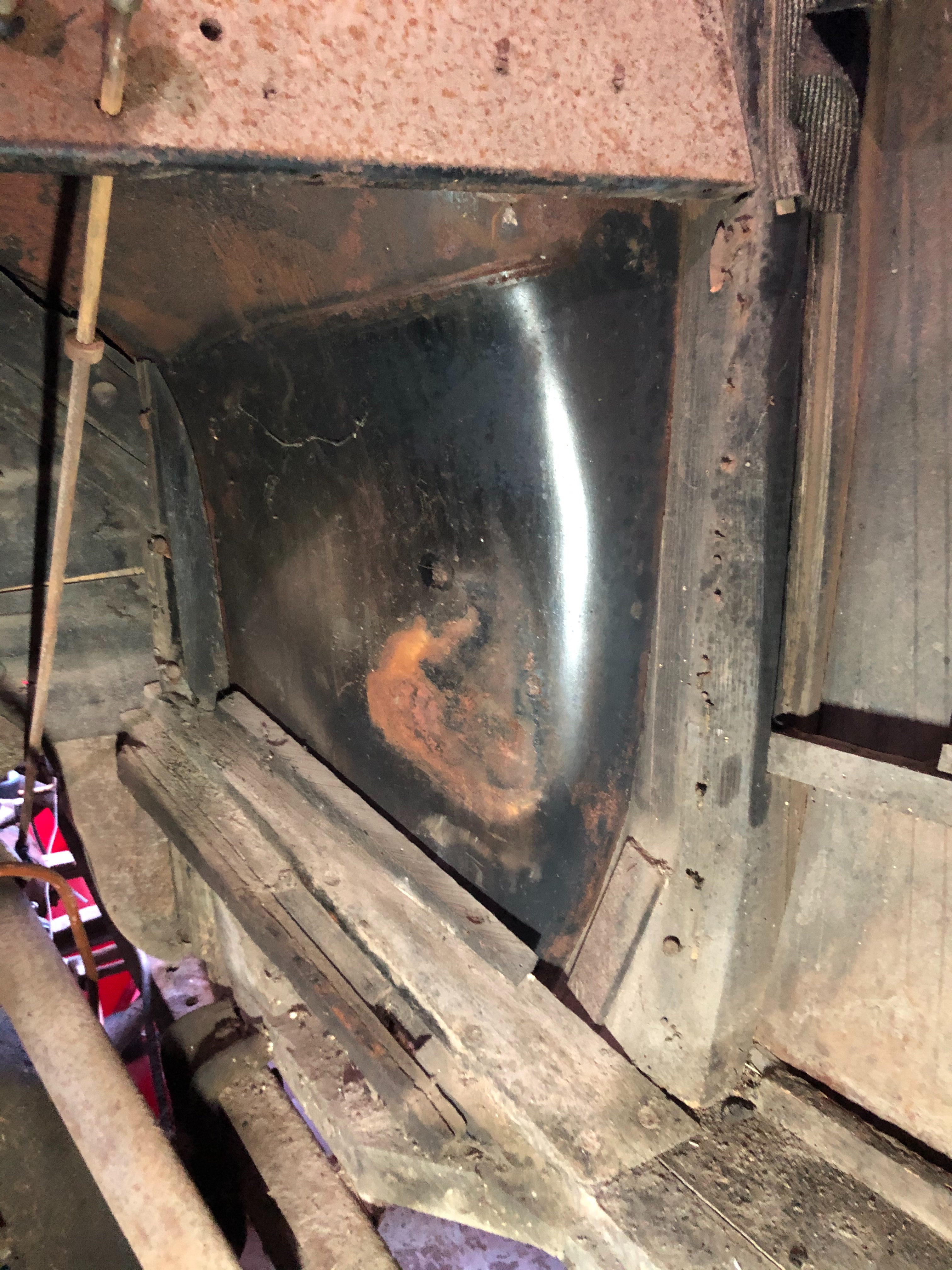

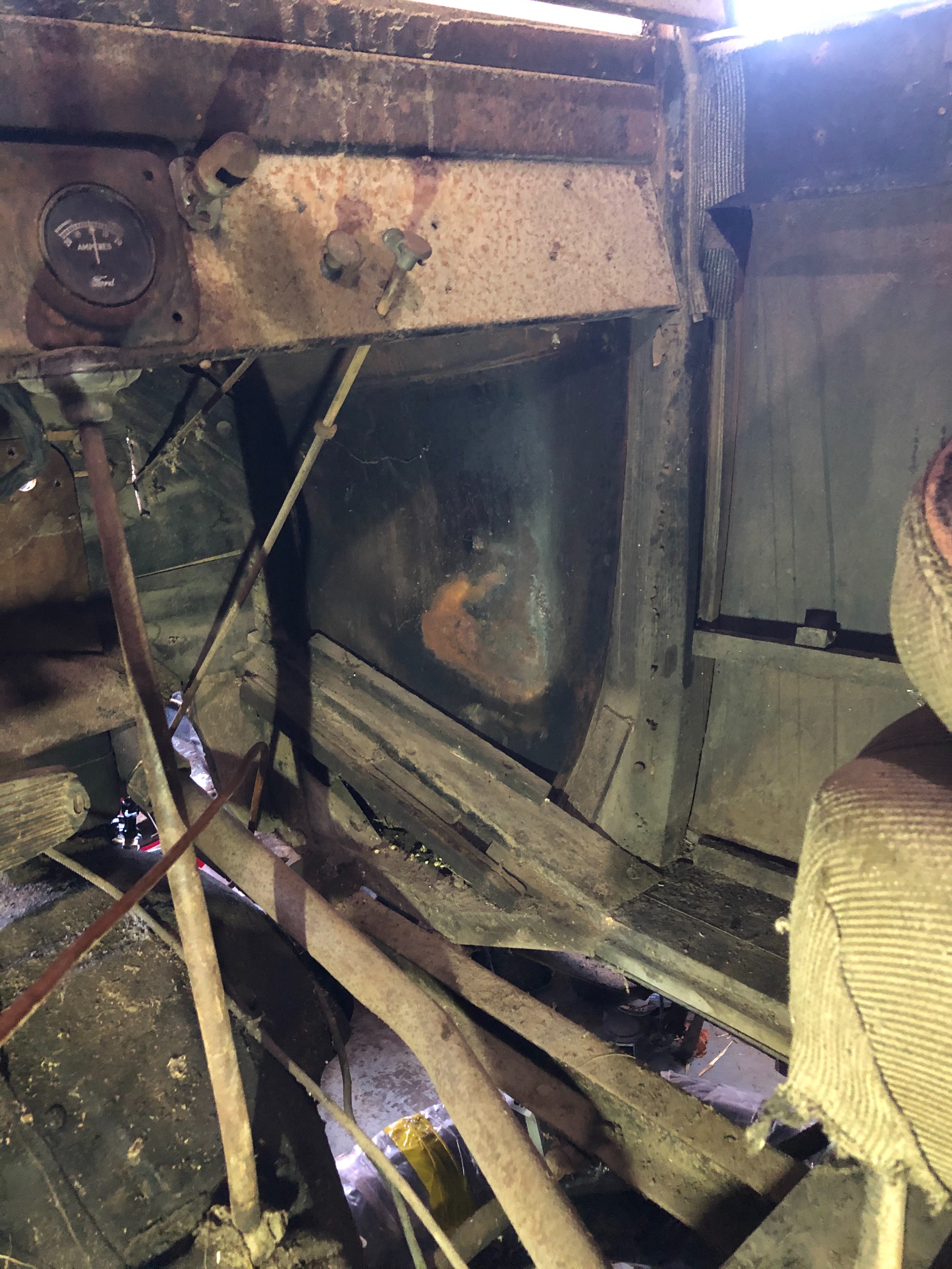

I just gutted the inside of my 21 center door.  There is an oak runner about 3/4” square along the deck,  and again up firewall
Here are pics of left and right side, with one unobstructed view of the area in question on passenger side.

Re: Question for Center Door owners
Thank you.  You have confirmed what I suspected all along.  There is nothing for the top of the kick panel to attach to.  It only attaches in three places:  Pillar, Floorboard riser assembly and the cowl frame assembly.
I also confirmed this two days ago when I assembled my original wood and replicated pieces of this area together and found the original holes and mounting nail locations.
