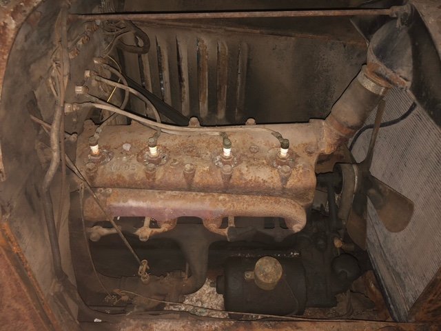

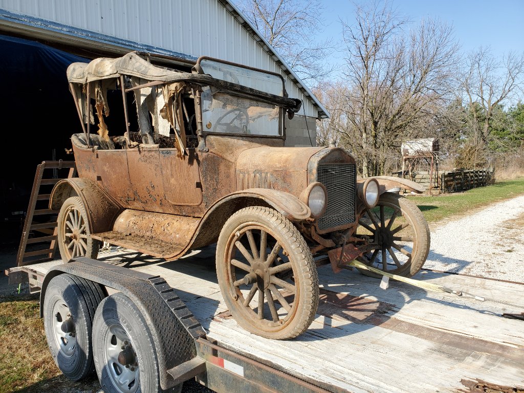

Here is a 22? Touring I looked at in a real barn on a real farm in mid Illinois yesterday. The family wants it restored for a wedding. I explained costs and gave them classified ads showing that pretty nice ones can be bought for a third of what they will spend. It was very interesting to look at as it is complete and untouched. Art

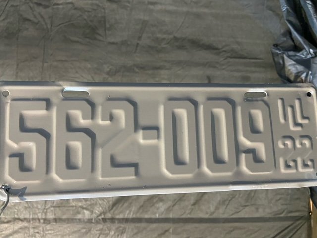

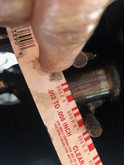

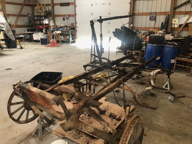

Here are some pictures from yesterday. The engine looks good except for needing a valve and ring job. All the babbit is in great shape with good clearances. The transmission looks good with no cracks in the drums and plenty of band material left. The body was rebuilt by Ray Wells and was finished and painted by a local shop. I have the top and upholstery kit from Mike at Clastique waiting to be installed. The coils and carb have all been sent out and rebuilt by RV and Russ. Art

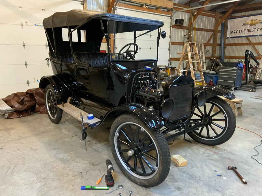

I have been working on this 22 for just less than a year and the owner is getting it Nov 2nd. His daughters wedding is November 7th. I am down to installing the hood and running boards. I am also restoring some 22 license plates for the car. I painted the entire plate black, the letter color, followed by two coats of white, the background color. Next I will lightly 600 sand the white off the raised letters and numbers exposing the black . Clear coat comes next. That makes for a real smooth finish with to edges on the letters/numbers. Art

Amazing job Art! You preserved another T. Well done!

Post by Art Ebeling » Wed Oct 27, 2021 10:05 pm
Finished, Thank you to a lot of you guys for your help and advice. Art

Art,
You have done a wonderful service for this bride and the future generations of the family. It would be nice to see some photos of the wedding with the T.
Thank you for sharing,
Dom
