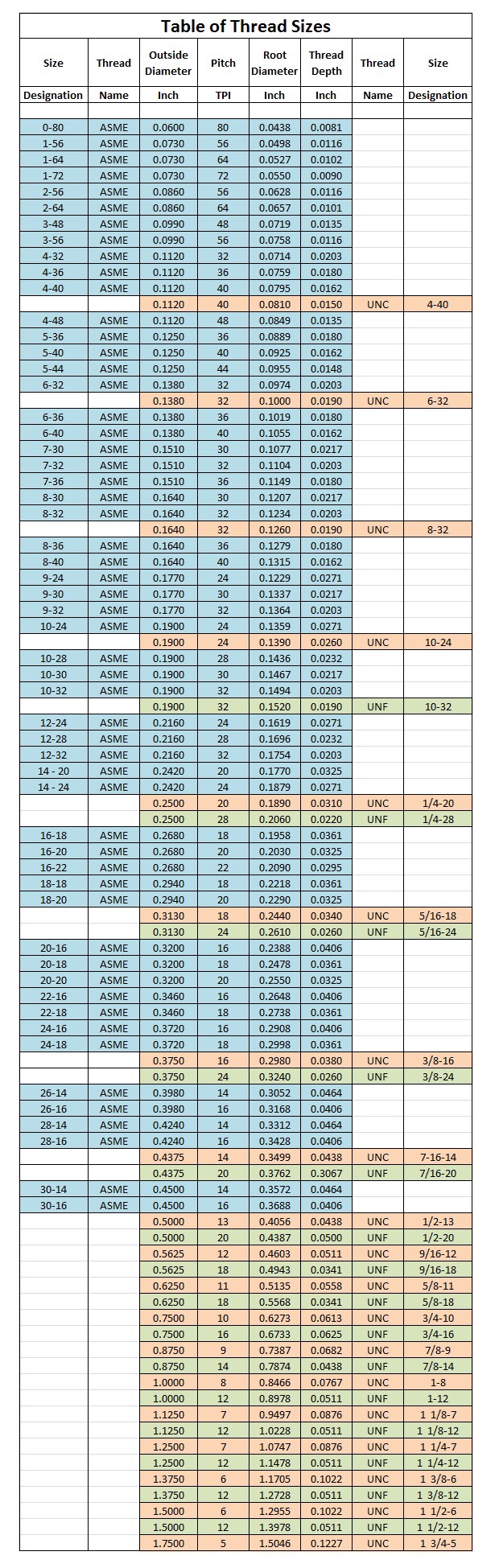

I do have this chart which shows all dimensions of nuts used on a T
So you helped me to order the correct sizes in UNF.

The above chart showing the chassis is the SOCKET size used...the thread itself will be different.

BUT (sorry, I am beginning to feel very slow on the uptake): the part below shall be 7/16 but I could not bring a 1/2 inch (8/16) wrench on it (too tight) and had to use a metric wrench with 13 mm opening (which should be someting like 8.2/16).
The nut size in inch should name the opening of the wrench, shouldn't it ???
5/16 nut = 5/16 wrench, 1/2 nut = 1/2 wrench etc. --- and this is meant to be the socket ???

That chart shows what wrench size you need for each nut and bolt, not the thread sizes.
Stephen
Stephen

Thanks Stephen - that does confirm to myself that I am not totally 'NUTS'
