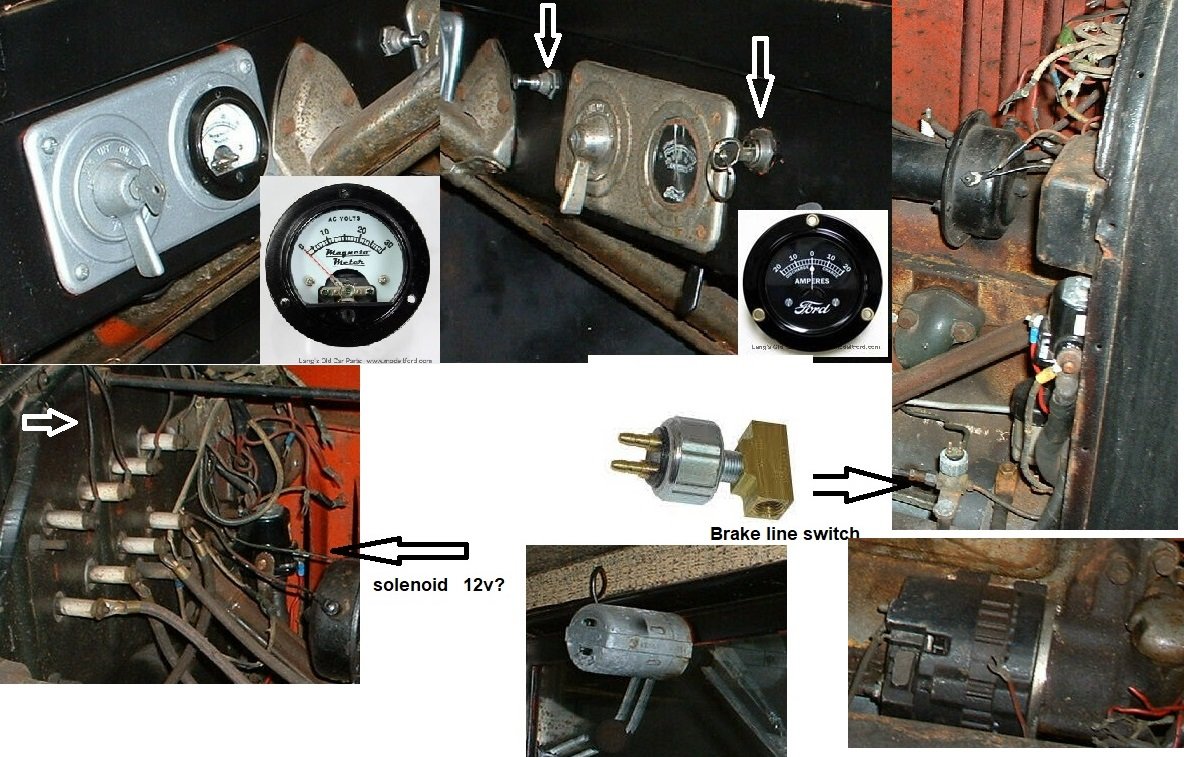

Wonder why the 2 sets of switch/ammeter plates? Looks like a disconnected oil pressure switch on one side, and a disconnected heater on the other...

Was wondering about the two switch plates too. There are several wiring modifications, modern starter solenoid think is 12volt has 2 ears, extra starter switch on dash, electric wiper motor, brake line switch and alternator. There are also some black wires going to the upper row of the coil unit connections plus many loose connections. It appears that one switch plate, with the key has a Magneto meter in it while the key-less one has an ammeter.
Previous owner an electrical engineer and set it up for dual voltage; magneto and 12 volts. :roll:

Had to have some kind of water pump to feed it - I'm guessing that's where the cabin heater was fed from, and returned to that fitting on the top of the head. Otherwise you would get no water flow unless it was out on the ground.
All the electricals make me wonder what this person was doing - I suspect there was more afoot with this car in it's past and some of the goodies that were once on it were changed out.
All in all, it IS quite the fun puzzle to work out!

I'm guessing that the water outlet at the top of the head was the heater inlet and the return went to the bottom of the radiator there's no reason why convection wouldn't feed the heater. It looks like a nice little car, but there is a lot of stuff that I would want to undo. JMO.

"Previous owner an electrical engineer and set it up for dual voltage; magneto and 12 volts."
Two totally separate electrical systems, then. Guess that makes sense.... You know those electrical engineered! LOL!!
