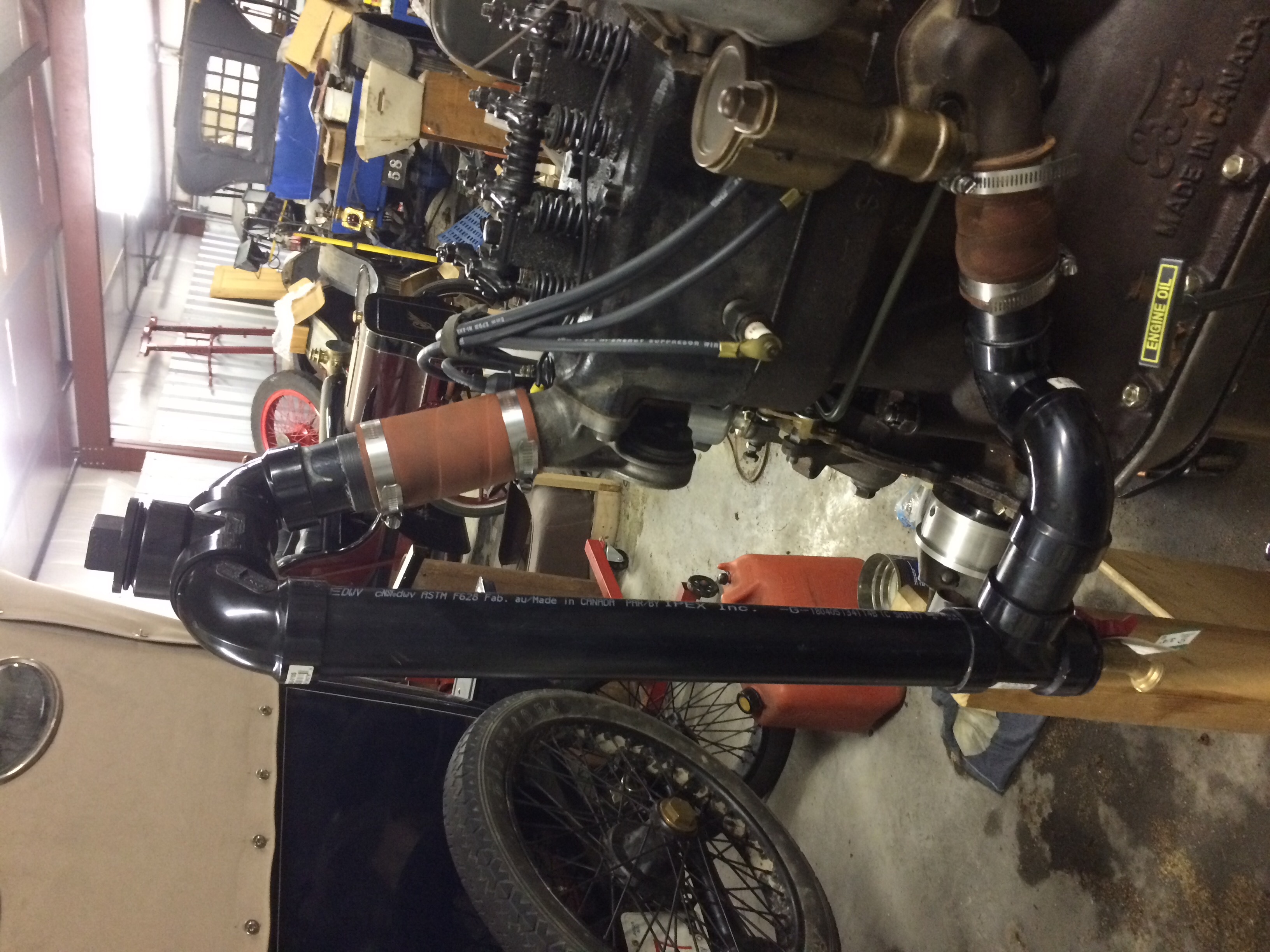

Here is my solution!!
Fill it up and still lots of access. About $10.00 worth of plumbing fittings!!
